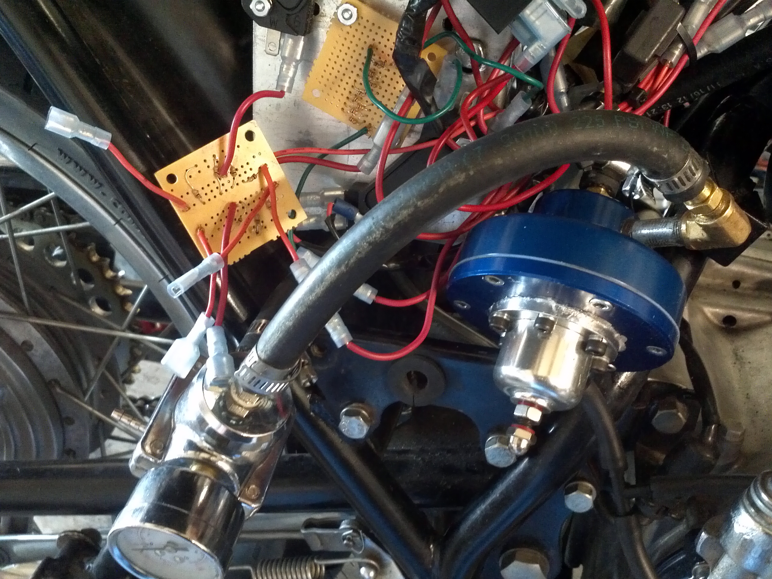

But before that I dug out the modified fmu ( fuel management unit ) from
before. With it I gain about 10 p.s.I. when the throttle is pinned. I still use the
other pressure regulator to hold a base line fuel pressure. Without it the
pressure will drop to about 0 when the throttle is chopped causing the bike
to sometimes to stall. I also replaced the counter weight I cut up and the
heavier spring with stock pieces, thus speeding up the advance on ignition
and fuel curve. These all made some difference but what made the most was
adding 2 10k resistors to the top igntion module. Now the throttle can be
manipulated easily between 3k & 4k. I will need to take it for a spin tomorrow
to be sure.

Took it for a test ride and realized more fuel was needed because
it wouldn't pull past 5k in 1st and 4k in second. Went back and turned
up the fuel pressure by 5 lbs., it ran better with more r.p.m.. Put it
back on the lift and stared raising fuel pressure. Ending up being rich
at idle. Leading to the next step. Using a wide band o2 sensor hooked
to a pulse width modulator to control the fuel pump.

The wide band o2 sensor and pulse width modulator didn't live up to expectations.
The voltage signal out from the o2 sensor was not enough to run the pump past 20
p.s.i.. I am going to pull the fuel injection stuff off until I can save enough pennies to buy a
used oscilloscope, probably a Fluke series 90. That way I can see exactly when the
injectors are firing and for how long corresponding to cam and ignition timing. I will also
be going thru the top end with Wiseco KZ750 pistons and some work on the cam.

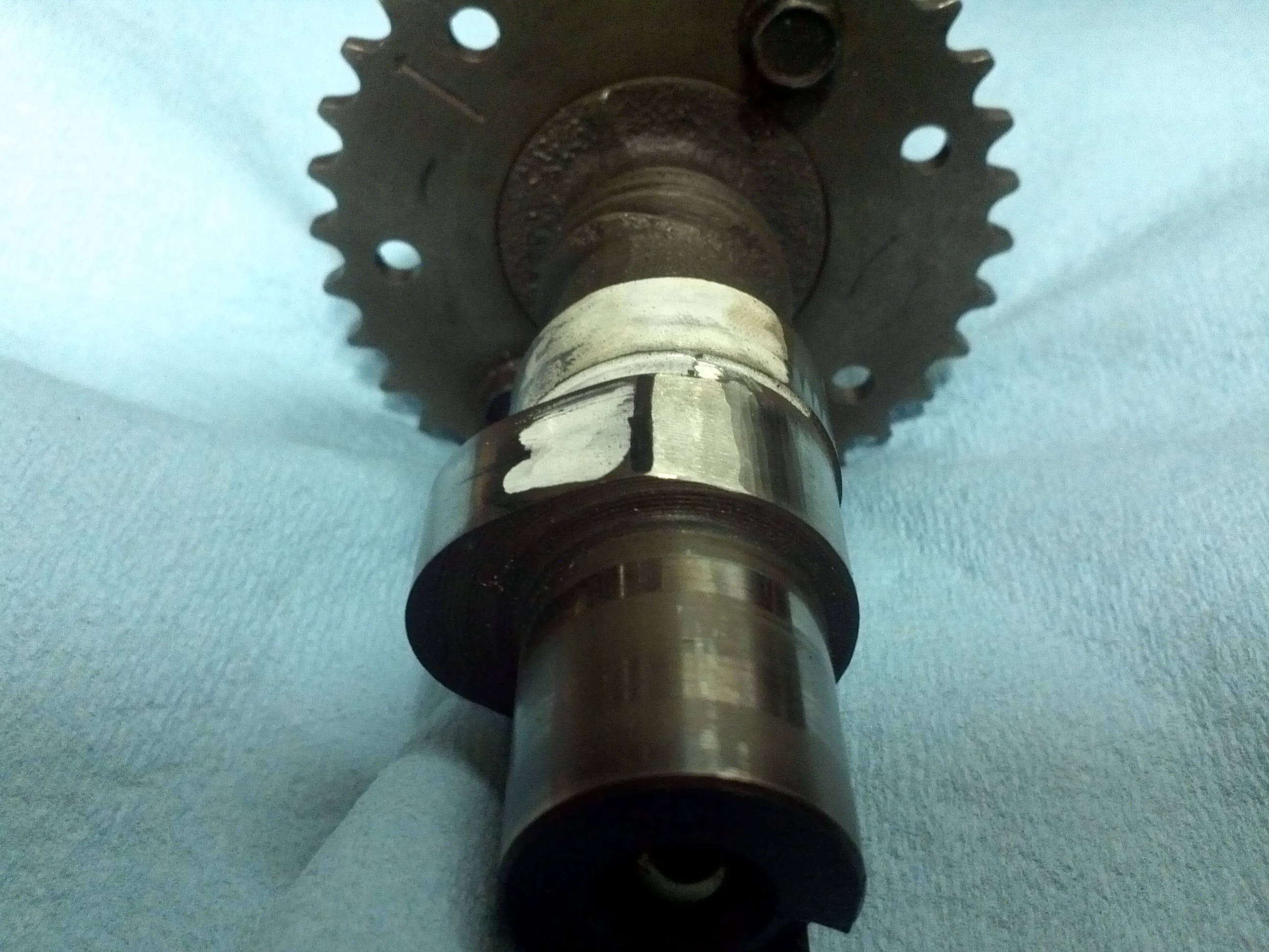

Also started on grinding down the intake base circle on the
cam for this engine. That was until I about burned up the bearings.
I filled up the oil cup several times but the shaft must have
been totally dry. Disassembled the shaft and still need to clean
it up so I can finish roughing in the base circle. Then I can
dress it with a die grinder. After that it will be check by degreeing
it in the engine after the the big bore pistons and milled head
are installed. When I'm satisfied with the results I'll polish it up
with some emery cloth. The factory retarded the intake timing
several degrees compaired to other engines. If I was
going to change that, might as well advance it a few more.
Add a few more degrees of duration and .040" of cam lift. Below

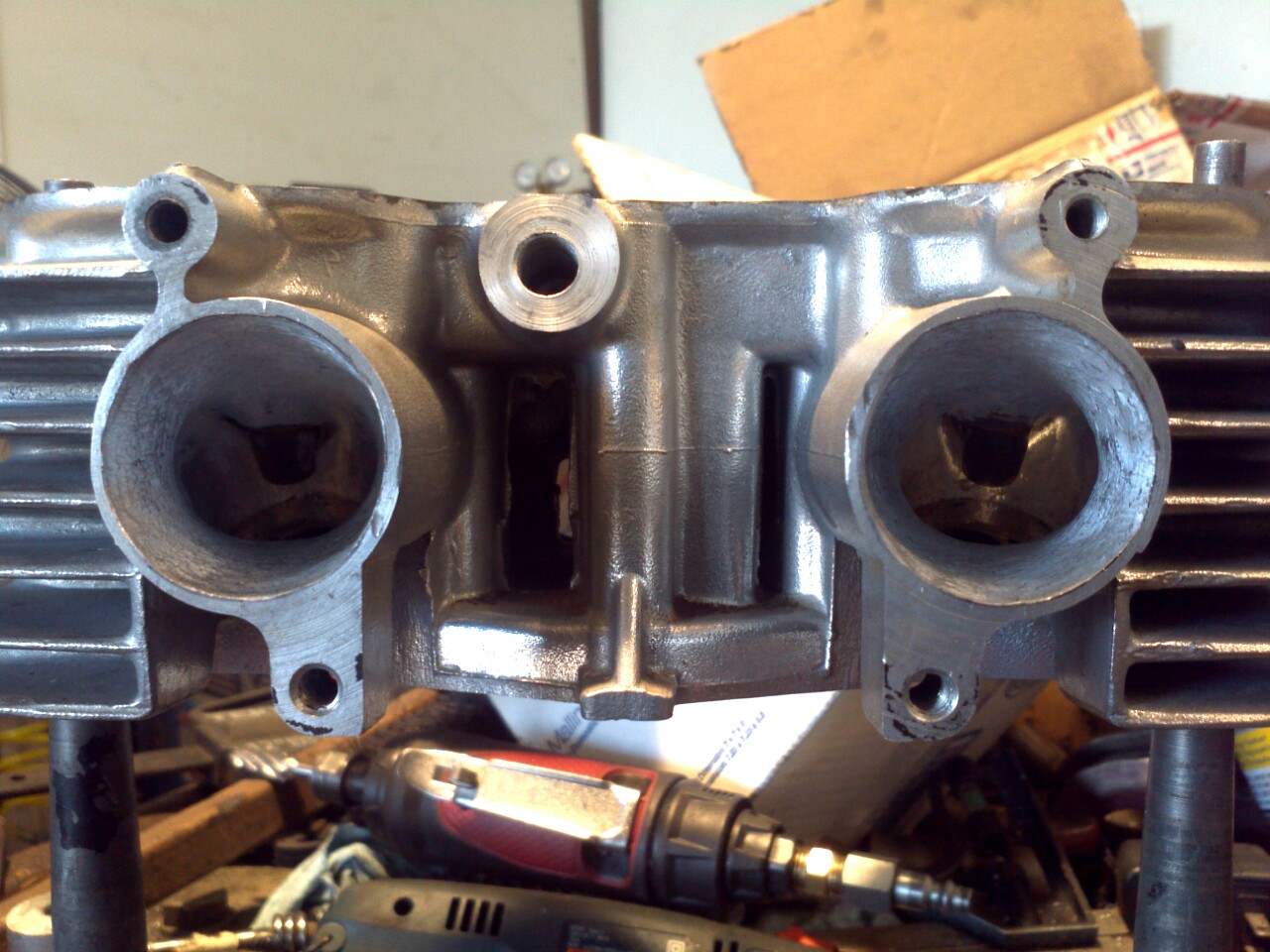

The bearings for my tool post grinder won't be here till Monday.
So I did a little porting.

Done grinding the cam for now. It just needs to be cleaned up to be
checked with a degree wheel. Also did my valves. This method is a
little more accurate than my old Sioux valve grinder. That thing is out
of round about .002 for .004 total. Good enough for old pushrod V8s,
but not small engines. Next is to lap the valves, since the seats are in
great shape. Then I can tear down the top end and install the other
block and Wiseco pistons. And see what the new lobe profile looks like.

Cam timing turned out to be
43/73, 296 dur., 105 c.l., 350 lift intake, vs. 27/73 stock
63/39, 282 dur., 102 c.l., 308 lift exhaust. vs. 70/30 stock
I still need to open up the slots on the cam gear so I can advance
the timing some more. That way the exhaust will be at 110° c.l.
like the stock setting. And the intake will be at 51/65, 97 c.l..
Which is 21° more overlap, 16° more dur., and the valve closing
5° sooner. Resulting in more cylinder pressure and better breathing
because of valve events and a 10.3/1 compression ratio.
It was time consuming to get equal cam profiles by hand. I only used
a die grinder a couple of times. Otherwise it was a file and emery cloth.
Typical procedure was to remove the rocker box, cam caps, chain, cam.
Remove some metal and reinstall everything. The check the degree
wheel pointer for t.d.c., then valve lash and set up the dial indicator.
