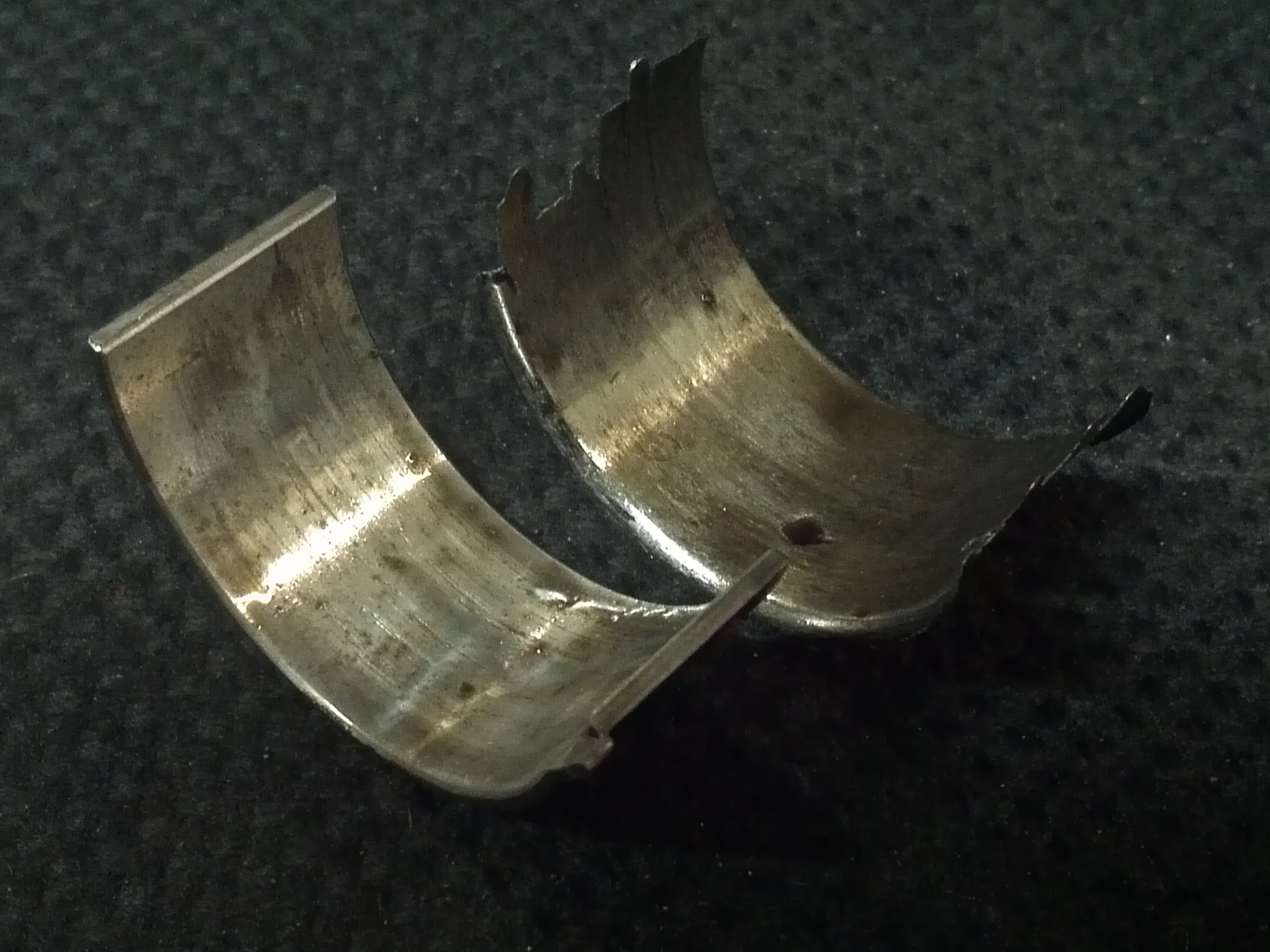

Bad part about it is that the engine had a knock. So this is a reminder that you need to check
and change your oil regularly. Because they do not make some parts for these old bikes
anymore.

On the left is one of the rod bearings for the right side cylinder. On the right
is the left side bearing. The big end of the rod and the crank were both worn
down by about .005 in.. and the exhaust valve hit the piston.

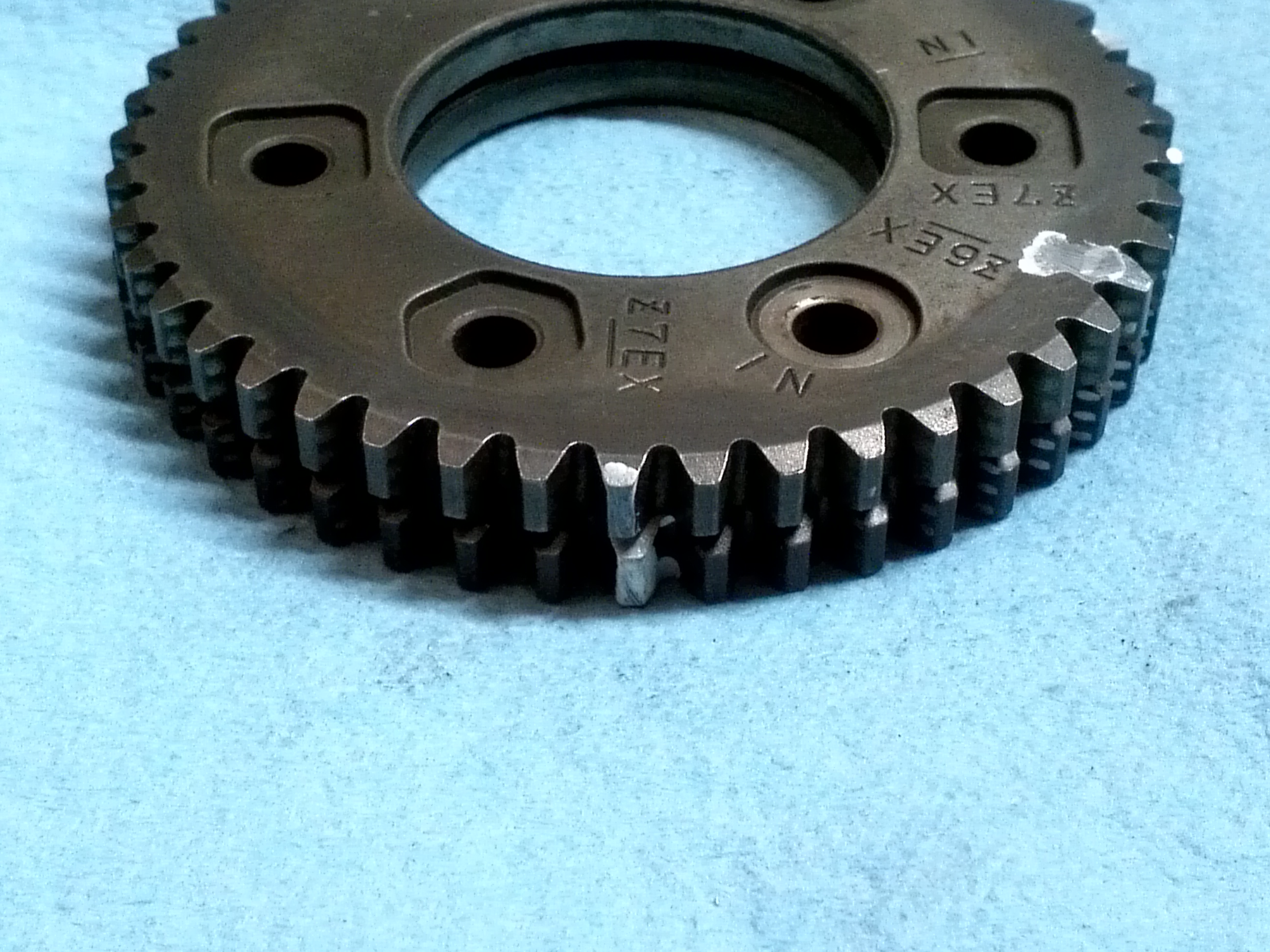

Just to let everyone know I haven't abandoned my projects. I've just been sidetracked lately.
Along with the KZ440 LTD bobber engine rebuild etc... . My cousin asked if I would look at his
sons mini sprint engine. They only got three races on their ' race preped ' r6 Yamaha. I was told
it never seemed to run right. Which turned out to be the titanium valve were shot and out of
adjustment. But on the third night out it started a nocking/squealing noise I was told. And this
is what I found, a broken tooth on the crank gear that drive the clutch basket. Looks like something
got caught between the teeth.

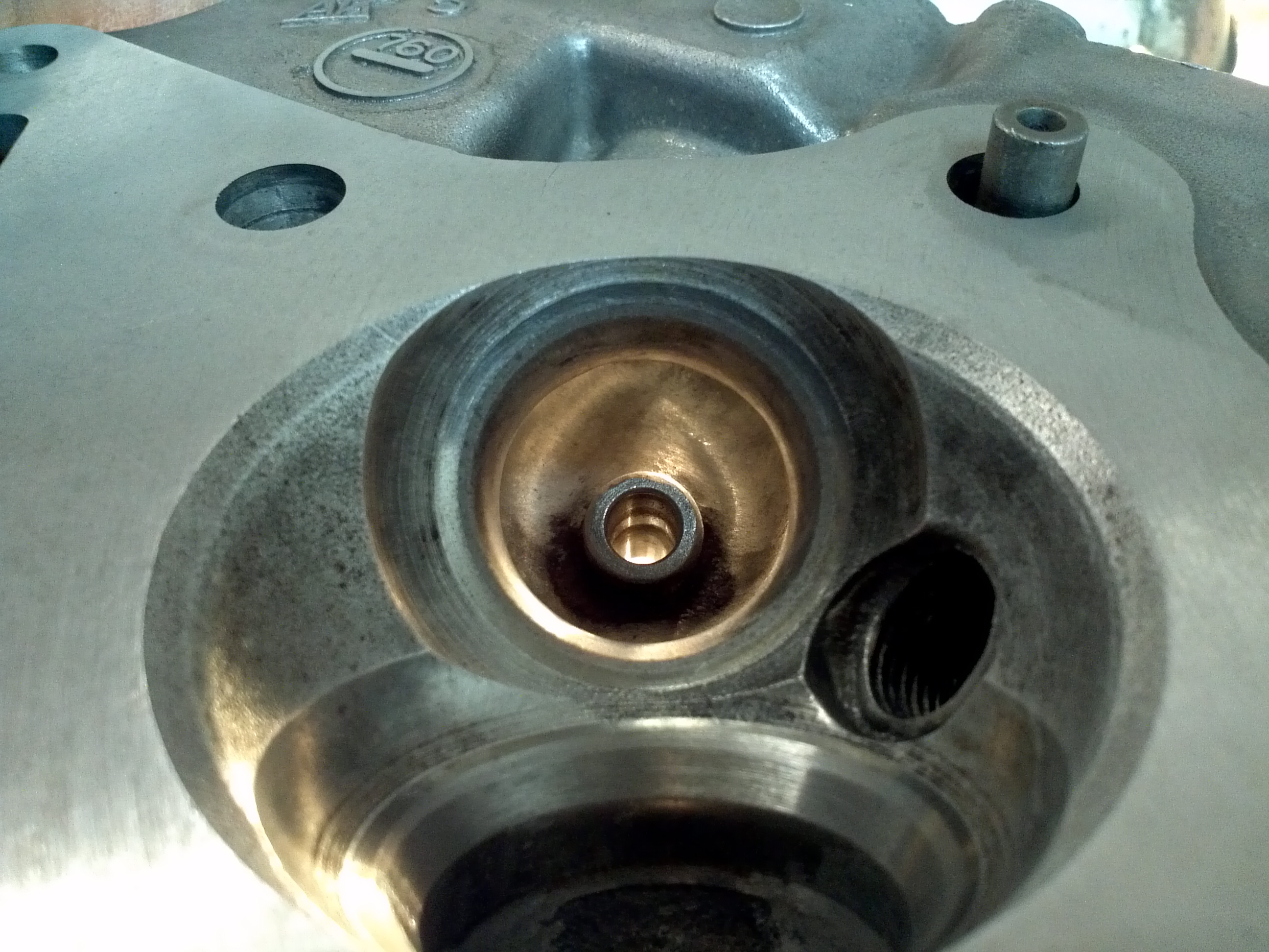

Pics of the head for that bobber.
The exhaust port.

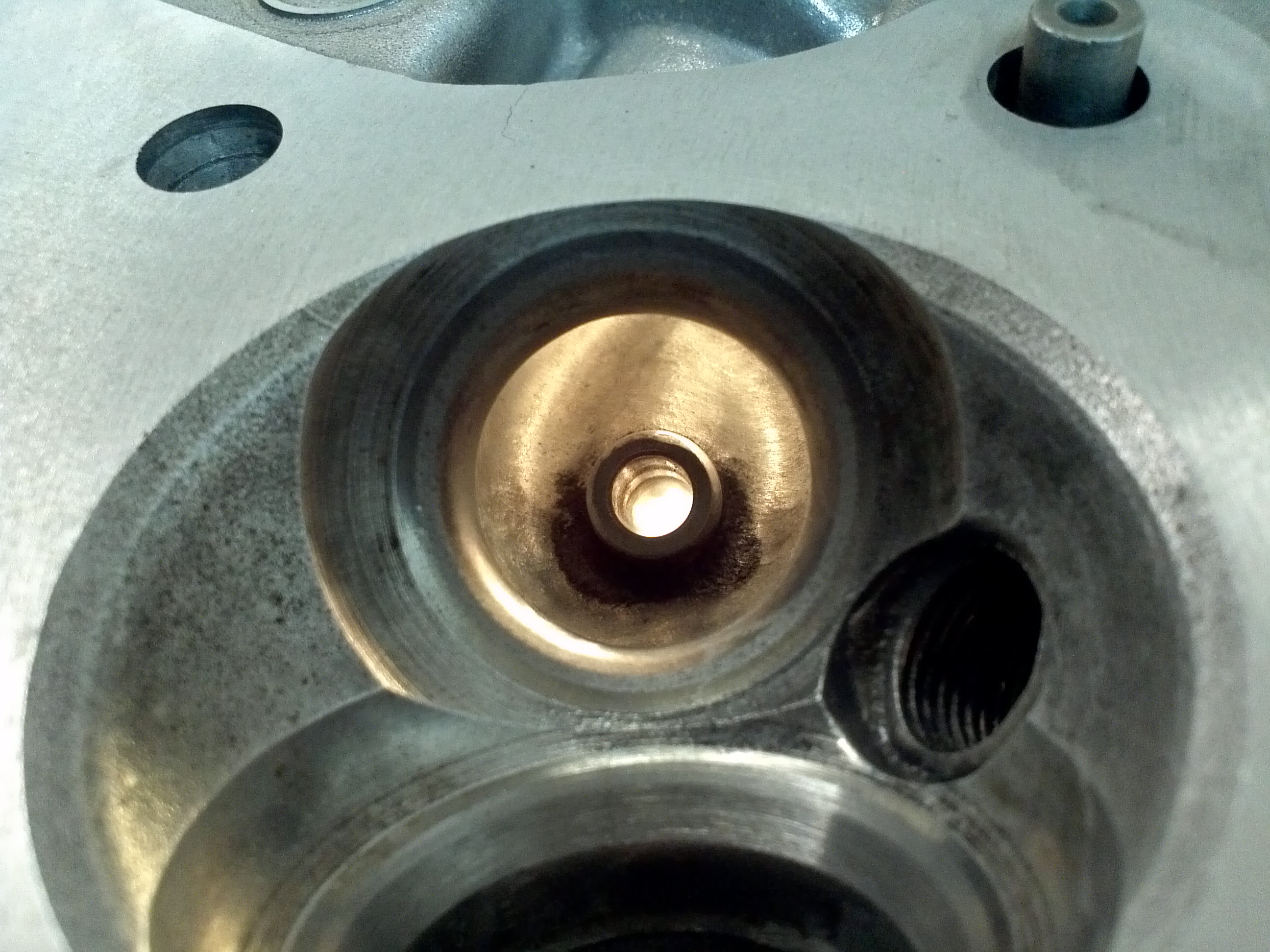

And the intake port.
If you look at the first pic. On the valve seat from the 12 o'clock to 2 o'clock
position is some serious pitting. I had to break out the old Sioux valve seat grinder
to remove the pitting on the 45° cut. I usually get by with just grinding the valves
lapping the seats, but not this time. Then I narrowed the seat down by cutting the
bottom 60° cut.

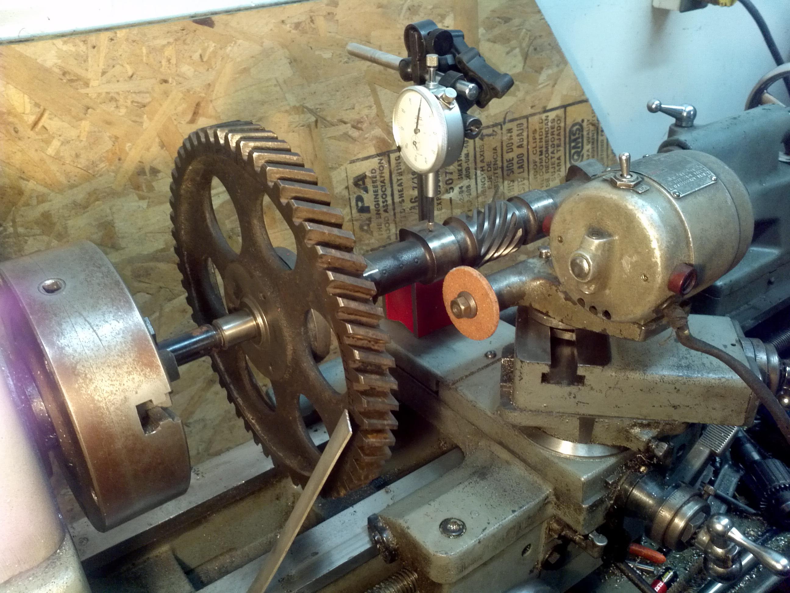

The bobber is done, owner is picking it up this weekend. Besides the engine
I rebuilt the forks, installed the new chain and sprockets and fabricated a brake
stay bar. The 'builder of this machine' just bolted it to the frame, not allowing
for chain adjustment. Also started regrinding a cam today. It's not a KZ but
the factory color is also green.

that's a neat process, do you plan on any post grinding heat treatment? I've heard the chill hardening on cast iron isn't all that deep
