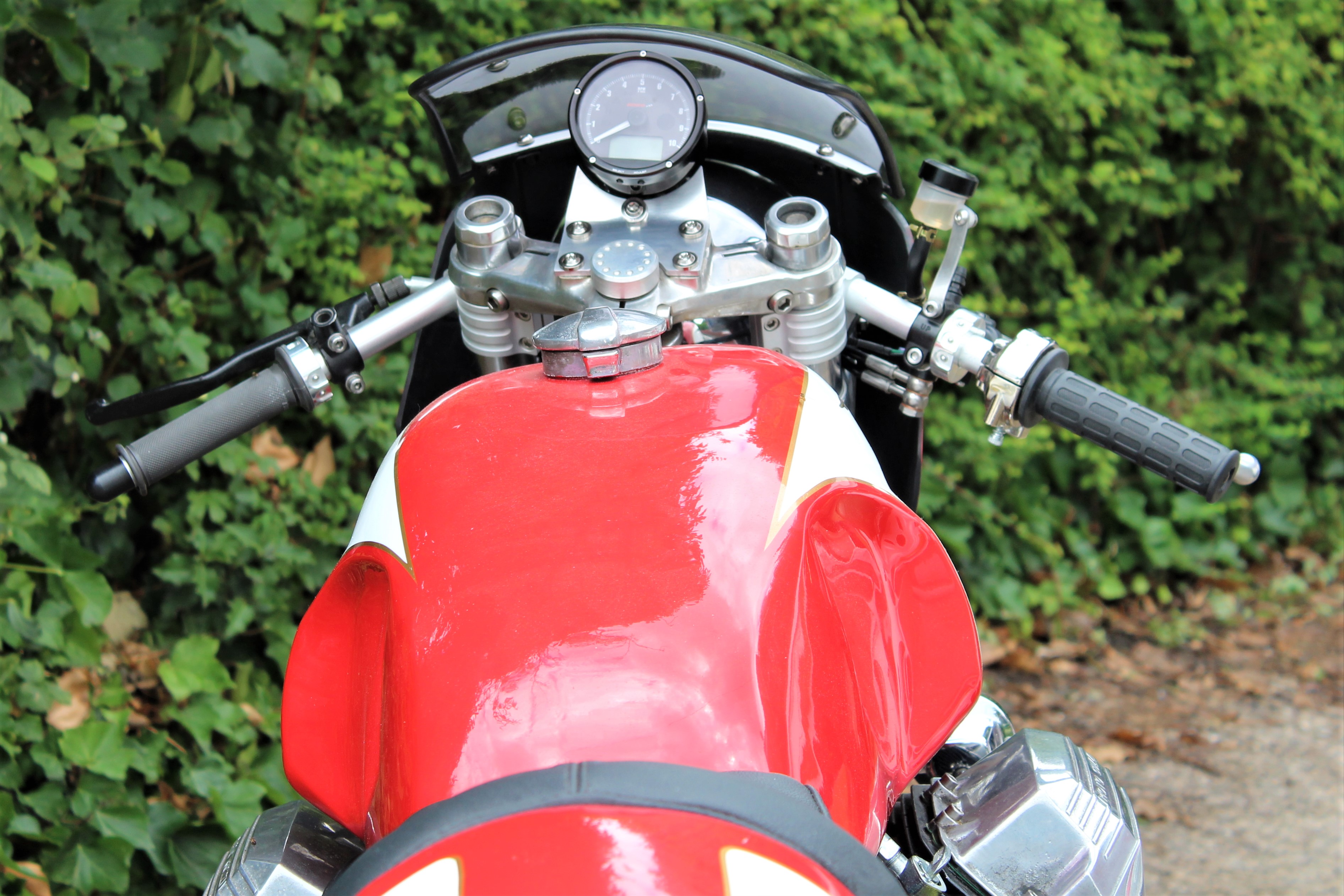

After a long wait, finally got the seat back from the upholsterer, he followed by instructions and did a great job, but sadly I wasn't as clear as I should have been, so the seat front doesn't fit against the tank as it should, and its too squared off at the front. So it'll have to be redone at some point.. on a better note the other seat he did for me for another project was perfect. I'll wait until I can take the bike to the upholsterer so it will be clear what I want.. One step forward, two steps back..

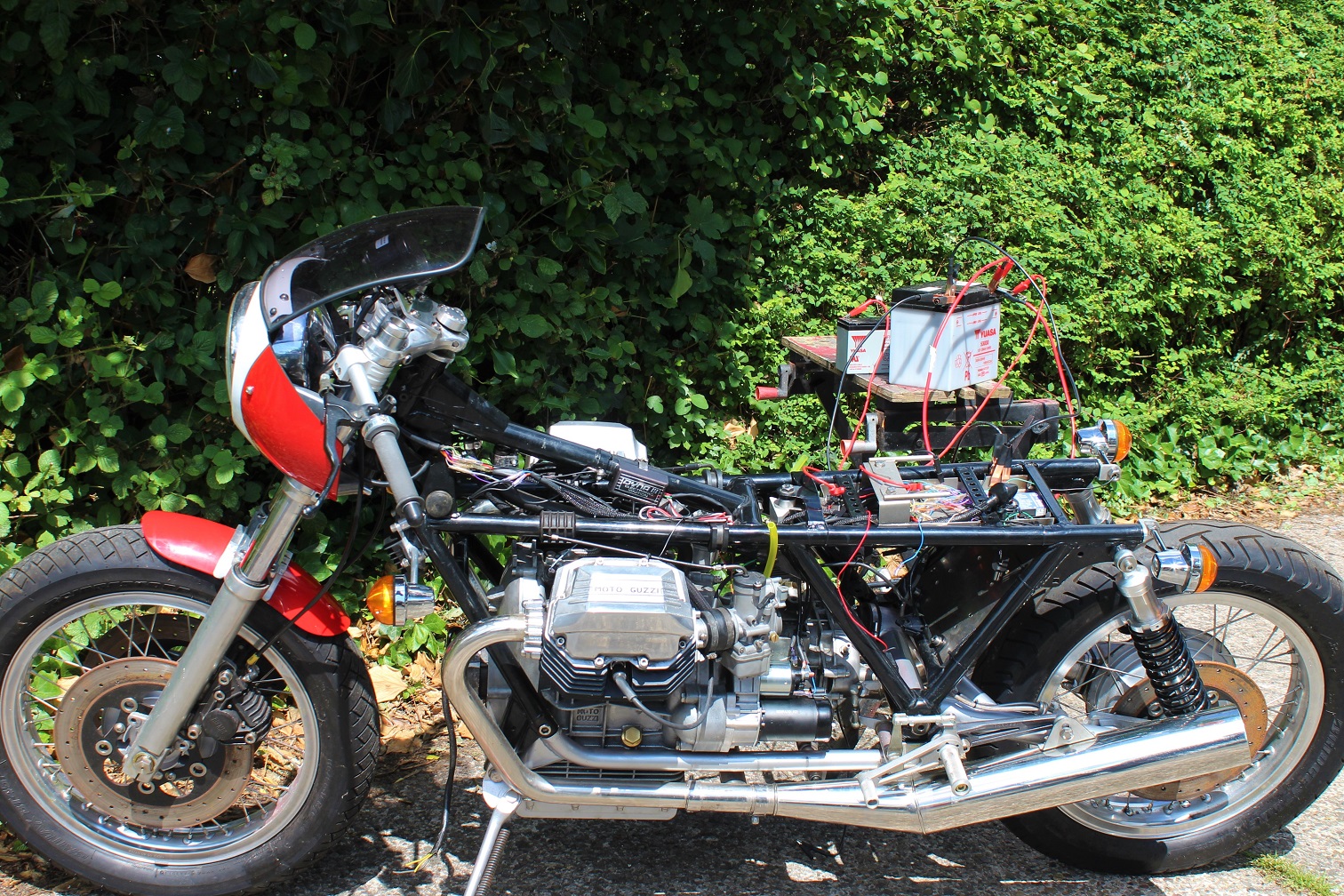

Finally got time and space to work on the Guzzi again. Got the seat reupholstered couple of months ago, but only now have I fitted to the bike. The seat unit mounts will need a bit more work, hence its held up at the back by a block of wood in the pic. Next few days will hopefully complete the wiring, using a Moto Gadget M-unit. Then will try to start the engine for the first time in a decade..

In this pic the seat isnt mounted correctly, hence its slightly tipped up at the back..

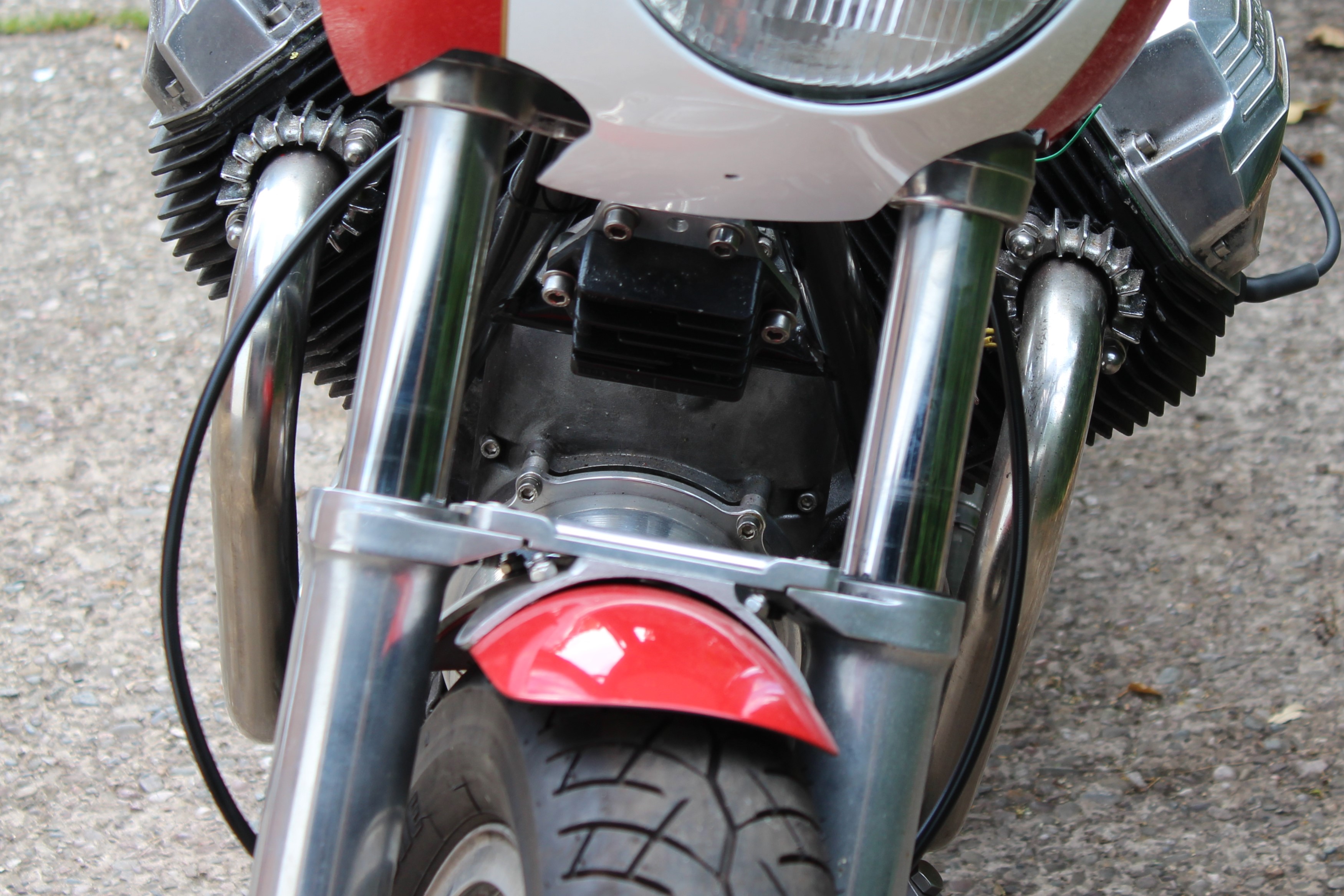

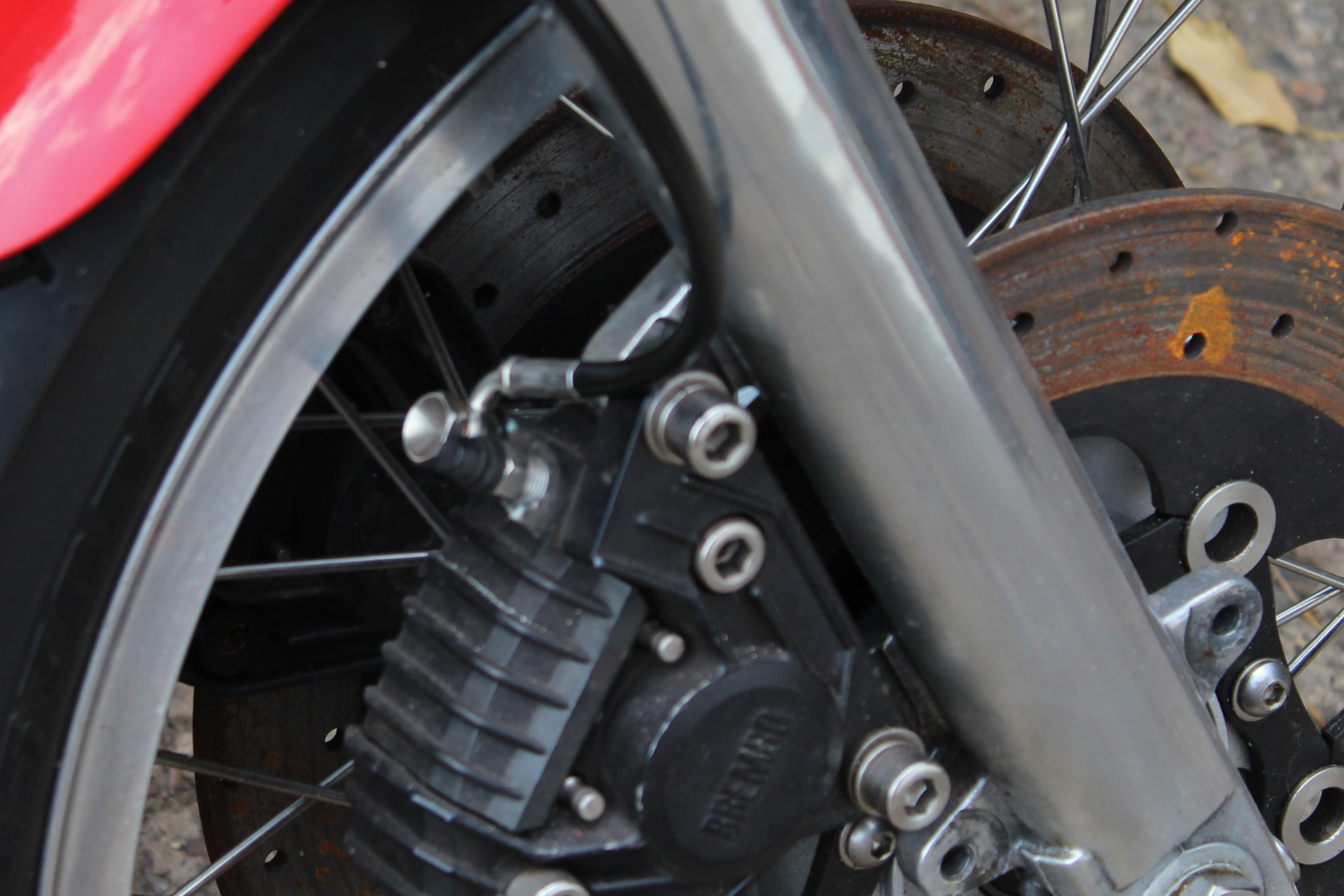

Also fitted a Lemans Mk1 fairing, which meant the original brake lines had to go, along with the front indicators which were bolted to the headlight brackets.
Made an error when ordering the new brake lines, as the Banjo bolts at the calipers bend 90 degrees in the wrong direction. Had to order a second set to fix the problem

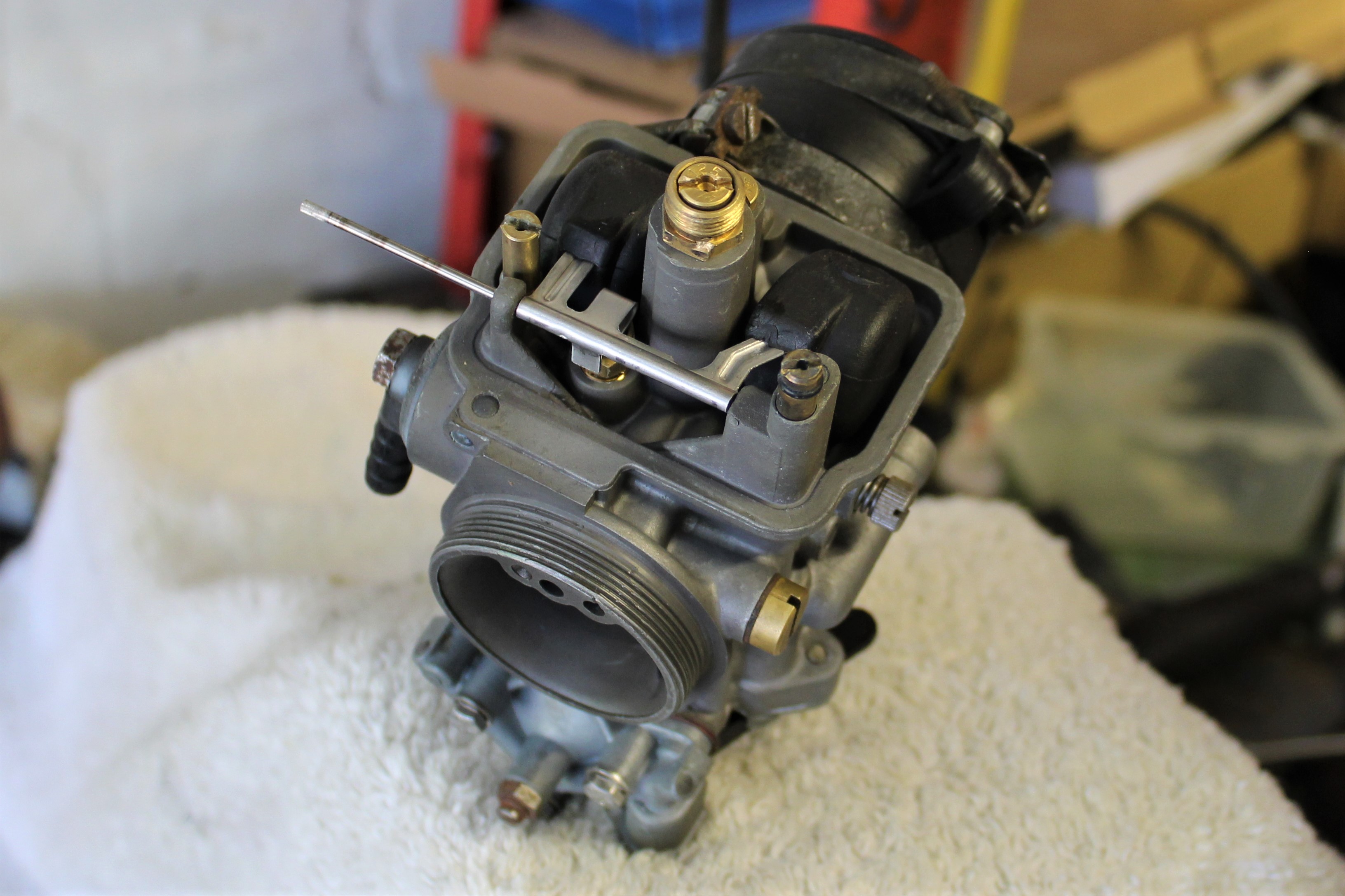

Two new float valves and seats arrived, fitted them to the carbs, and fitted the carbs to the bike.. surprisingly the engine fired up immediately. The first time in more than ten years since I've owned the bike. Bit of smoke from the exhaust at first, probably from the oil I poured down the bores years ago.

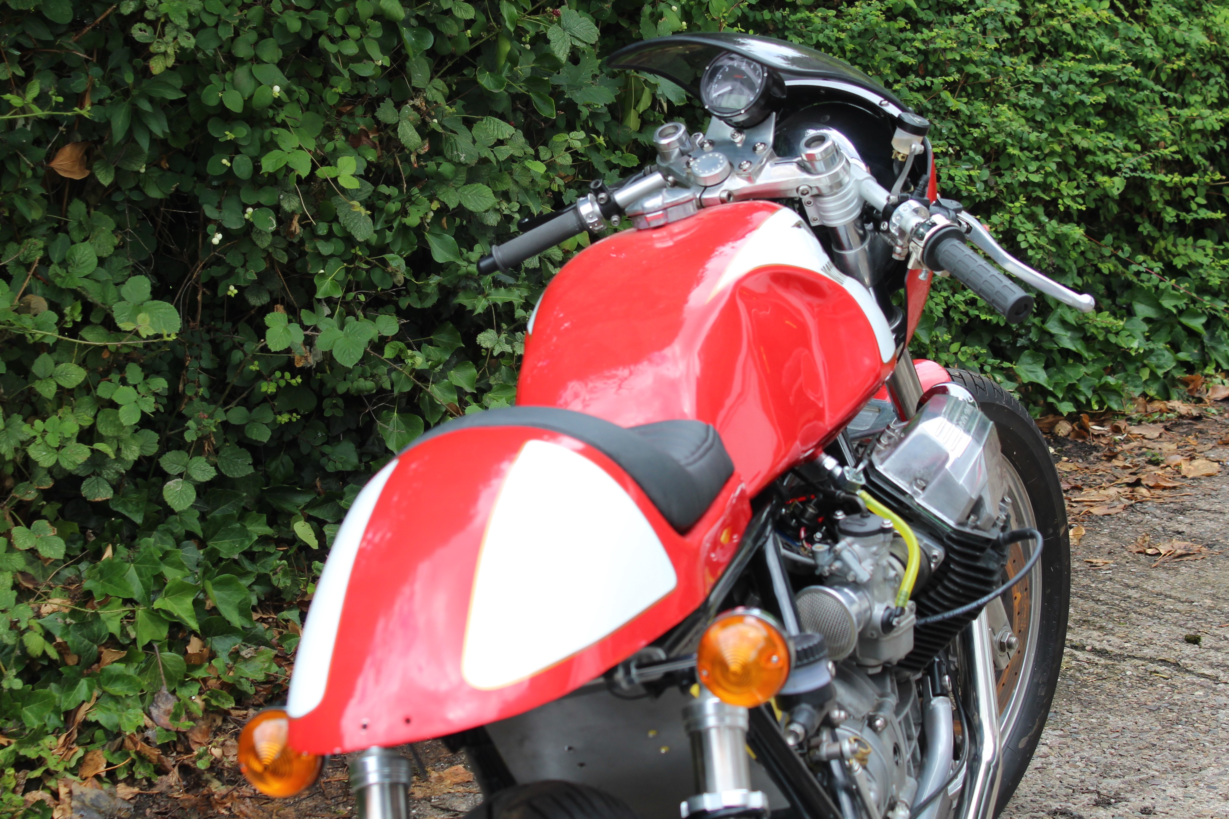

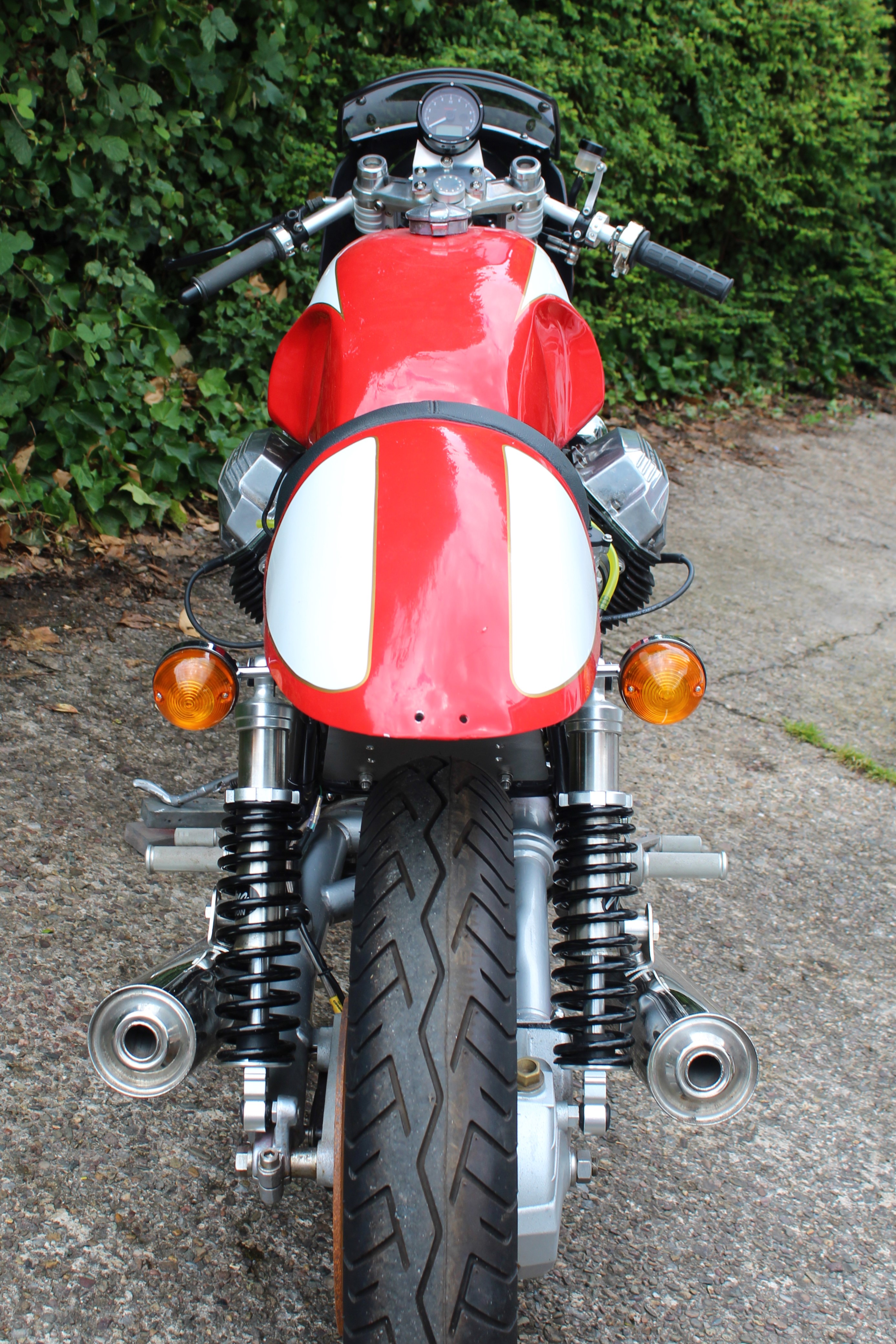

Just a few more small jobs to complete, and its done..
