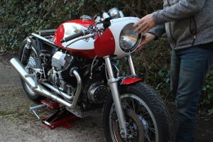

The fairing screen arrived, went for a tinted version rather than clear. Now need to work out the best way of mounting it...
Been working on the mounts for the new seat unit, can finally see how it looks with the fairing and seat unit in place...

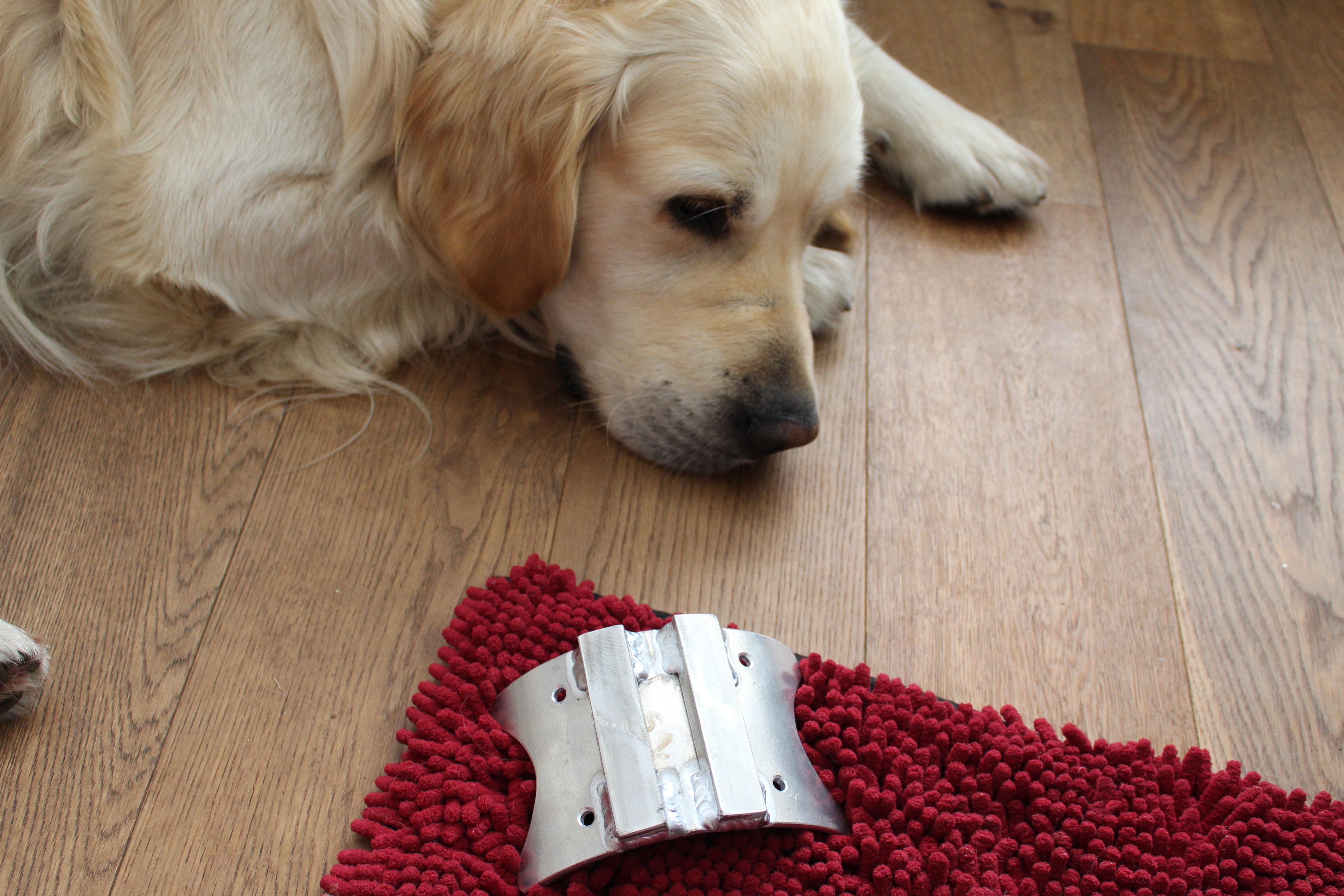

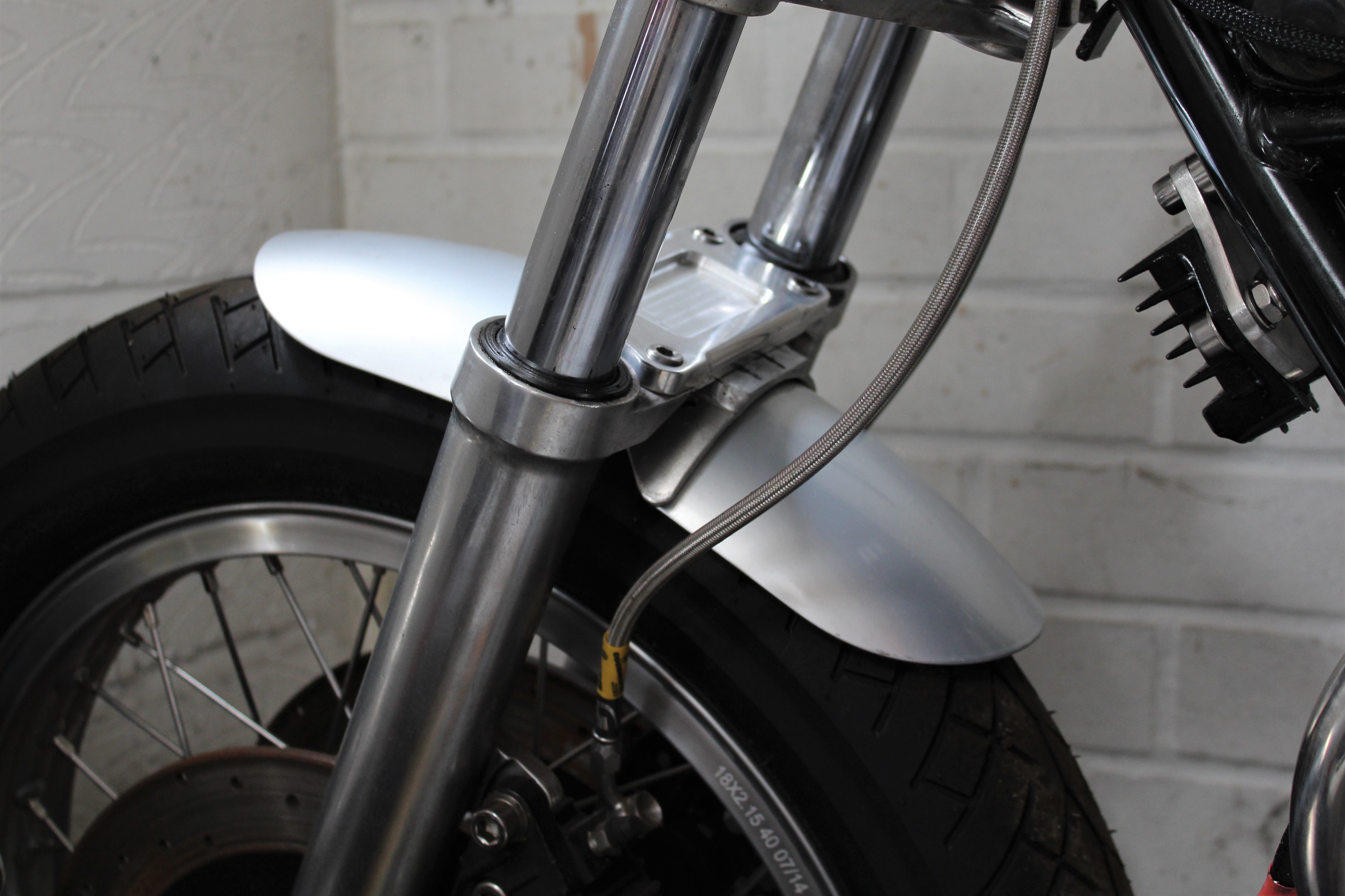

I bought an aftermarket front guard made to fit a Triumph T100, as it looked like it would work with the Guzzi 18 inch wheel. Sure enough it did, however it had four mounting holes pre drilled, which were a few mm wider than the fork brace I had to mount it too. After much head scratching, I had a 3mm alloy plate rolled to match the curve of the guard, then shaped and drilled it to match the guard nicely. That done, I had a couple of alloy strips welded to its top.. these will have their tops milled flat, then a couple of countersunk bolts can be used from the underside to bolt this bracket to the fork brace. Well, that's the plan anyway. It doesn't look good yet, but once the welds have been cleaned up and the whole lot polished, it should hopefully look ok.
Though the dog wasn't too impressed..
With the mount machined and drilled, I could see how it looked on the bike at last, though it still needs a bit more work to clean it up and give it a good polish...
I have found that dogs are rarely impressed with well engineered solutions to mechanical problems. I don't bother sharing this kind of cool stuff with my dog or my wife.

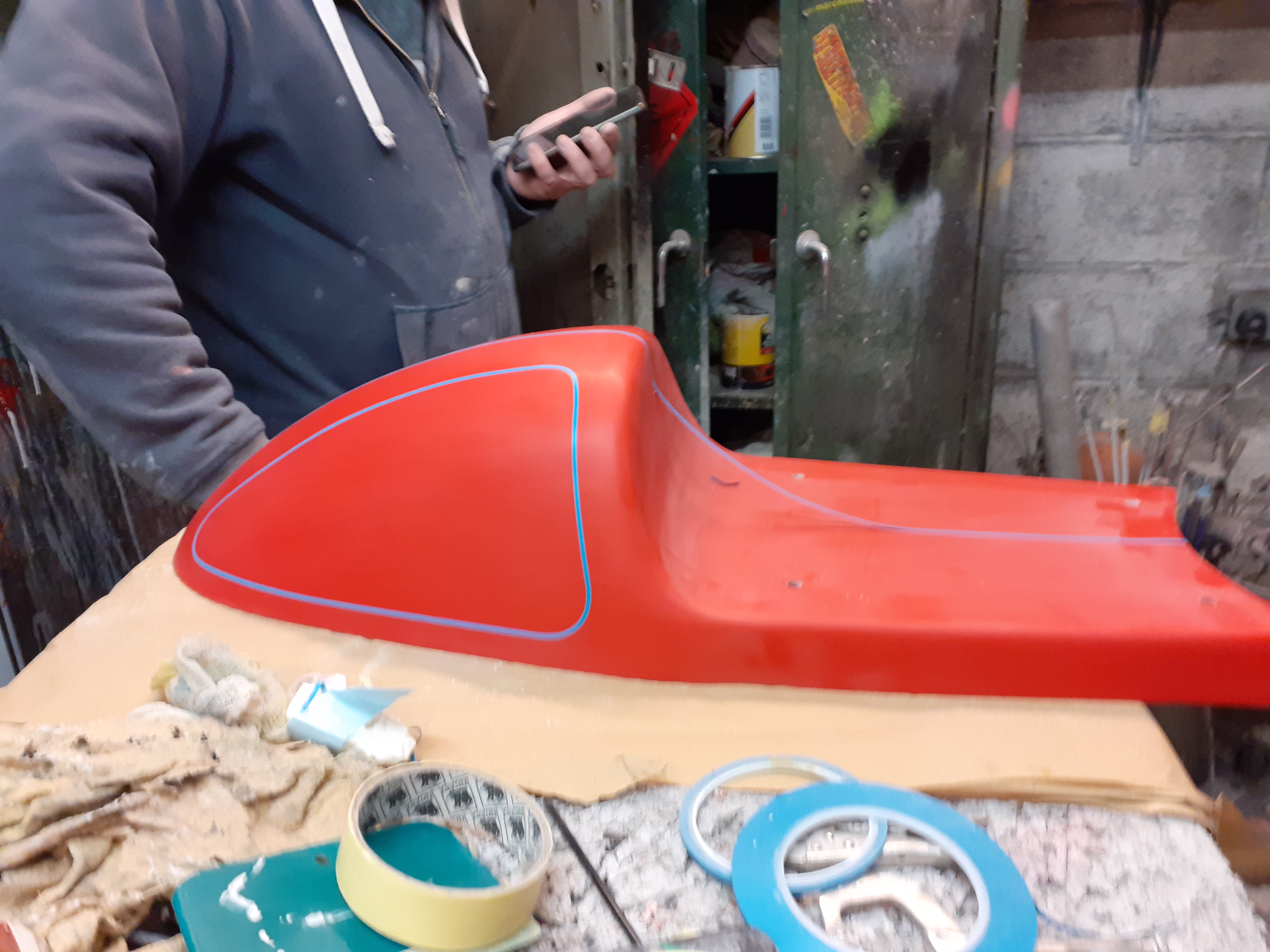

Meanwhile, I've been playing around with pinstriping tape, trying out different designs for the paintjob. Current idea (no doubt it'll change), is to have bright red with white panels, as seen in the pic below..
After a long wait, the bodywork is finally being painted. The base colour is done (Honda Victory Red), while I've made some small changes to my original design. In the pics you can see the painter laying out the outline for the white panels. Took a few attempts before I was happy. The paint should be ready for collection end of next week.

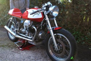

Quick test fit of the tank and seat to see how they look. Haven't fitted the set mounts yet, or those for the cockpit fairing, as need to finish the wiring first, so they don't fit quite right in the pics below...
