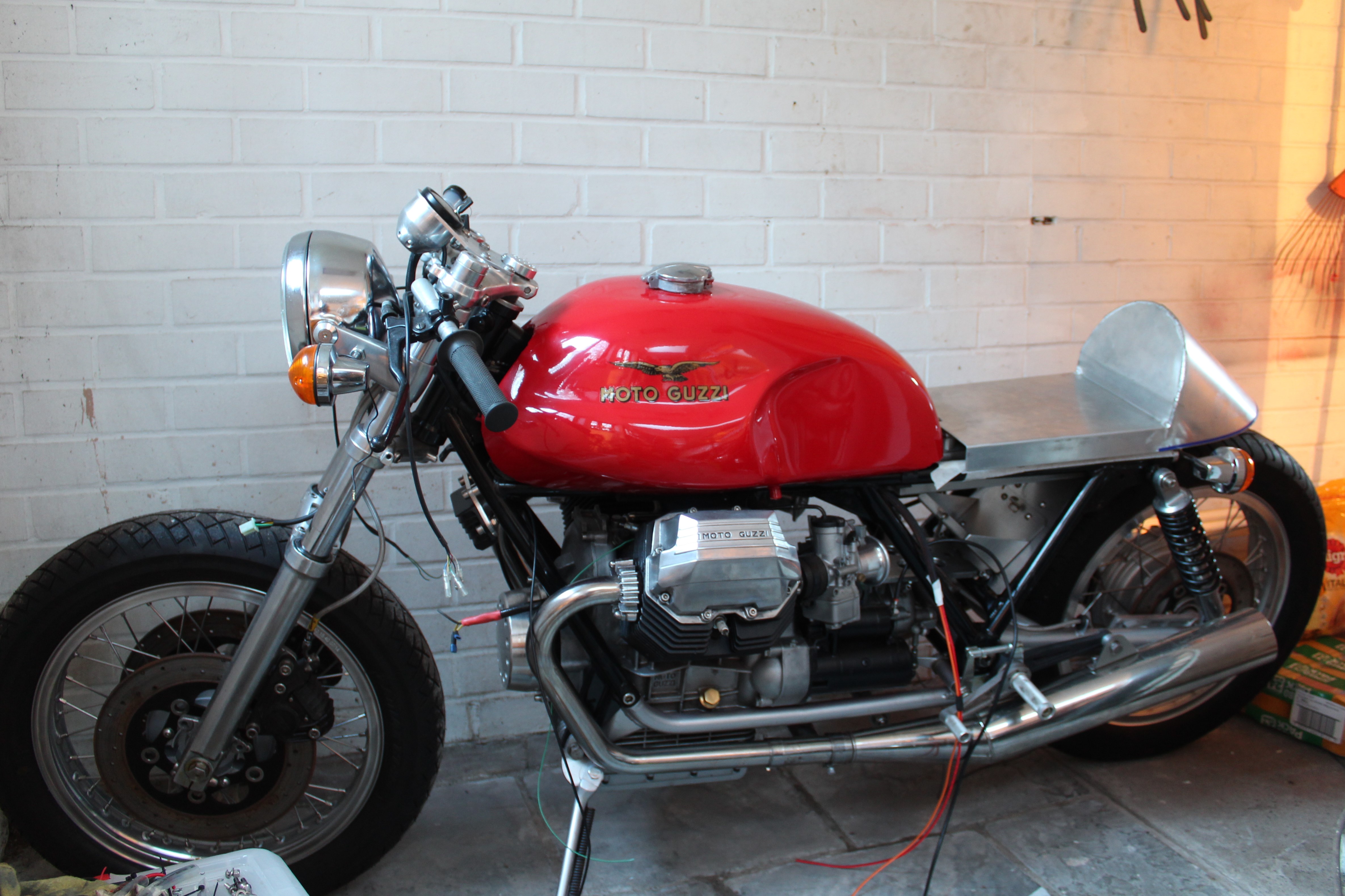

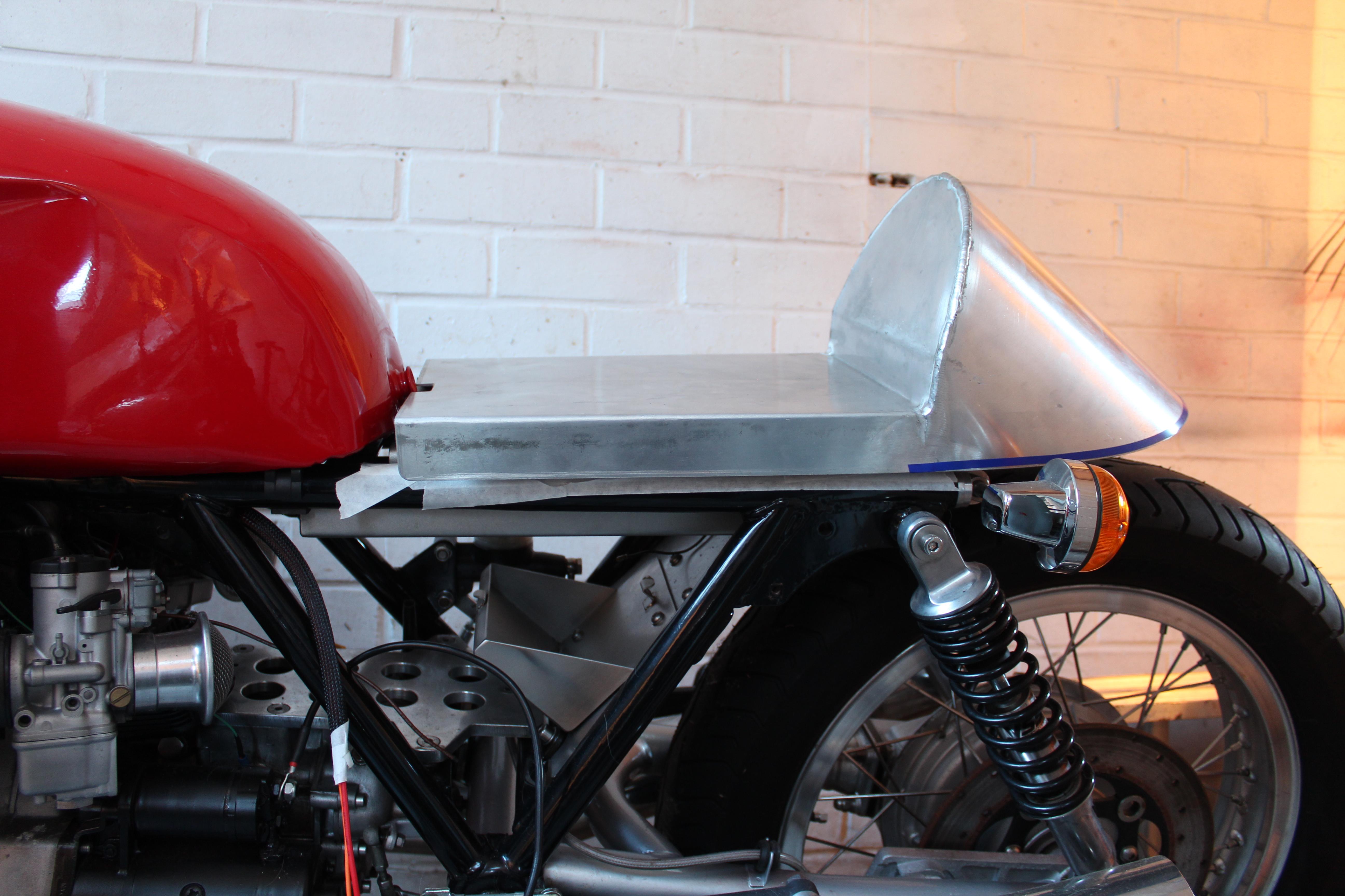

Spent the afternoon making the seat mounts, so they are done except for a couple of holes that need drilling that I had to mark when the seat was back on the bike.. all straightforward. But cutting back the lower edge of the seat hump was tricky. I spent a long time trying to mark where to cut using 3M pinstriping tape, it probably isn't perfectly symmetrical side to side, but its close.
That done, I wasn't sure how to cut it back... hacksaw, belt sander, cutting disc, or just file it back? In the end we found using an old pair of tin snips got us close, then finished off with 60 grade wet n dry. Still a little more to take off, but again I stopped so I could take the seat home and eyeball it on the bike.
Pretty happy with it so far, but I think the front edge of the seat where it meets the rounded back of the tank still needs more work. I think I'll play around CAD.. Cardboard Aided Design again, and have a pair of filler pieces welded into that area.
