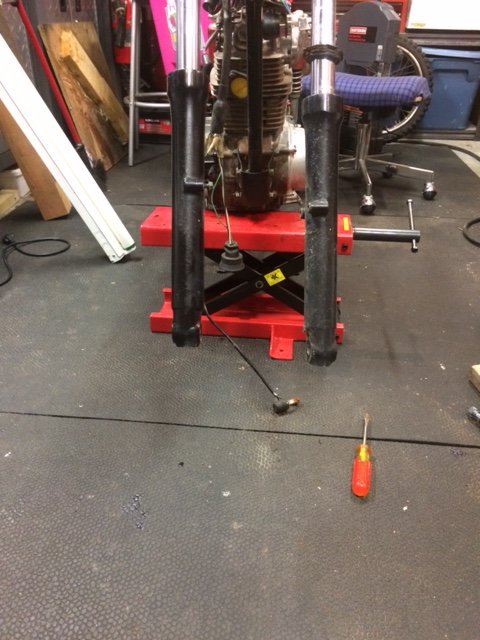

71 CB 100 with a 90's CB125 s Wheel, caliper and fork lowers with a CB200 fork uppers and triples and I am not having the forks sticking out of the top of the triples like that the pic of the forks show the CB125T fork upper longer then the CB200 fork upper

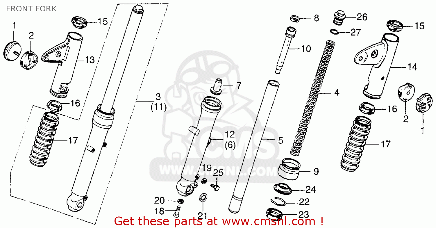

I am not sure what you mean by threading but here is what I did
I used the CB200 triples and top of the fork tubes that I bought from a friend of mine.
31mm Honda CB-200T (75-76)
31mm Honda CM-200T “Twinstar” (80 To 2012204)
31mm Honda CM-200T “Twinstar” (80-82)
The 1990 CB125TT Fork lowers and rim
31mm Honda CB-125TT (90)

The CB200 forks are shorter by a few inches then the CB125t tubes so I just swapped them and they fit quite well. I would look at a fork chart and figure out what will fit Diameter wise and then start looking at the fork lengths. you should find something that will fit. Getting the tube retreaded might be a pain in the ass. Here is a list of bikes with 33 mm forks and Tube diameters as well as some other info.
