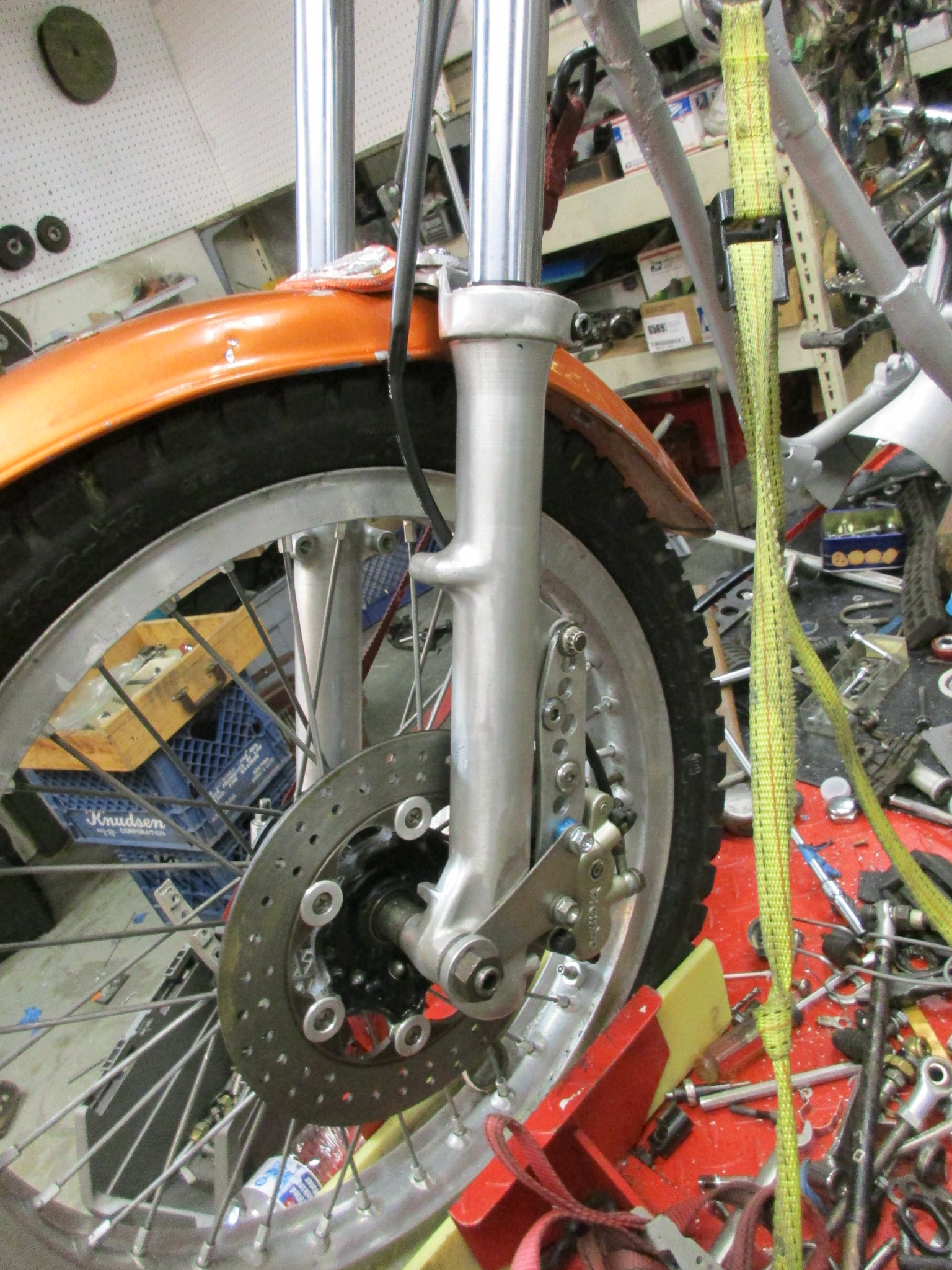

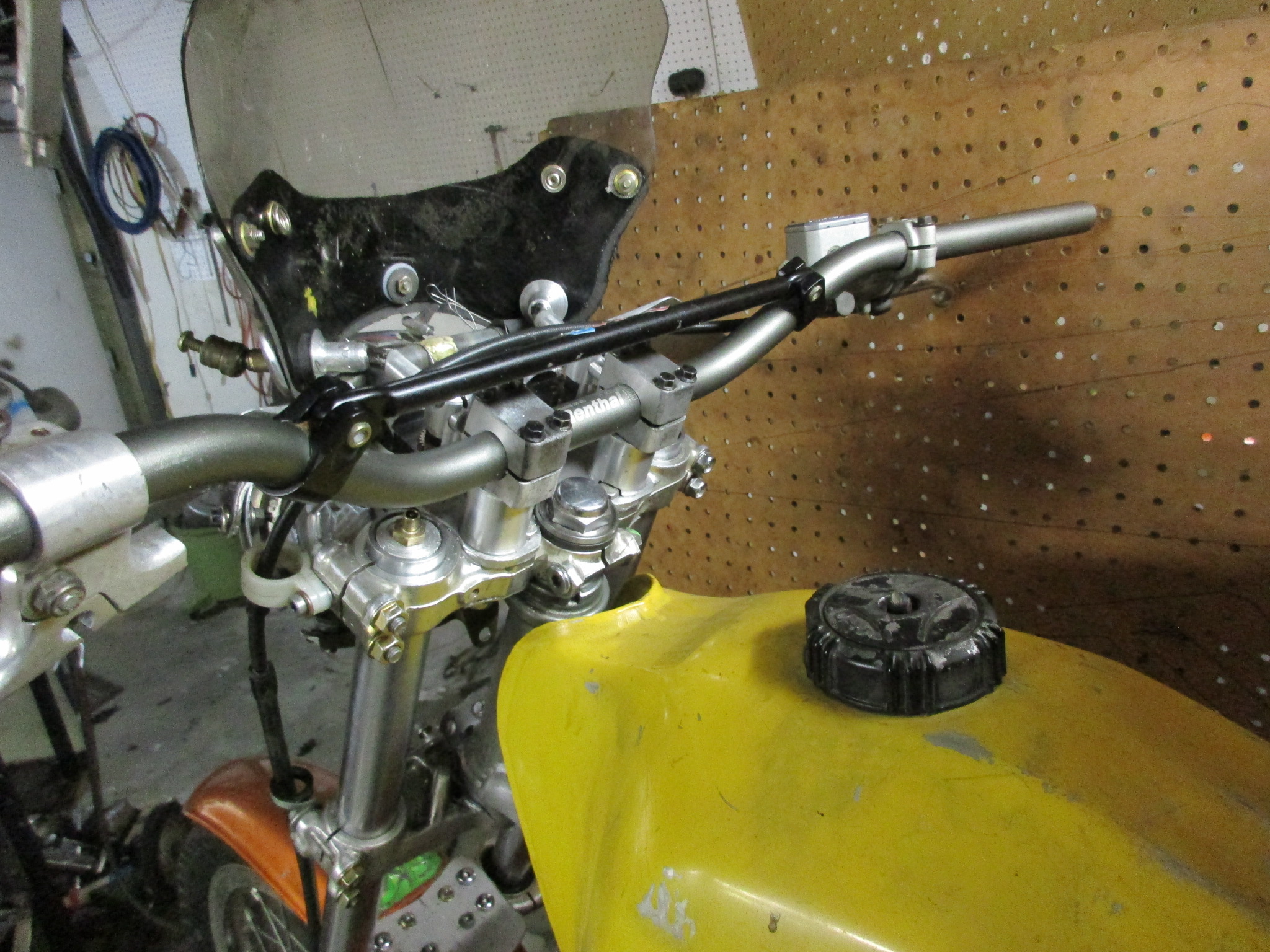

'79 cb650 with GSXR 600 forks, Cognito Moto front hub & top triple with Moto gadget guage :)
kmcphee, Where did you get the megaphone? Im really wanting something like that for my CB750 project. Everything on ebay is not a 2.5" outlet, but 2".
wasn't exactly a straight swap 650 maxim sliders, klx250/kx125 19i78 or so 36mm thinwall stanchions ,fitted with modern du bushings ,shortened dsamper pods shortened trasvel at 8" racetech gold vales fork brace hacksawed fromn some jap mmx bike with downsideuppers
lower triple clamps of suzuki used lower and toppom
my patented bearlyrisers(pronounced burly-risers)mids 80's suzuki rm front hub mid 80's meehanite cast iron husqvarna disc rowter
17mm hollow 4 130 canam front axel()up from 15mm)xc650 talkasaga ankront copy high quivering lip wheel rim in 1 .85x19brembo master and clapper ktm sourced etc

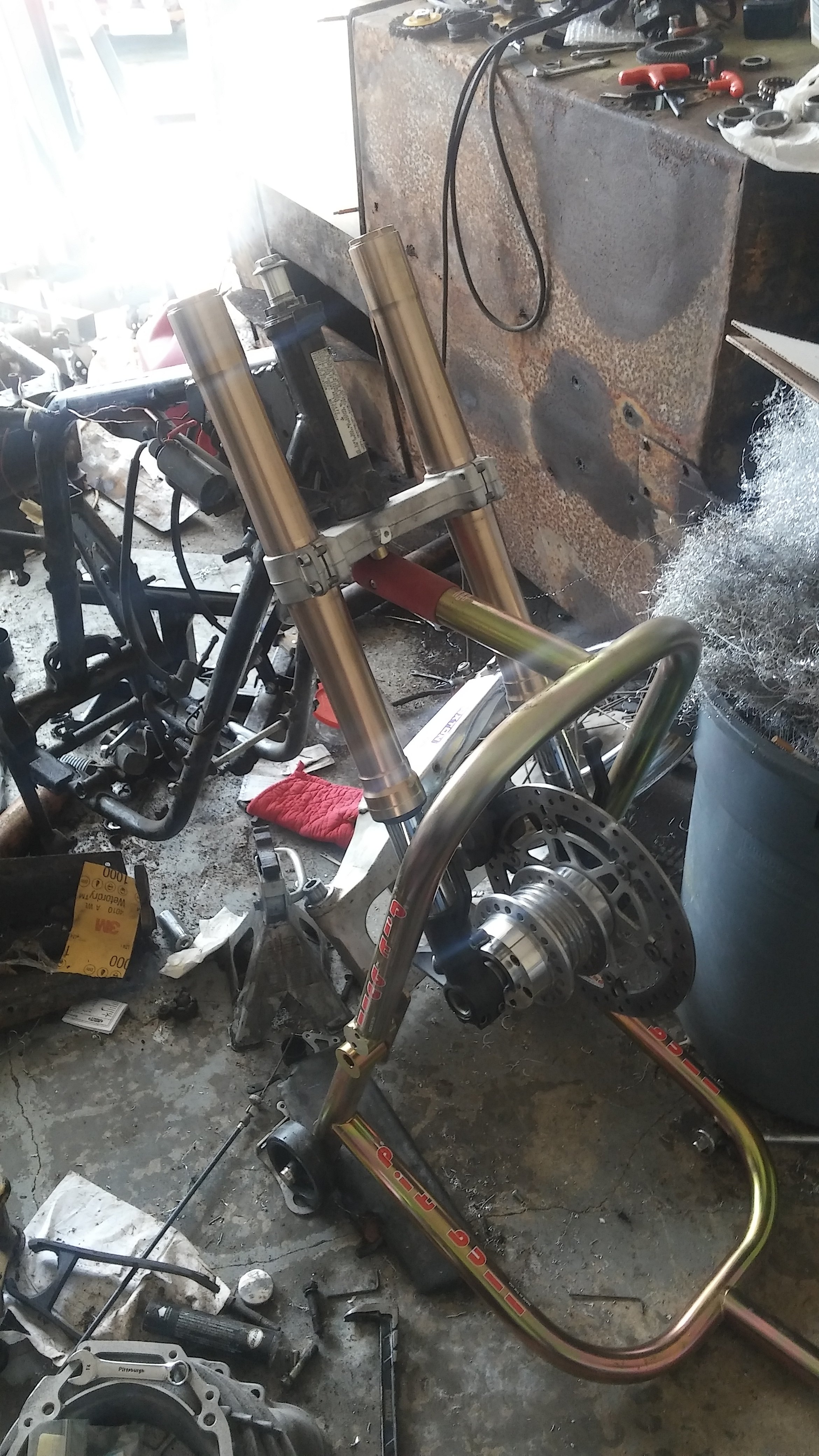

Just wrapped up an FZR1000 front end setup ran single disc with a GSXR rotor and stock Comstar wheel on a 1980 cb750K

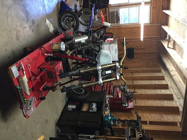

Well, it's similar. I have a 1982 gs1100 with a rear end off a Hayabusa! (Shock, rear wheel, swingarm)
Here are some photos!

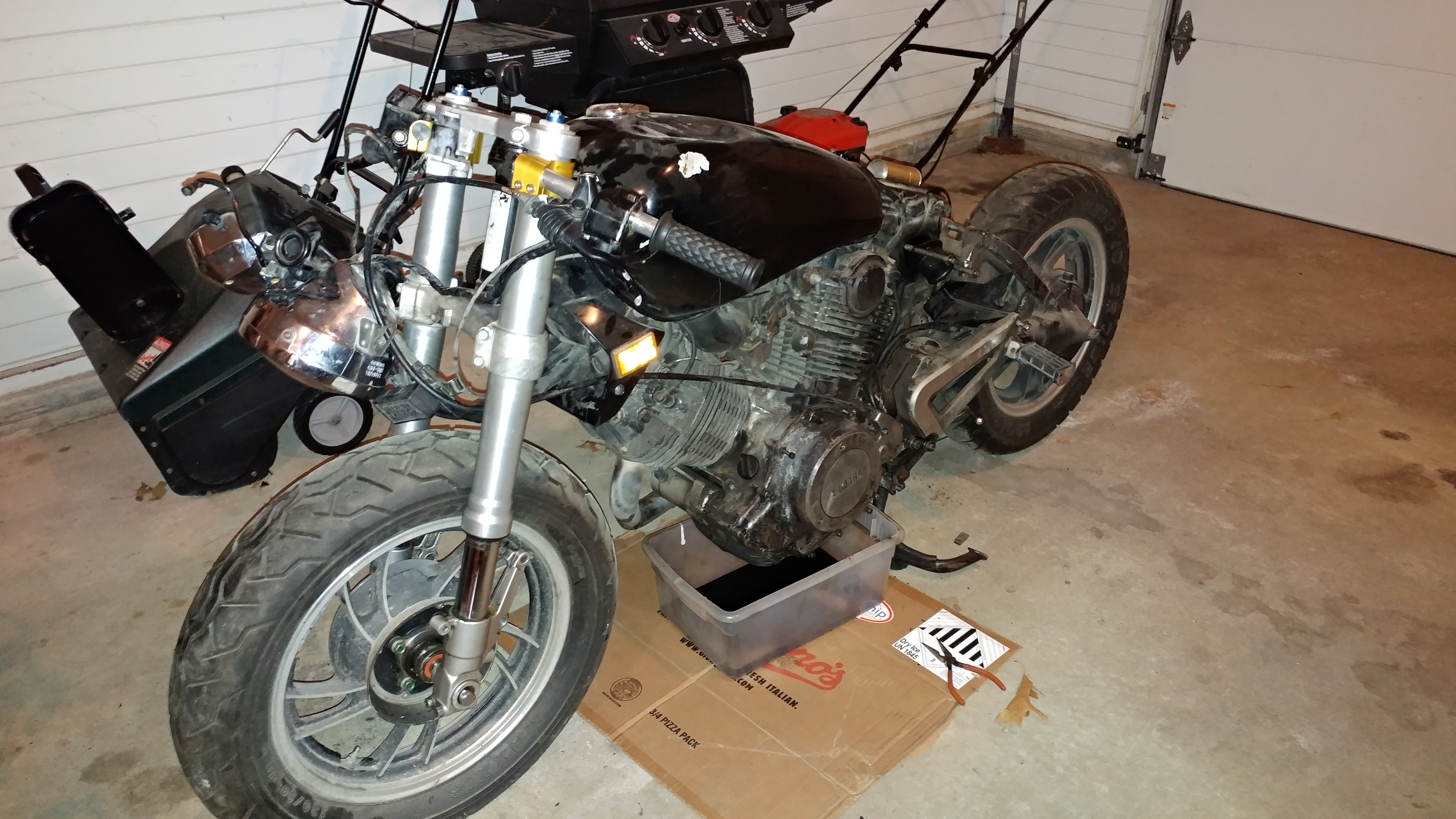

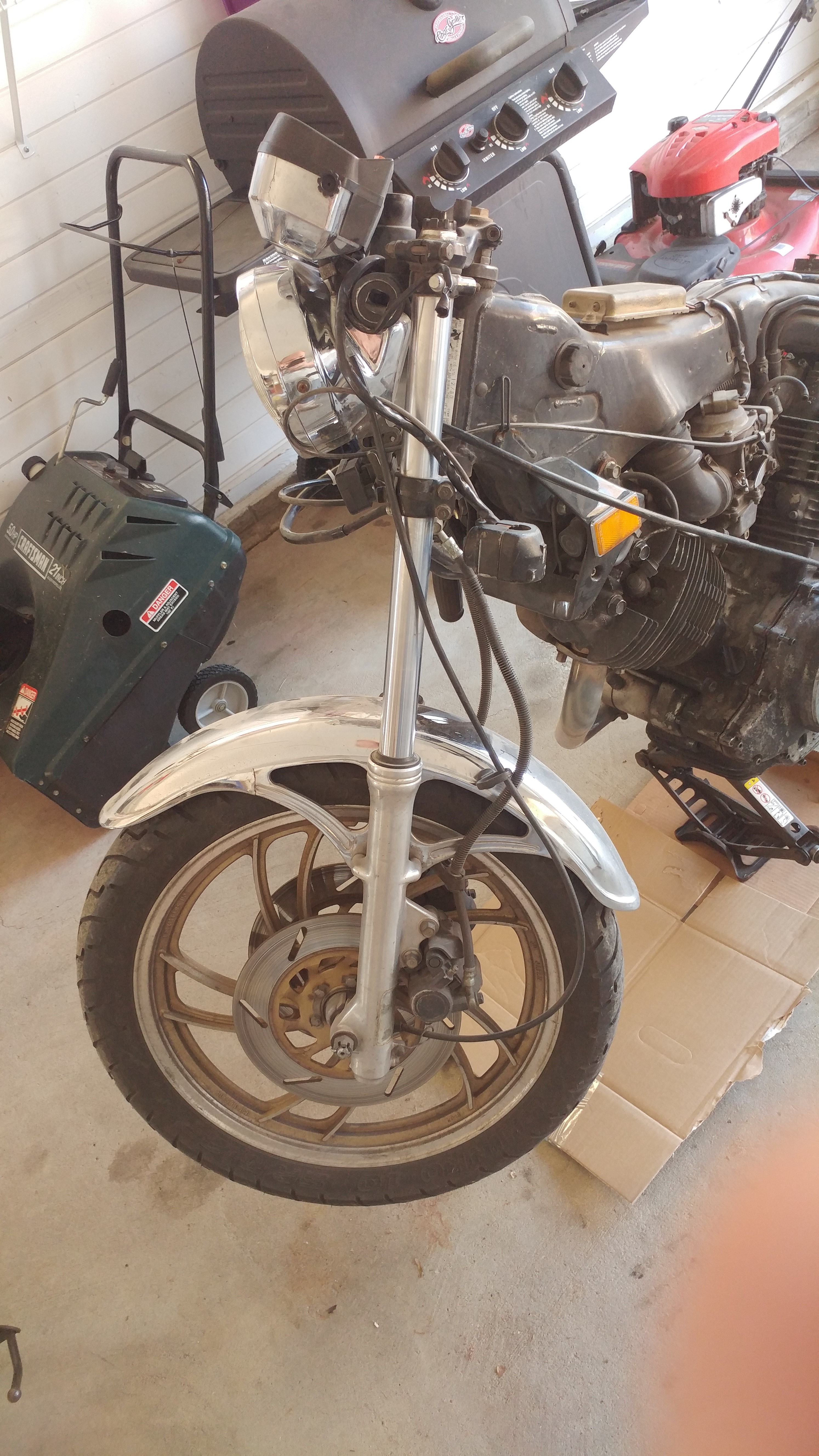

I swapped my 1981 Yamaha Virago XV750 38mm forks for a 2001 TL1000R 50mm forks. with a virago rear rim conversion for the front rim. first pic is stock front end and the next two are after the swap

underdogauto said:
What front wheel are you using? And what size? I would live to do a similar swap on my 82 cb750 but didn't think I could run a spoked wheel.
Sent from my LGMS631 using Tapatalk
Sorry just saw this.
It is a Harley "Narrow Glide" wheel, I believe '04+ The ones that use a 1" bearing/axle combo.
It's 19", not sure the tire size right now, maybe 90/90/19

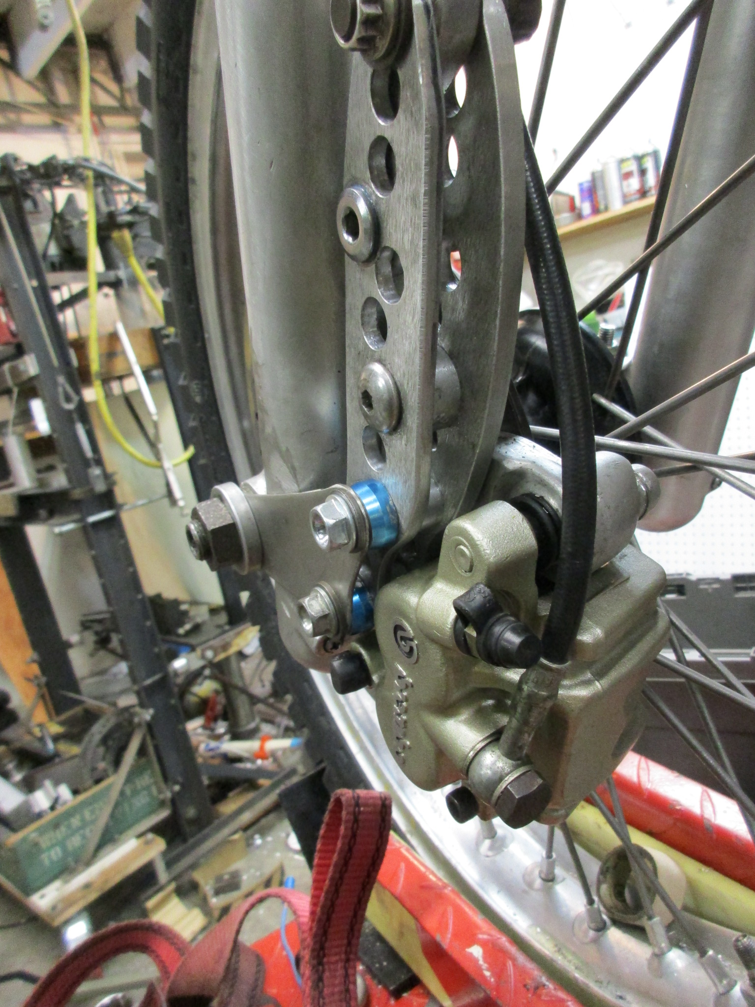

Still have to make an upper triple clamp, but 2012 zx6 forks and lower triple with a custom stem, hub is a modified cb550f, with ducati rotor lining up on the yamaha caliper.
