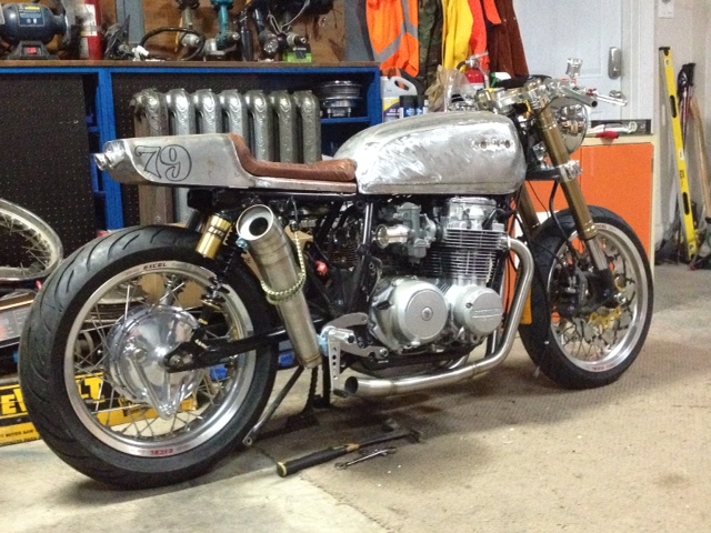

'79 cb650 with GSXR 600 forks, Cognito Moto front hub & top triple with Moto gadget guage :)
