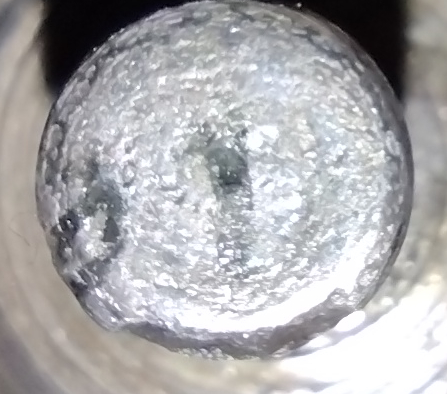

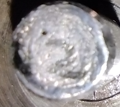

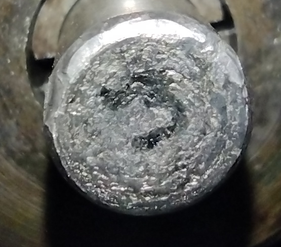

The ends of the valves don't look so good. (at least the exhaust valves, haven't got to the intakes yet). And, this is
the best one.
You can either get some hardened valve stem caps or a set of Norman Hyde big foot tappet screws to spread the load.
Afraid spreading the load won't help. The Stellite is already flaking off. I have wear caps on order. I will just have to mount one up and make the decision if the stems need ground down first, or the added 0.080" won't change the valve geometry too much. Some show some fairly bad flaking. Hope it hasn't eaten bearings. That Stellite is hard stuff!

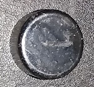

Wear caps came in. I put one on #3 exhaust valve stem with a coat of Dykem on it, Installed that push rod and rocker box (no gasket). Adjusted the rocker clearance. Rotated the engine through about six openings of the valve. Pulled the box off and here is a photo of the wear cap. Path of the adjuster tip is clearly visible and just slightly off-center. Left in the photo is the front of the engine. I'm satisfied that this will do without grinding the stem. The Viton-tipped float valves came in, too so that is also moving forward.
I tried stellite tipped valves and they came out like yours. The valve adjuster more or less nibbles it off.
Hardened caps help and you could move the rocker arms left to right to center them with shims. They are supposed to be slightly off center to rotate teh valve and spread the wear. But it's still a point contact and that's why people use ball end adjusters https://www.ebay.com/itm/373661536211 or mushroom adjusters. https://www.ebay.com/itm/1851788430...=5338817806&customid=102_190_208&toolid=10050.
