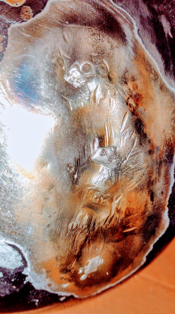

After pulling the big dent in the right side (common fork crash - not from this bike), Bondo'd the wound and sprayed with self-etching primer.

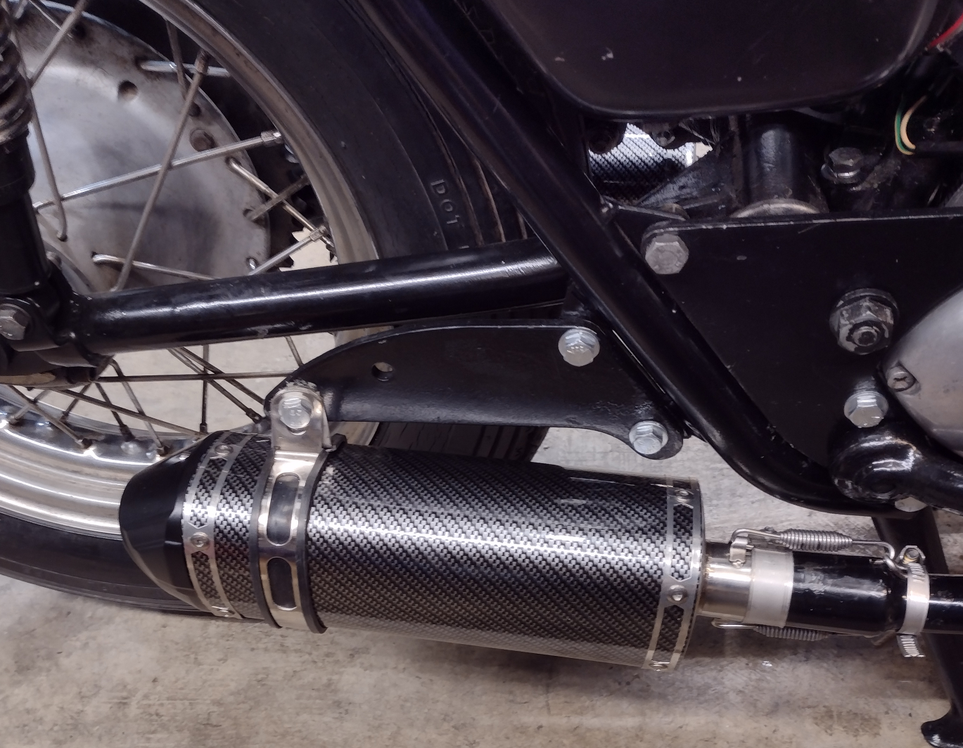

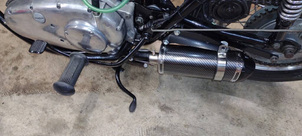

One of the two mufflers that I ordered (at the same time) came in from Amazon. The other is due Wednesday along with clamps for the joint. Then I'll be able to hear the engine over the exhaust (hopefully). Not a classic look, but going for function (and cheap).
Mufflers on and done-up. My headers have a 1.5" adapter welded on to each, ending ~1" before the end of the smaller pipe. So, I had ordered 1.5" inlet mufflers, which just butt-up to the pipes. So, had to spin a couple adapters out of aluminum and the used 1.5" clamps to tighten it all together (along with the exhaust springs and loops that came with the muffler). All ready to add oil and fire up to see how it really sounds. If it EVER stops raining.
