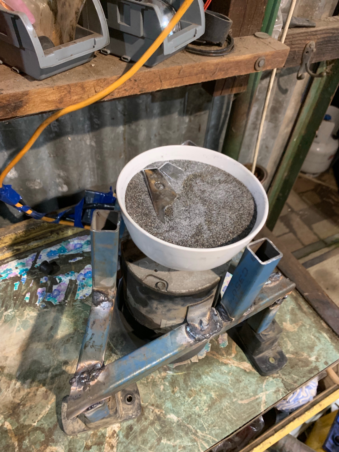

And finally for today, I made a parts vibrator which I first seen on ichiban moto. I have some parts in it at the moment so will see if it works tomorrow. Bit concerned as I don’t have any real rough agrigit. 50% sodium bicarbonate and %50 fine sand stuff leftover from blasting the frame. See what happens soon I guess

Update on the parts cleaner. The sand I used isn’t course enough so will get some new stuff to give it a go and hopefully that sorts out what I’m looking for

Hey mate. Yeah parts vibrators are a thing. It’s kind of worked but the part was probably too rusty and needed to go in the sand blaster. As for the tubes, the rusted section is above where they compress down. I will add a photo to show how the damage is up by the triple clamp and not near the seal.
