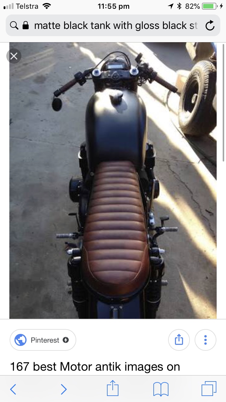

I’m looking at what pint scheme I should do for the tank and fenders. Probably going matte black with a gloss black stripe but off to one side of the fuel cap, left or right

just out of curiousity have you mounted up your master cylinder?
I had those some clip ons and the master cylinder did not work at all at a reasonable angle - I ended up getting new clip ones that were all steel instead of aluminum - comprimise in weight but I could run the stock master cylinder without interference. (this was before I decided to do the remote master cylinder I have now)
i've seen people shave a good amount off the cylinder - or just use a radial master from a modern bike
I doubt I will go stock, it’s a bit big and clunky for me. I will need to consider it soon though. Probably a modern option I think

Man, love those grips. I ended up using tennis racquet leather grips on my old V Star but these look much better. Thanks for the posting - got these beauties bookmarked 8)
