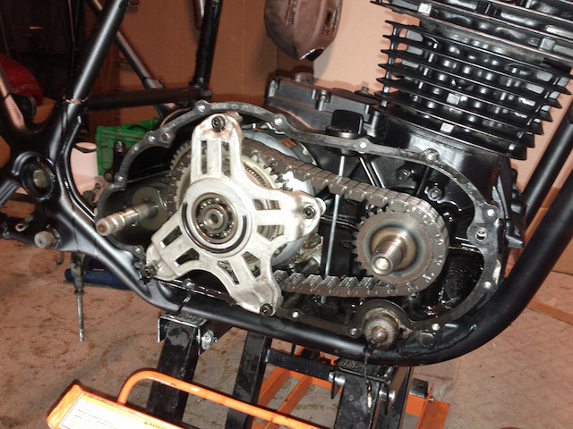

Ok, so kickstart crisis averted. Figured out it just has a sticking point and then it spins freely. Just a bitch to kick. Might replace the return spring and button it all back up.

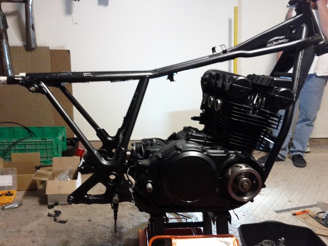

Hacked off the rear section over the weekend and all the tabs. Just need to clean it up and weld the loop on.

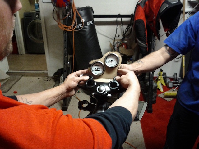

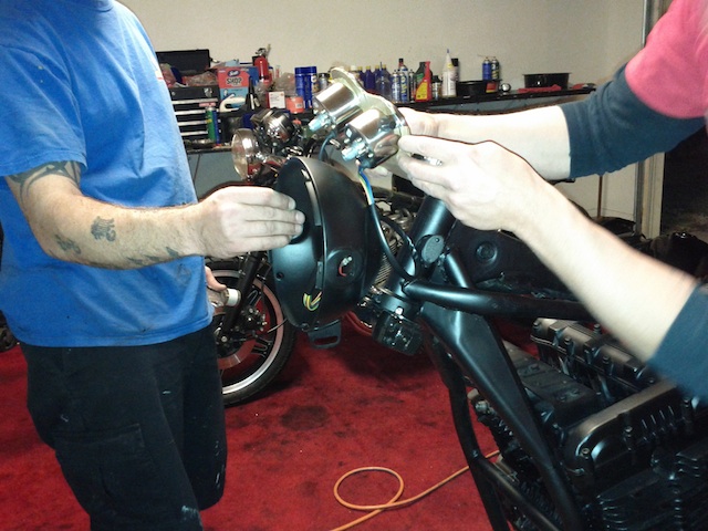

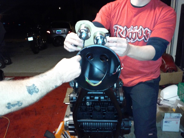

Working on doing the gauges staggered a bit. Need to get the headlight brackets cut and cleaned up before we can really see how it will look.

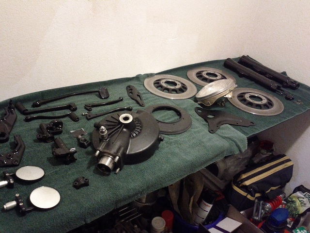

Looks alot like my shelf in the basement last night, but my pile isnt as clean and tidy yet and has slotted XS850 rotors and a XS11 final drive going back on 8)
@7-fiddy....we are playing around with the idea of drilling out the rotors. Is there an advantage to bolting up the 1100 dif?
@Koconut....yeah got those mirrors for like 6 bucks thanks to ebay! I'm running a3 into 1 and kicking around the idea of putting on a short cherry bomb exhaust.
Drilled or slotted Rotors is the way to go, but you I found you gotta stay with organic pads. HH stuff kills these old rotors quik.
XS11 Final gives Lower gearing for being a hoodlum around town but is a bit too much for the interstate . Used mine form spares off my old XS11 E but you get them all day on the 'Bay for $10-$50.

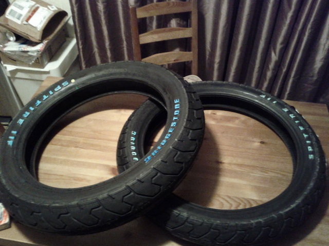

You need to come to AZ, its like a jap bike preservation. LOL Oh and my tires came in yesterday and I think they are going to look good on the wheels. Hopefully can get them mounted up in the next few days. Spent most of last night getting Zach's wheels apart for King Midas. Here's the thread if anyone is interested in our other project.

damn, I love that lettering. I have the same tires, but I went with the black lettering. Def going with the whites next time.
Yeah as some of my wrenching buddies will confirm, I am obsessed with white letter tires! Its a holdover from the 80's I suppose.
