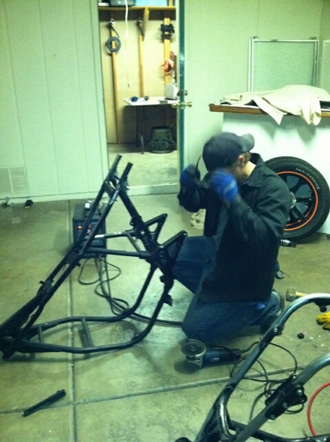

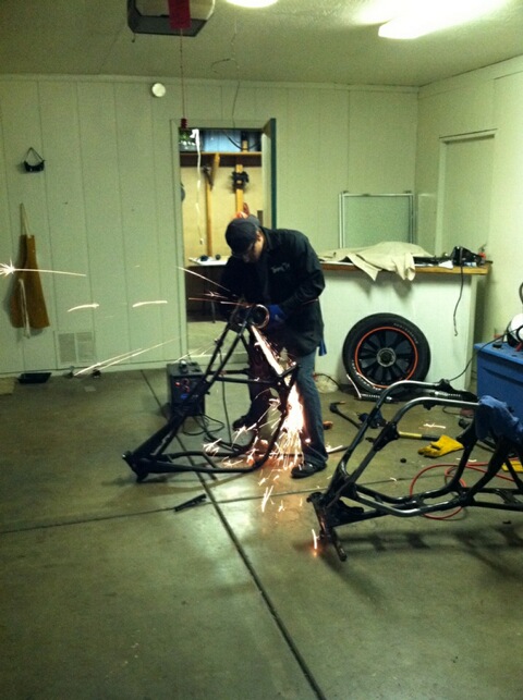

Finally got the welder dialed in and made some progress. Got the panels cut and fitted for the seat pan and repaired the shock mounts.

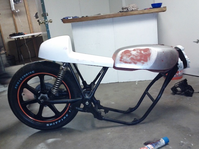

Even though it was hot, hot, hot this weekend, we were able to make some progress on both projects. Got the frame welds cleaned up and the frame repainted. Also got the front end mocked up to start figuring out gauge placement and all the details. Hopefully next will be engine drop.

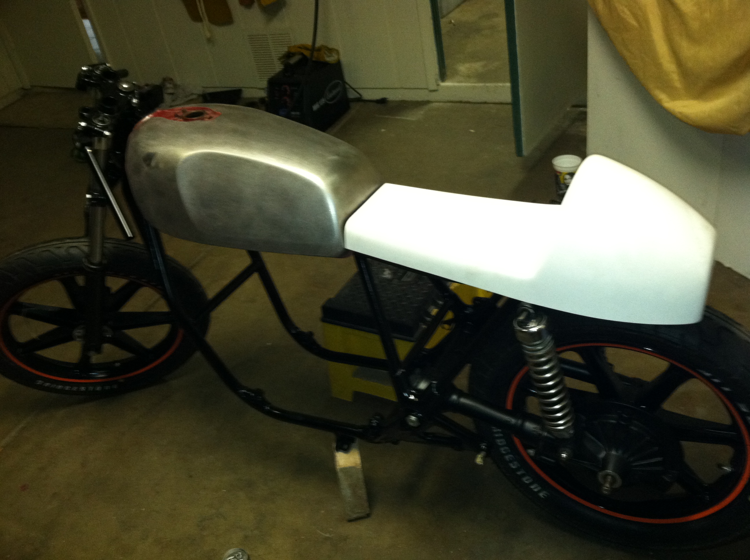

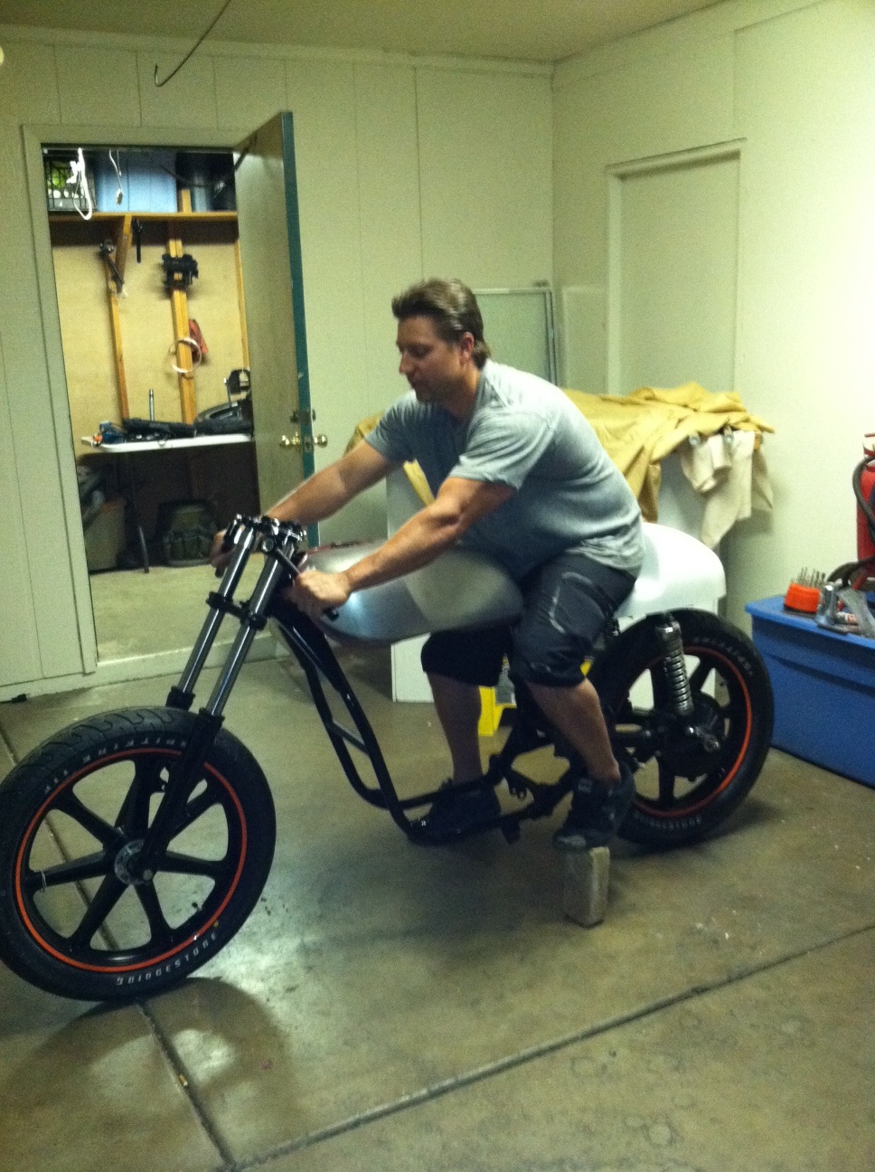

So after some time passing we finally are getting some of these projects moving along. Got the bike mocked up for the most part and had a little fun rolling it down the street. Its nice to see the look come together a little.
