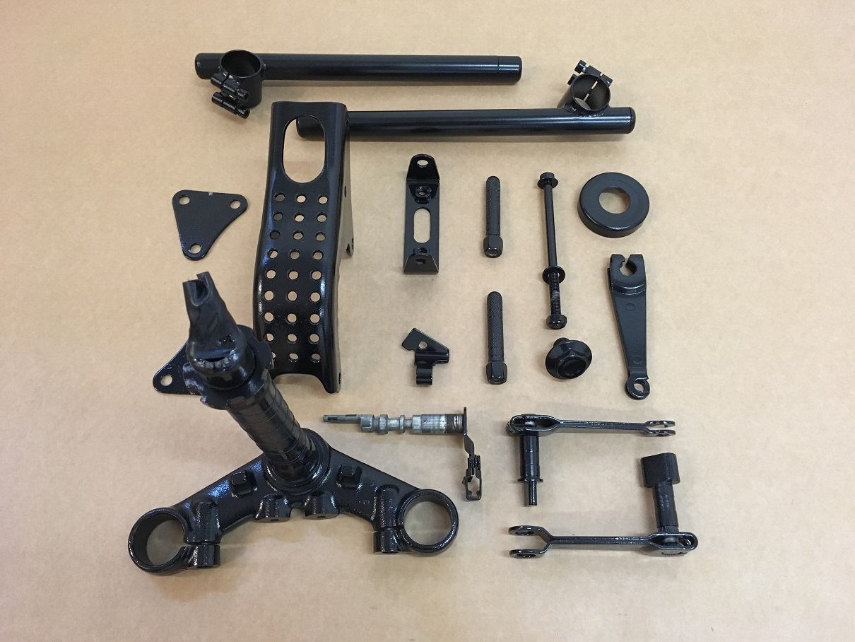

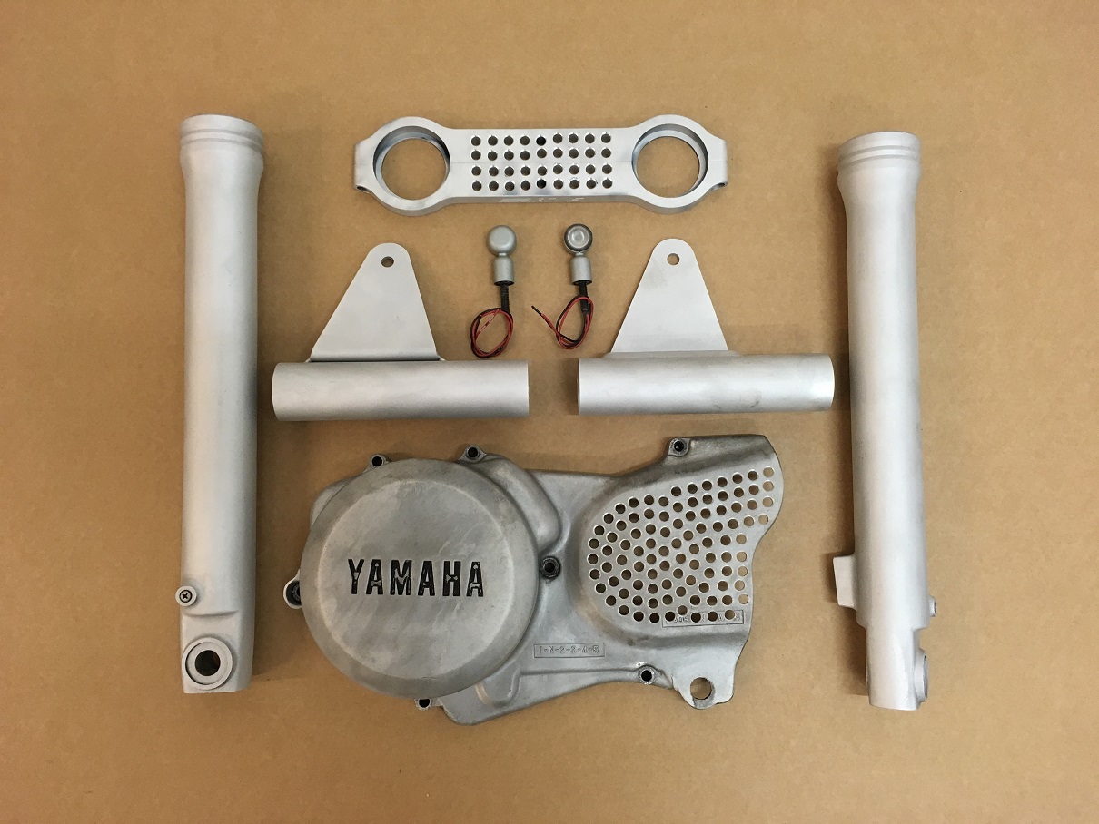

Anyway, before I packed up everything I did some final blasting and powder coating and came up with this... The parts look pretty sweet. Still deciding if I will use the blasted finish or go with brushed or even something a little more 'distressed'. Again, I want the bike to look raggidy :D
Nah the blasted and/or distressed look doesn't really fit with the clean look of the rest of the work you've done. I'd go ahead and powder those parts too. Maybe bring in a matte or satin powder to balance off the gloss black.

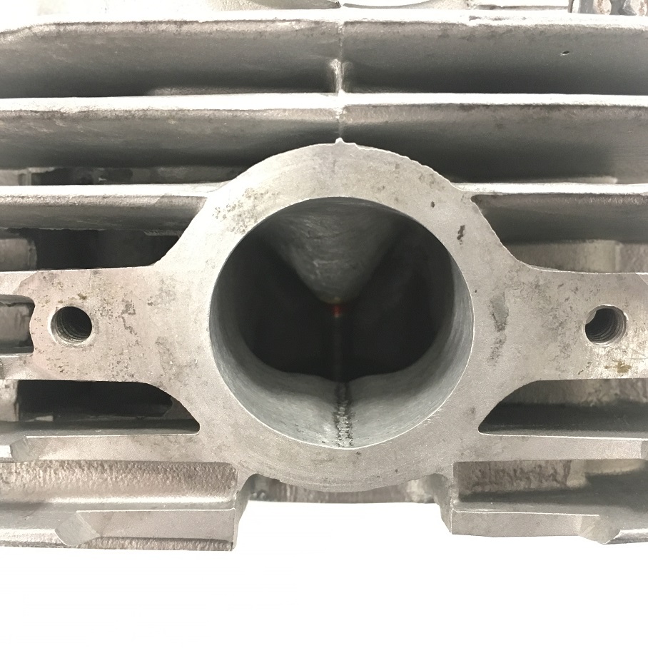

A final message from Chris before he sends the head - saying he is done and everything is assembled - with the new cam, new bearings, new valves, guides, stem seals, springs retainers and lash caps (for the Ti valves). Can't wait to see it in person. Should receive it next week ;D

Not so much to report on recently - still getting stuff organised from the move. But here are a few more pics of the head - it's really great work, can't wait to test it.

And there is scope for further development with lighter rockers and adjusters and nuts. And squish area has scope for further development too.
I has limited success with alloy tappet nuts - they come loose, but Ti nuts work. We also had sets of the screw adjusters drilled out and broached to take a tiny allen key to say a few more grams in one of our race motors.

Awesome to hear someone has done that! Any measurable results? I actually bought some adjuster bolts from Kedo for the SR500 to see how they were done - like how you described (hole with Allen detail). Although that might be out of scope for this project, Ti nuts certainly isn't... !

I didn't do a before and after comparison, but fully lightened motors tend to rev a little higher than those that are not as extensively modified.
Pops Yoshimura published an article decades ago about modifying CB72 and CB77 motors and he documented the peak revs that the motors achieved with different weight of valves. Anything that reduces reciprocating weight will allow the motor to rev higher before bad things happen but may not necessarily increase HP unless the motor has sufficient breathing ability. Another way to phrase that is that if a motor has more flow capacity than it needs at peak revs, then it should be possible to raise that peak and make more power.
In the case of valve trains, every little help, but only a little helps only a little bit. :-)
You can also check your port shapes and compare them to AG Bell's relative shapes. It's not always possible to get it all 100% correct, but Bell's numbers give a good idea of where a port is restricted and where it's too large. If a section is cast too large, it can be reduced with Devcon F or increase the size of other sections including the valve if necessary to make the port more efficient.
One trick that people seem to underestimate is getting the squish right - or at least making the squish band work. That usually requires the head and piston and barrel to be machined which will raise compression a touch. The result of getting it to work should be more power everywhere in the range. Good squish allows higher compression before detonation sets in.
That is one of the things I've done since about 1978 as it's cheap plus improves fuel economy and driveability. On my CJ250 (@391cc) I used divergent angles between piston top and cylinder head to make sure gas could get where I wanted in a relatively small (250 head) combustion chamber for 56mm bore instead of 67mm head design. It was based on two stroke chambers I had worked on. I've modified several sets of CB750 pistons to fit 500/550 fours. (591cc) My mods are way removed from the published 'Gentleman's Express' 500F spec. and give about a 40% decrease in fuel consumption plus a 17mph increase in top speed. It's part of the reason modern sport bikes are so successful, the entire engine package was developed around known (and now much better understood) parameters. It may be a good idea to clay the piston top and do a combustion chamber assessment?
