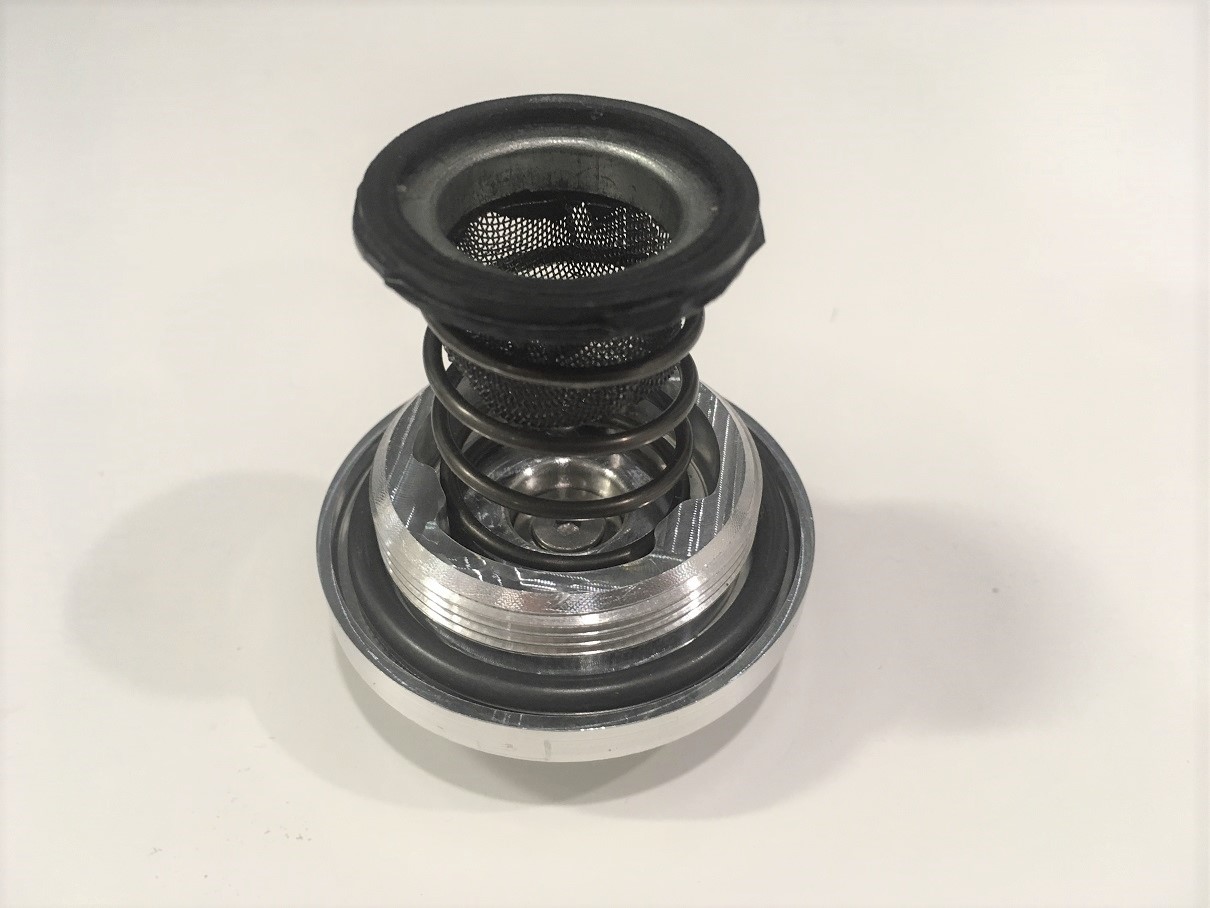

The related things have been clearing a space and preparing table room for the project. I have booked the frame and swingarm in to be blasted and have received and tested the first aluminium prototype for the magnetic oil/sump plug. It works really well, just a couple tweaks and I'll be able to order a production batch.

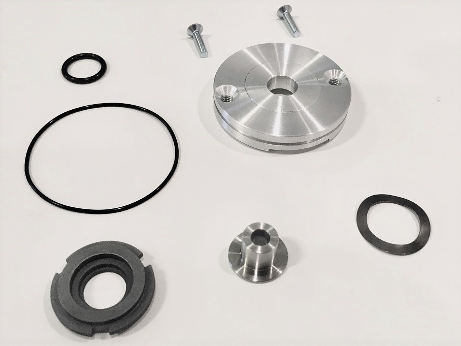

And one more non-related thing has been finalising the carbon seal kit for the . I just sent a prototype to a guy in the UK building a turbo SR150 for him to test. If you're interested I can give more info about it and you can also check out his instagram account: shed_built_customs

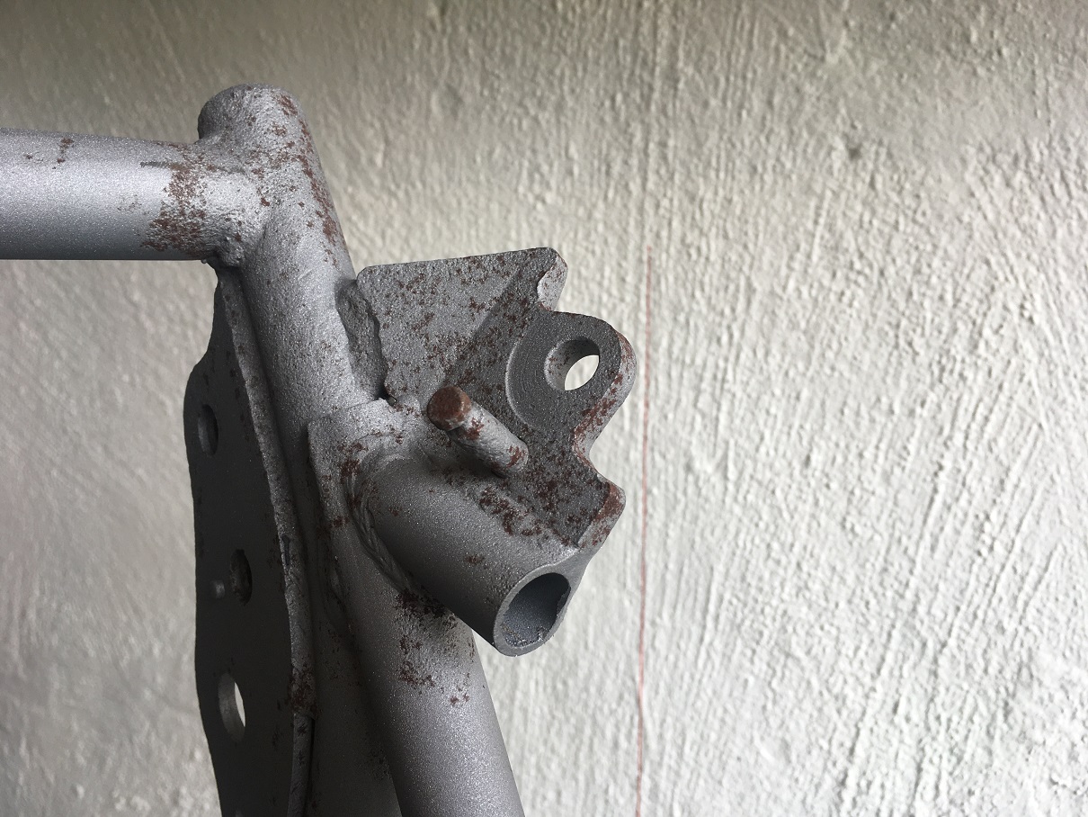

Finally got the frame blasted and welded up some things that needed patching. Hadn't welded for well over a year and to say that I am not proud of these welds would be a gross understatement. If they were going to be cosmetic welds I would have got a professional to do it but they are just patch jobs, non-structural as well.
Perhaps it's also time to fork out for either a MIG or TIG. The old gas welder has its benefits for sure but I can't seem to master it (maybe that means I couldn't master a TIG either?!). As with most things I guess practice makes perfect!
Now to prep the frame for paint! I bought the Rust-Oleum Combicolor that was suggested here :)
