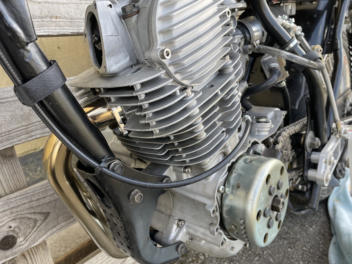

I have now ridden the bike 120km and decided it was time to change the oil and filter, adjust the valves and re-tighten the head bolts. The head bolts hadn't budged and were still at the same torque. The valves tappets however needed some slight adjustment - both on the intake and exhaust. Looking into the head everything seems to be lapping in nicely with each other - cam and rocker surfaces. The oil seemed very clean, as did the oil filter and oil pick up gauze, so that is all positive.
Then when closely inspecting and cleaning the magnetic oil plug, I found a couple of tiny hard metal particles/filings. I have no idea what they have come from or if they have caused any damage anywhere, but I sure am glad the magnet picked them up! Well worth having developed this part! I guess time will tell if there is any internal damage.
I also swapped out the M8 tank bracket bolt from a 12mm hex to a 6mm flanged allen bolt - so that both the seat and the tank can be removed with the same tool :D There you can see the automotive fuse conversion done as well - very convenient.

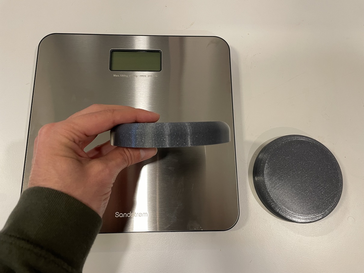

I managed to weigh the thing this week, that is why I wanted to check what I was thinking back in 2017 haha
I rode onto a large industrial scale down at the port used to weigh grain trucks and it said the bike weighed 120kg! So I didn't trust that, it probably has a tolerance of +/-10-20kg or something.
Instead I bought a bathroom scale and 3D printed a couple of plates so that all three ground contact points of the bike were on the same level, then took a weight at each of those contact points. I had seen many other people on other motorbike forums using this method so I thought I'd give it a try. The pictures do the speaking.
I drained the fuel from the tank but not the 1.7l of engine oil which according to this site weighs 1.5kg.
So the weight of the bike is:
Weight front wheel: 41.65kg
Weight rear wheel: 41.35kg
Weight side stand: 28.85kg
Minus the 1.5kg for the oil leaves a dry weight of = 110.35kg
Plus 5l of fuel (1/2 tank) using this calculator = 3.69kg
Making for a wet weight of = 115.54kg (which is close to what the industrial scale said!)
I must say I am surprised and somewhat disappointed. You have all seen the lengths I have gone to lose weight off of this thing. I though a 110kg wet weight would have been possible - therefor closer to a 100-102kg dry weight. I am not 100% sure what the weight of the bike going in was but if you are to believe the manual and spec sheets, it would have been 130kg wet (oil in, 1/2 tank of fuel). Did I only manage to lose 15ish kg of weight?!
My conclusion is that I am probably one of the few anal people who actually go to these lengths to weigh their bikes and that many people claiming they have 'trimmed 30kg' from their bikes have not actually weighed their bikes before and after and probably confuse wet and dry weights. However, maybe there is more weight to be lost on bigger bikes? Also, again, that BikeExif article about the custom SR250 weighing 80kg is just plain bs. Haha I am still hung up on that straight out lie.
