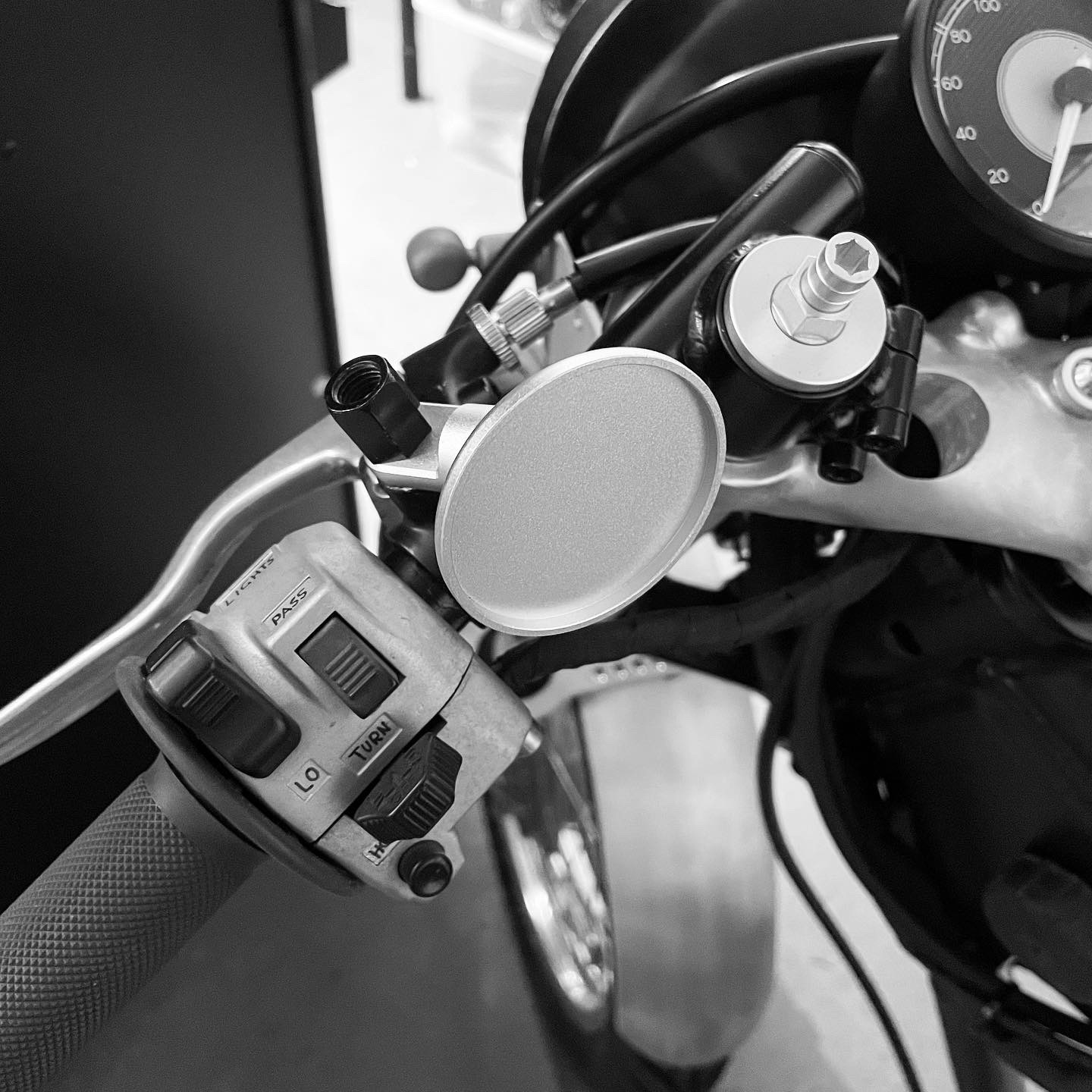

While I have been waiting for parts through this project and especially recently waiting for this engine work to be done, I have had a pet side project on the go. A problem I had with the last SR project was finding mirrors that looked good. The same problem was encountered with this bike... So I decided to develop my own design to test and potentially bring to market. See attached some of the prototypes and the first machined prototype. The mirrors are to be used for 'under arm' use - you look behind you along the side of your body and under your arm rather than over your shoulder. This way the mirrors can be much more compact and closer to the bikes centre line - so they do not 'protrude' too much. They are very light and very small at 50mm diameter. Not the most practical no, but very much good enough to see what is coming behind you and keep an eye on things. I have had mirrors set up like this in the past and thought it worked well enough.
The final product would be supplied with proper mounting bolts as well - not the horrible ones in the pictures. The extension bar is supplied to be able to clear the switch gear (not needed in all cases) and to get the right rearward angle on the mirror.
What do others reckon?

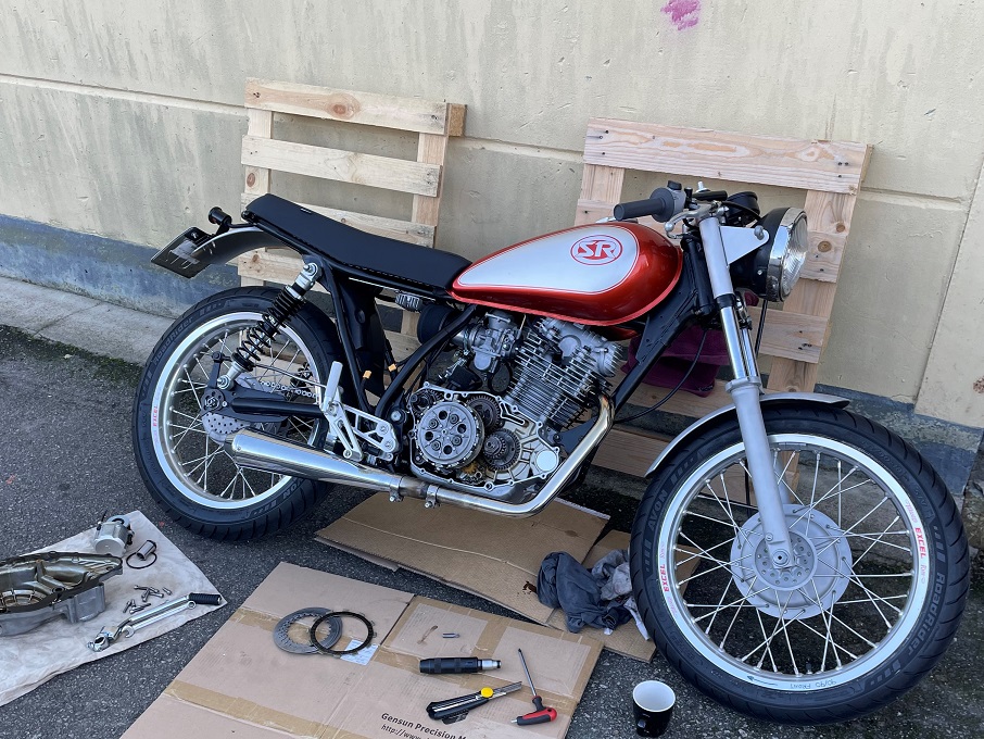

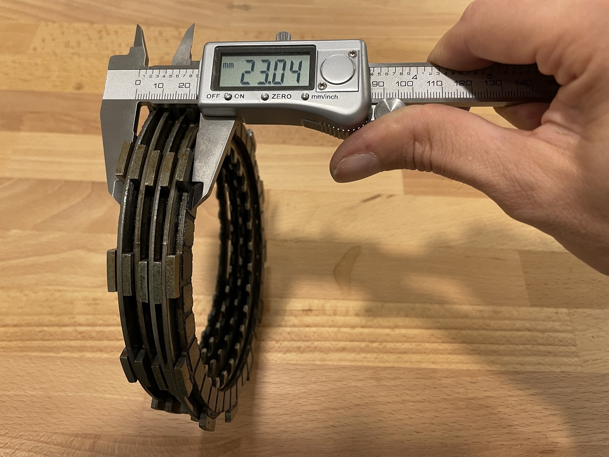

Now I have had a chance to investigate the clutch problem... it is still not solved. I changed the clutch plates but still get a little slipping. Then I looked closer into the differences between the SR250 249cc (1980-83 US models) clutches and the 239cc (1983-onwards) clutches and realised my mistakes/misunderstandings. I will share in more detail here in the next post. I will also write a blog post about it so other SR250 owners can have access to this discovery.

I finally got around to sorting the clutch and documented the problems in a blog post here: https://www.jadusmotorcycleparts.com/post/sr250-clutch-woes-and-wins
In short, there are two completely different clutch packs for the SR250 based on whether or not the engine is the 249cc version or the 239cc version. This means there are two part numbers for friction plates and two part numbers for steel plates and you must use an entire matching pack set - otherwise you end up with a clutch pack that is too thin. This results in very low clutch pack pressure from the springs and this was the problem in my case.
Attached are a few images from the investigation but if you want the whole story, check the blog post :D
Once the clutch was sorted, I took the bike out for a short ride and got to 110kph in 3rd gear... Which is promising! Unfortunately riding days are few and far between now that the colder and wetter weather has set in. I may have to wait until next riding season to really wring it out.
