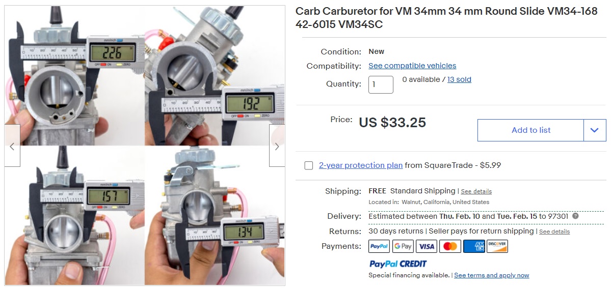

That would be a great starting point for jetting. I also didn't know about the possibility of boring up the TM28, that would be perfect. And a good rule of thumb from the CV to slide carbs needing to be smaller, very true.
Thank you for the advice! (Especially the Cheat-Sheet on the jets!) To be entirely honest, you guys are going to find that I tend to reach for the cheapest, lowest-hanging fruit when I try to get projects going. The original carb works and seems to be in decent shape, but the airbox is missing. So my next "logical" (not really) step was to try and find something on Ebay that would fit the SR250's intake boot. (cheap, Cheap CHEAP!) and that ended up being any carb with the 40mm snout on it. (40mm is right, isn't it?) They had some PK Flat-Slides and the Mikuni VM34 Round Slides for decent prices. From what I might have erroneously gathered is that the round-slides are supposed to be more user-friendly than the flat-slides. I have been known to make VERY ugly mistakes in the past, so no surprises, here. I'm beginning to see the light as far as 28-30mm being the most ideal for a stock 2-valve 250 cc engine, so the 34 will be over-zealous unless I uncork the breathing in other areas.
*EDIT* Well now, I can publicly kick myself... they DO make a VM30 with the 40mm snout. Live and learn.
Also, I'm still in the "Gathering of Junk" Stage, which means, I haven't so much had time to TOUCH the bike. I have a 1st Priority of getting my Wife's No-name 50cc scooter running first, and THEN I get to "play".
As a side note, this is a question for Jadus and all Projecteers.... How loud are the $40-ish Ebay mufflers that fit these bikes? I ordered a 21" side-turn-out looking thing, and it seems well built, but I sure hope it isn't too loud.
'I tend to reach for the cheapest, lowest-hanging fruit when I try to get projects going.' Perhaps cheapest in money but most likely not in time, but you may have more of that than I do!
I admire your ambition! Personally I have had bad experiences with Chinese carb copies as have many others, and I would not go that route. Who knows what kind of baseline they even have? Are they even comparable to the Mikuni? So that those settings will be the same settings in the Chinese carb? Tolerances, casting quality etc etc. I sound a bit negative here, but I can say that if you have a lot of time and are prepared to fiddle with jet settings a lot, you'll most likely get an ok running bike with your carb :)
When referring to carbs, it is the bore size or 'throat' that is usually referred to. That is the size of the carb after the venturi and the size that enters the carb boot/manifold.
To answer your question about the silencer; That will most likely be very loud, unless it has some form of internal baffling. There is a guy (Spencer) on the SR250 facebook group that installed one of those silencers on his bike and it looks pretty cool. So you could join the group and ask him how loud it is. He built himself a really cool bike on a pretty low budget so he may have some other tips too!
The restriction in the SRs exhaust is not in the silencer though so this would not really be 'low hanging fruit' or add anything other than more noise. The restriction is in the tiny internally piped header ;)
That's why I gots me some learnin' to do... I thought the stock silencer, with it's dime-size outlet would be the overall issue. The muffler I got looks to be a glass-pack design, maintaining a minimum of 30mm throughout. I'm hoping it isn't too loud- don't wanna anger the neighbors. The header would be nice to improve on also, but for now, I'm just gathering the missing essential parts. Luckilly, my basket-case came with what's left of the header. :) As aor the carb, I might be lucky and the stock CV will work fine with the correct air-filter routing. Then I wouldn't have to mess with the round-slide Fake-Kuni!
If it has a glasspack core it'll probably be fine. It won't be quiet haha but neither will it be straight pipe loud.
That might be a good place to start! Then maybe save some money for either the real VM34 or a TM like Flatcap Funk suggested.

Personally I think those Chinese carbs aren't too bad. But a wideband AFR and a dyno (or at least which you can drive up and down 100 times to check against the changes you just made), will come in very handy.
Also there's unbranded Chinese carbs, which I would stay away from and then there's those, which have a name, e.g. OKO - those are lot hit and miss than the really cheap "fell off the truck and no one asked"-kind...
Nibbi is another good, affordable, upper-tier Chinese brand. (And unlike OKO, I am not aware of any shady factories knocking them off.) I have purchased two Nibbi Keihin PE24 copies (a PE24 and a PE24FL), and a PE30. No quality issues with any of them, good performance, and excellent tune-ability all the way around.
I know they make sizes from 19mm up to PWK32 and PWK34.
