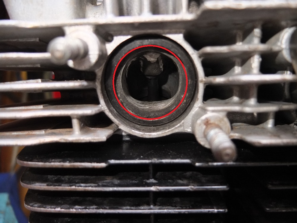

When I was playing with the headers I checked if there was much mismatch between the exhaust port and the header ID - it is considerable. The red circle is the 34.5mm ID of the header pipe, as you can see there is a lot of metal inside that circle for the dye grinder to remove. The exhaust valve OD is 31mm and it has a stem which also eats into the flow diameter, so there is no need to take it out all the way to 34mm. I am thinking the area down the bottom of the port where is has flattened out is in for particular attention. Any body who has experience in these matters I am all ears!
Cheers
Tim

"D" shaped exhaust ports are quite common on a lot of high end machines. Are you porting this head just based on guesswork? There are a ton of factors to consider before you go making the ports bigger. I would clean up the casting marks and have the head bench flowed to see what cfm it's doing. It is not uncommon on these old Japanese bikes to have valves and ports too big, so you may be close to the sweet spot right now. By making the ports bigger you may actually reduce velocity and kill horsepower. Same thing goes for the header ID. Going bigger than the exhaust port is only going to reduce velocity as well. How you plan on riding this thing should be the main thing to consider here. Is it a bike you are going to race or scoot around town? You obviously got some chops so I apologize if this post is redundant. I have been slowly researching for a kz750 twin hot rod build so I am watching with interest. I may build this DIY flow bench which uses a laptop and a shop vacuum
http://www.flowperformance.com/system.html
+1
Touch that floor especially if u take it back to the gasket and u will kill exhaust velocity and power.
Taller higher ports flow better.
In fact, the overhang might even prevent some exhaust gas reversion.
Thanks Doc & jcw.
Greatly appreciate your input and help to avoid disaster. Once the material is removed there is no going back.
This bike is not going to race. I prefer to avoid built up areas and find a nice twisty country road. So the bottom line looks like leave the ports as they are and only touch any obvious casting defects (which there are none).
Thanks again for for you great help.
Cheers
Tim
Sent from my GT-I9506 using Tapatalk
there's no saying what is optimal unless you do a flow check and do some calculations based on your cc size, cams, carbs...etc I'm just guessing that if you do porting it won't be much. You can polish the exhaust ports and clean up the intakes but leave them rough. Finding a header tube size that matches your exhaust port will help a lot as well

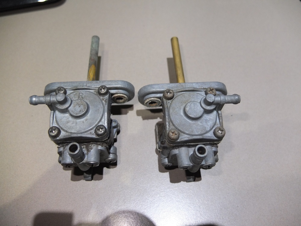

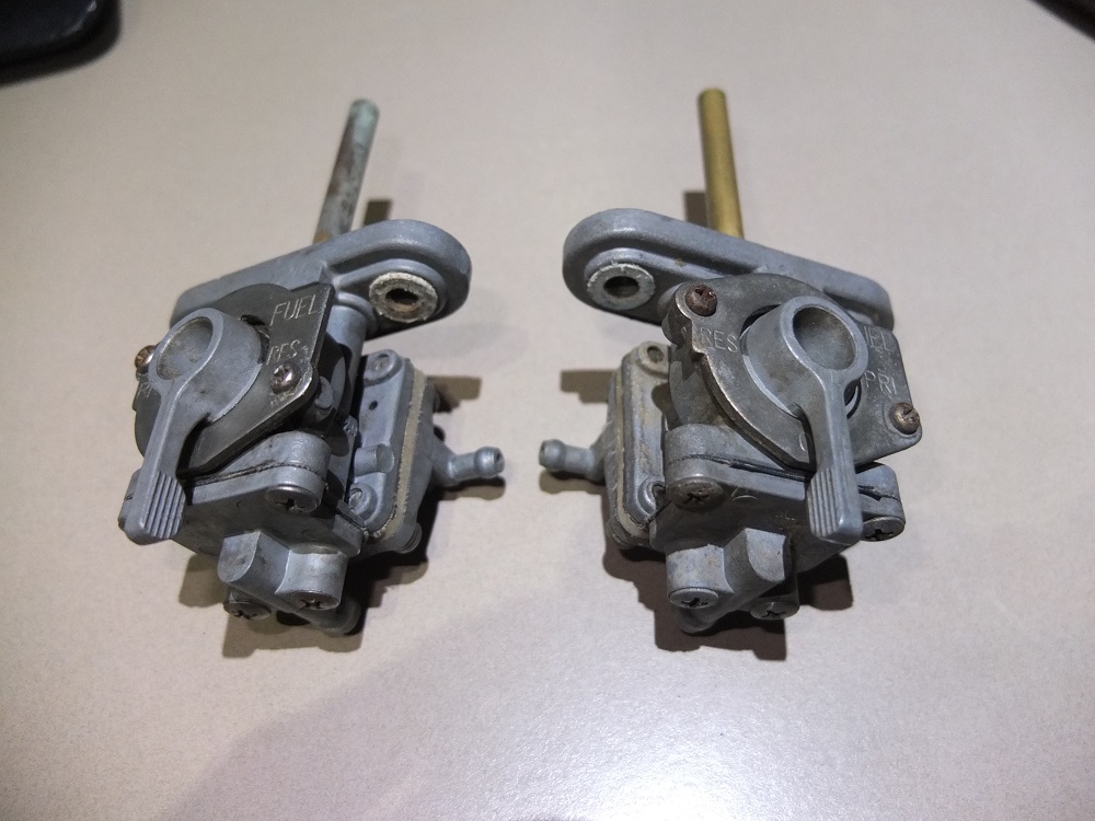

took the plunge and bought an ultrasonic cleaner after reading a NASA research paper.
They are bloody great - petcocks before and then after 10 minutes in the ultrasonic with a little bit of dish washing detergent.

Wow really nice!
is there a reason you stick to the stock petcocks, i heard that the membranes tend to break pretty easily?
I thought about swapping out for "normal" petcocks with on and off function on my project.
I just blank off the membrane part on my taps, and have Up as the off position. One less thing to worry about
The theory wad that the leaking petcocks diluted the engine oil and contributed to the big end failures. I have been using the standard petcocks on the 750 for 5 years without problems. The current rebuild kits appear to be robust. Plus it nice to have original spec. Means one more kick for cold starts though!

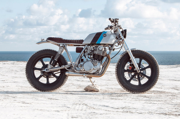

I did find some inspiration though. After coming across the images of the bike below, I have decided that with my leading axle forks, it does look more dirt bike than cafe, so a scrambler it will be. Hopefully it will look half as good as this one by Bunker Brothers in Turkey.
