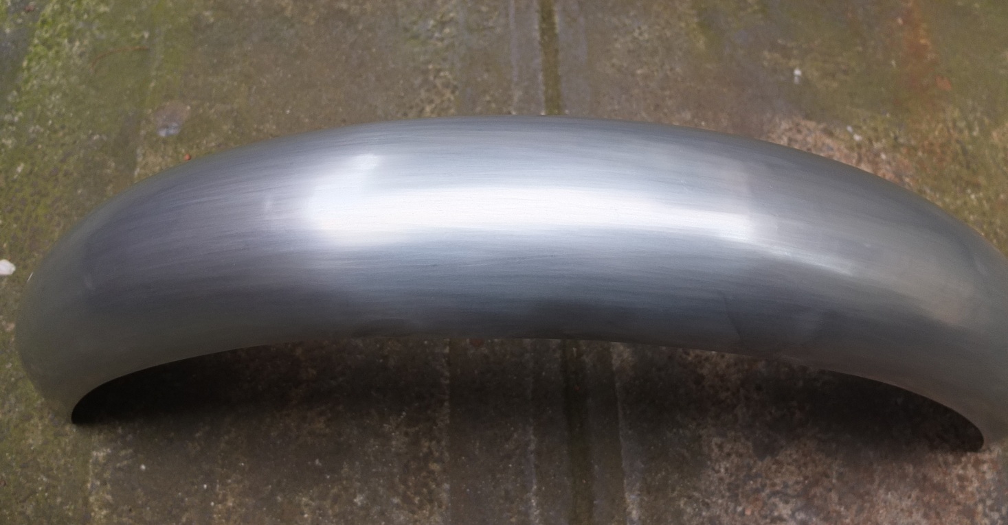

Rolling, rolling, rolling on Saturday. Spent a few hours with the English Wheel starting to make the front fender. Probably spent about 3 hours and have a few more before I get it to match the front wheel diameter.

Then some more rolling -getting close. But I have learnt that if you try to speed up the process by applying more pressure only causes more problems. Slow and steady is the only option.

Impressive work with the english wheel there! You've picked that up quickly! What is your process? You do any sand bag beating or edge shrinking first?
In the end I did not get a shrinker, so it has all been on the wheel. It would probably be quicker if I did use a hammer and bag plus the shrinker. The radius is not quite tight enough yet but another hour I should be there. I have only used 2 different curved wheels to get it done.

awesome work

when you are up against work hardened aluminum sheet, you can anneal it easilly with acetalyne flame
first blacken the metal in the desire areas to anneal,black black as fook with pure yellow flame no oxy
then go and with the torch flame nice and nuetral ,normal oxyweld flame ,pretty gently and evenly heat the black area well back 4-6'' or so ,off the hot cone flame, just keep evenly heating till the black burns off ,it burns off like magic,let it aircool , end result should be way more workable
i didn't make it up its an old panel beaters trick probably the aircraft boys figgured that one out
it works i have used the method with success
Thanks for the advice. Must admit I was a bit lazy with the boring set. I had to clear the clamps, but I could have shortened it up a bit. The biggest error was the cutting angle being too aggressive. 20/20 hind sight ;D
I am in two minds about annealing it - I like the tough springy work hardened condition in the fender to make it more resilient in use. Probably should have annealed it earlier and then finished up with the hard final fender. Thanks for the process, will try it earlier on the rear fender.

1.6mm 5005 H34.
H34 is apparently half max hardness. After all the forming it has work hardened considerably.
