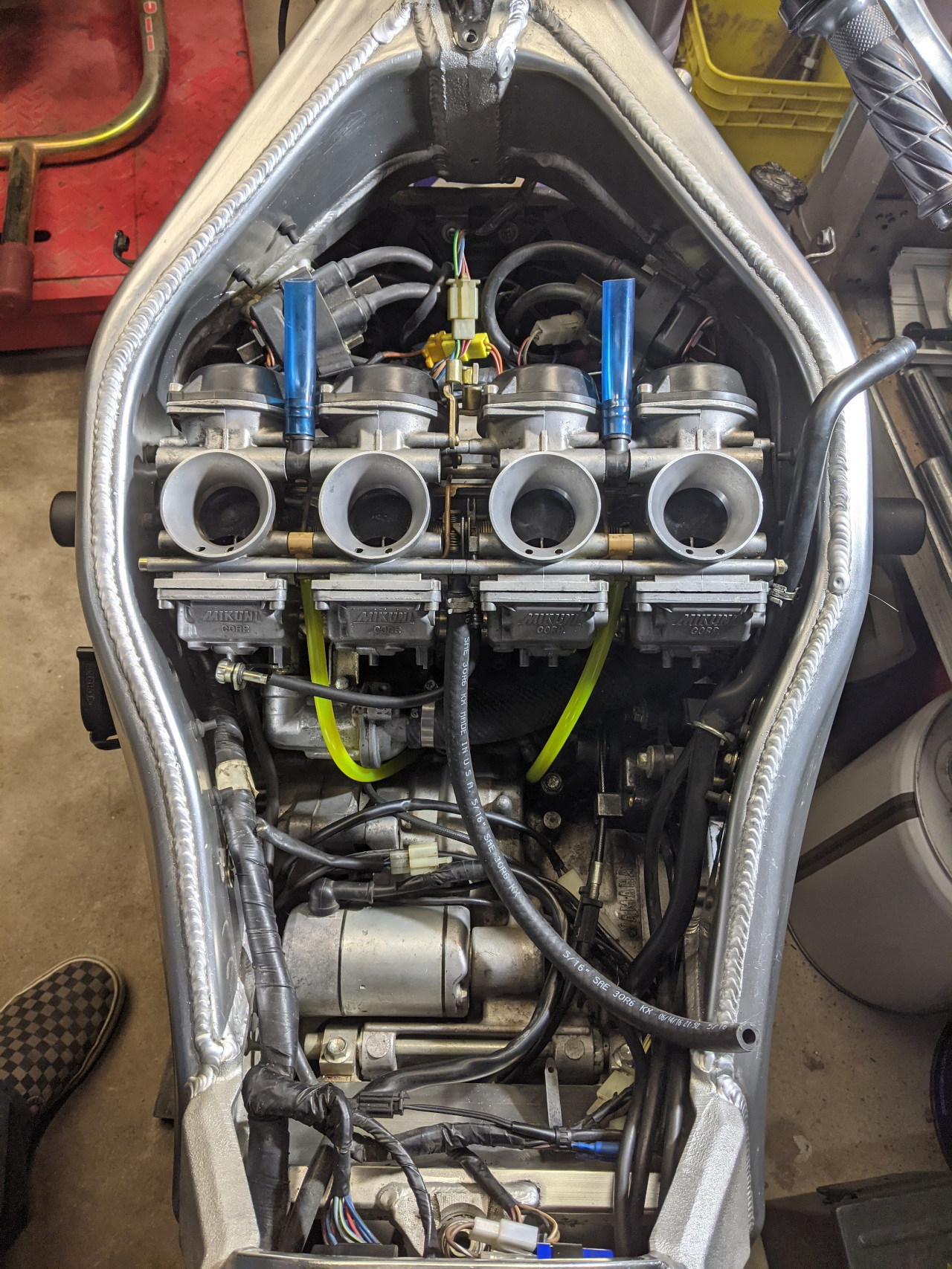

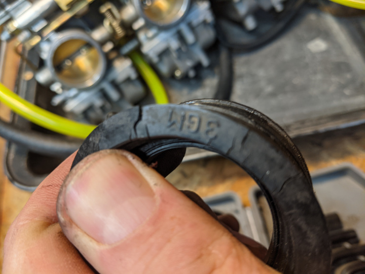

New fuel hose, bowl gaskets, bowl breather hoses, overflow hoses, needles and seats, intake rubber boots, lots of wrestling with hard to reach 3mm allen screws and I'm ready to test with fuel again.
Looks like no more leaks and it's running again after my ham handed rebuild so that makes me happy.

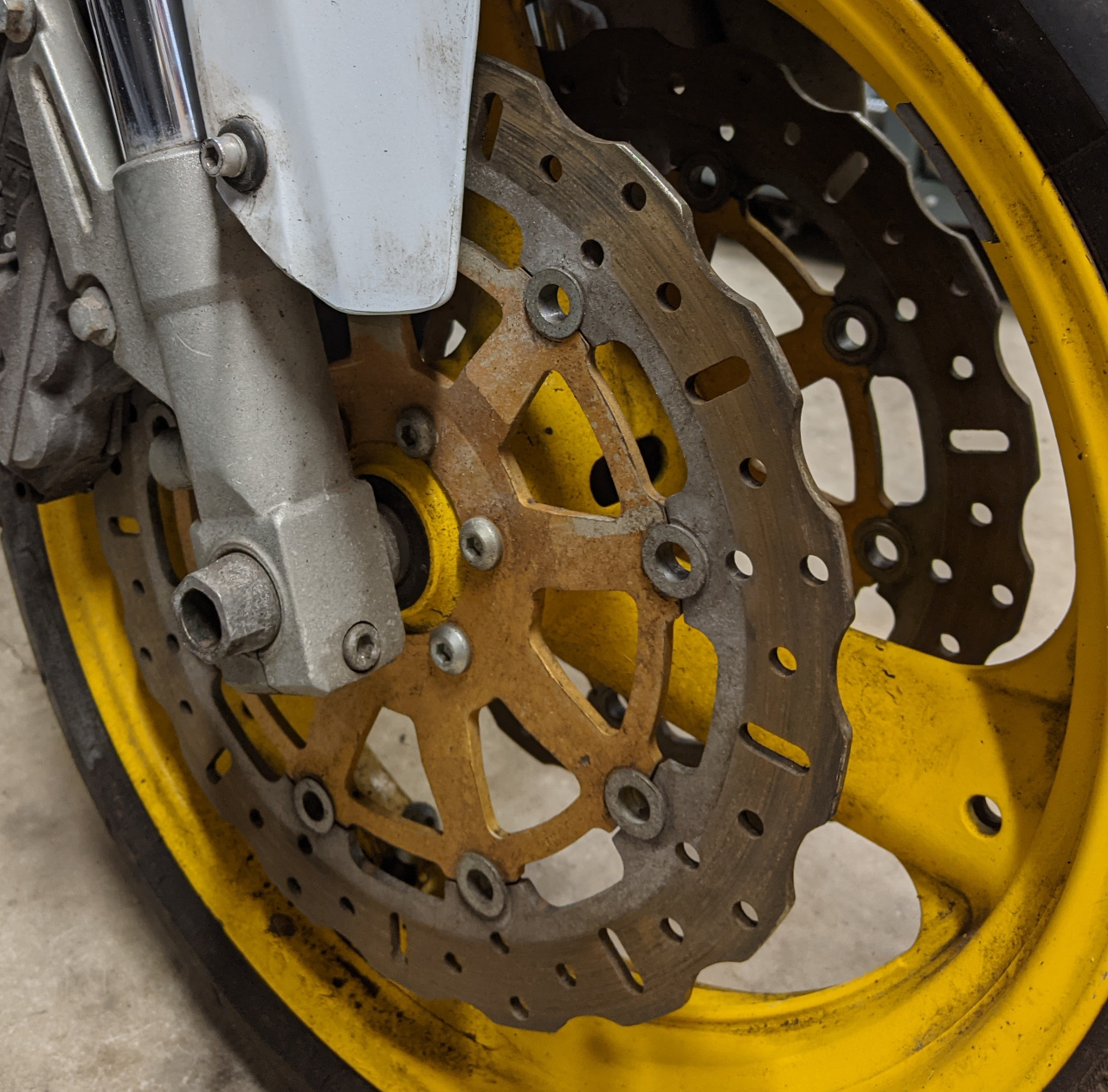

The brakes are nasty and need a complete going through. I've got new HEL braided steel lines and new front rotors inbound next. I have a new rear rotor already. I also have a set of R1 blue spot front calipers which are a nicer and lighter upgrade so I'm going to do the front fork mod to adapt them to this bike. I've seen a neat Brembo caliper swap out there that I might track down for the rear. I'll need to get a chain and sprocket set ordered as well, this set has seen better days.

Just a few pics of the brakes before I go through them.
