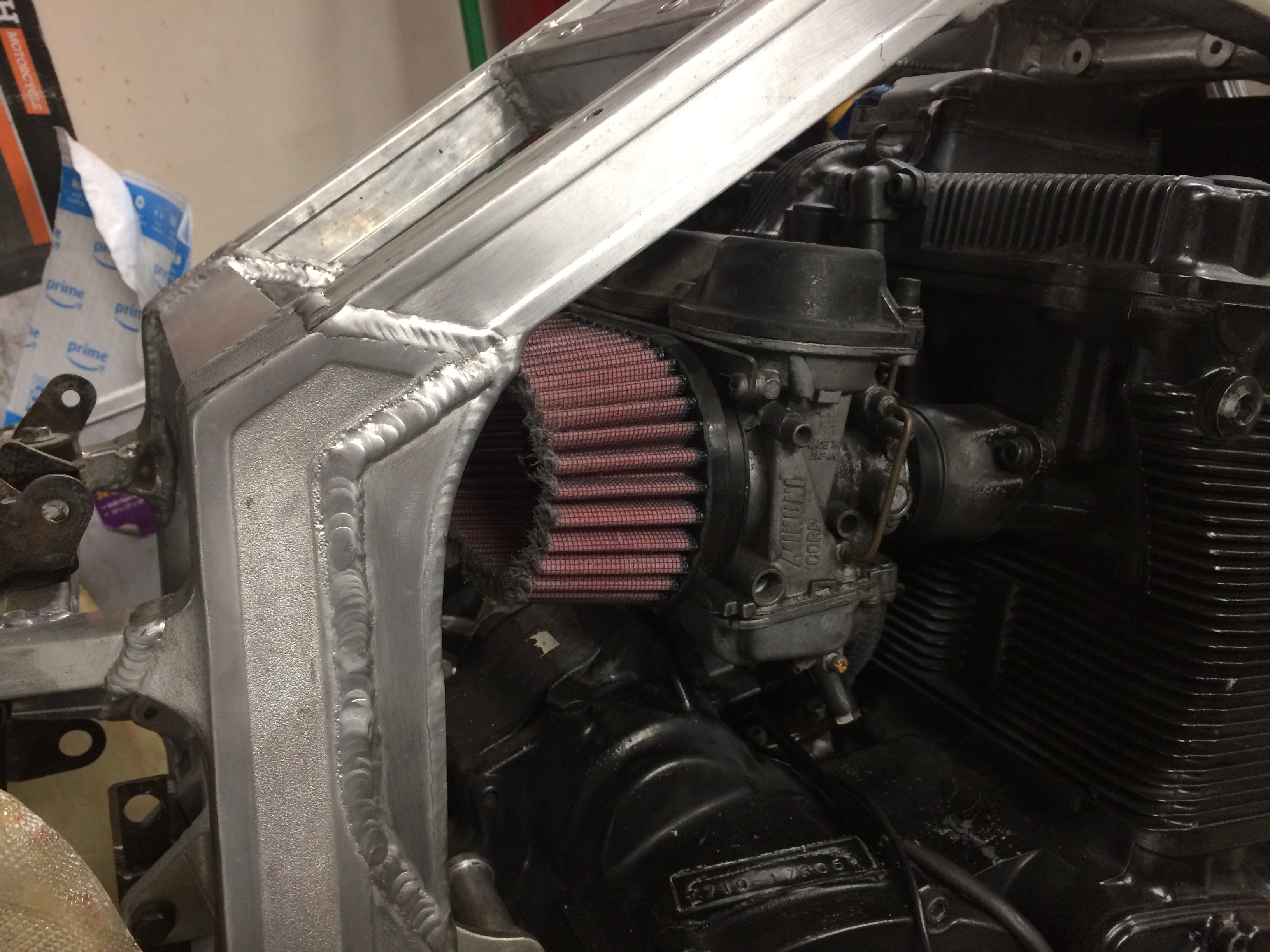

filters trimmed to length. I'm going to make an endcap out of aluminum, but I'm not sure what glue to use. liquid nails?

Epoxy will stick well to the aluminum, just rough up the surface first. Love the work to the frame, should be a great ride with the B12 :)
West Systems G/Flex. I promise you, once you use the stuff you will search for other things to use it on. It's a wonderful plastics repair medium, too. I repaired a fuel leak on a metal dual sport tank 2 years ago and it's still leak free.

3M 08101 Structural Adhesive
Thanks on the tip for g-flex. I was wondering about a glue that is vibration resistant. that will work perfectly.

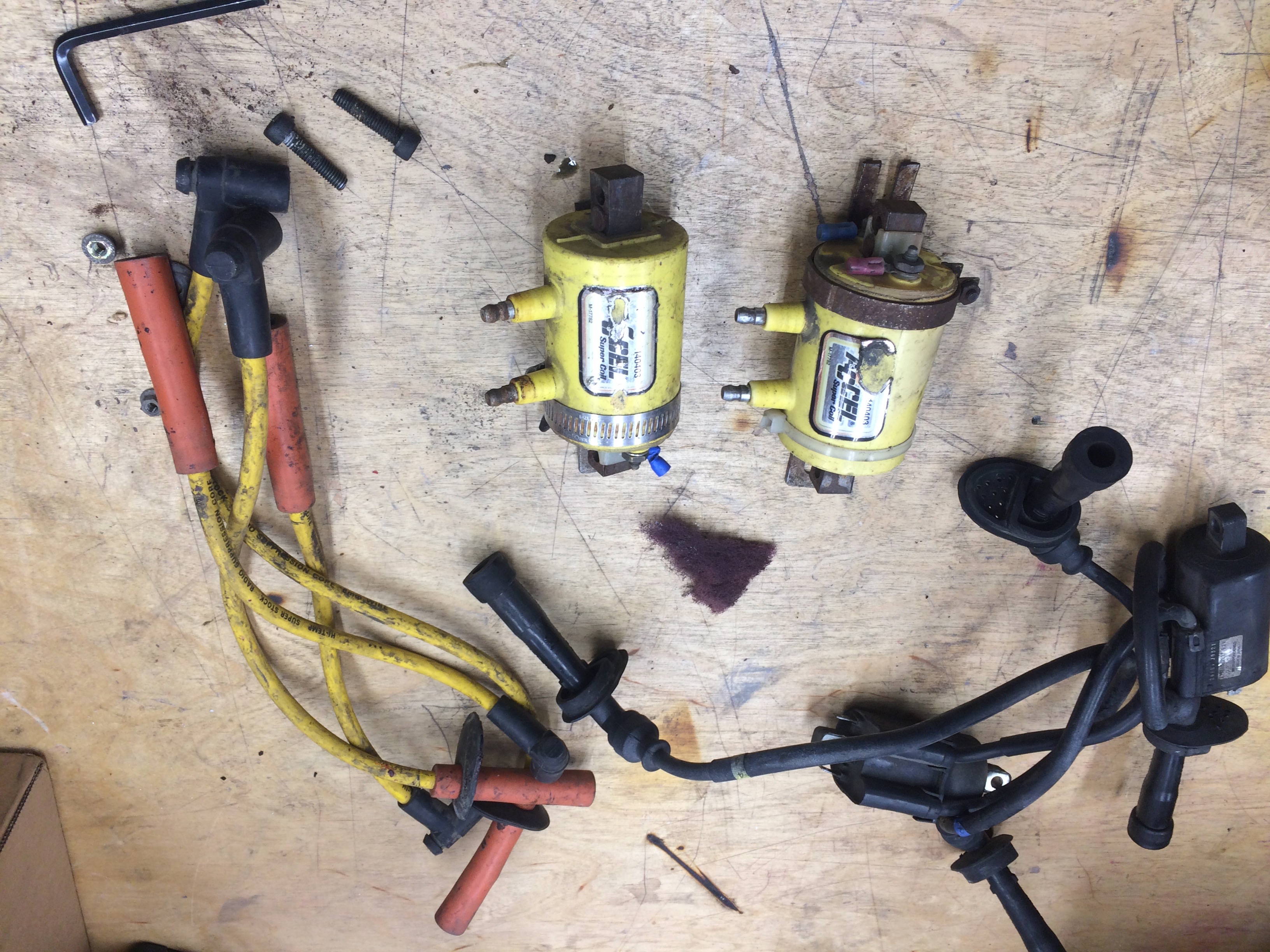

the stock B12 coils appear to be in good shape and have been proven to work. I also have these accel coils, but they need new wires. what should I run?

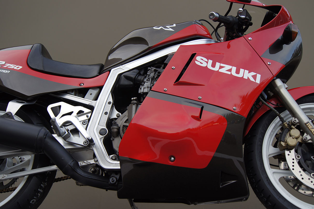

I don't have any pics because its disassembled right now. here are some examples.

Not mine as I sold mine a few years ago. You can see the access hole in the frame about 4” below the swingarm pivot bolt.
