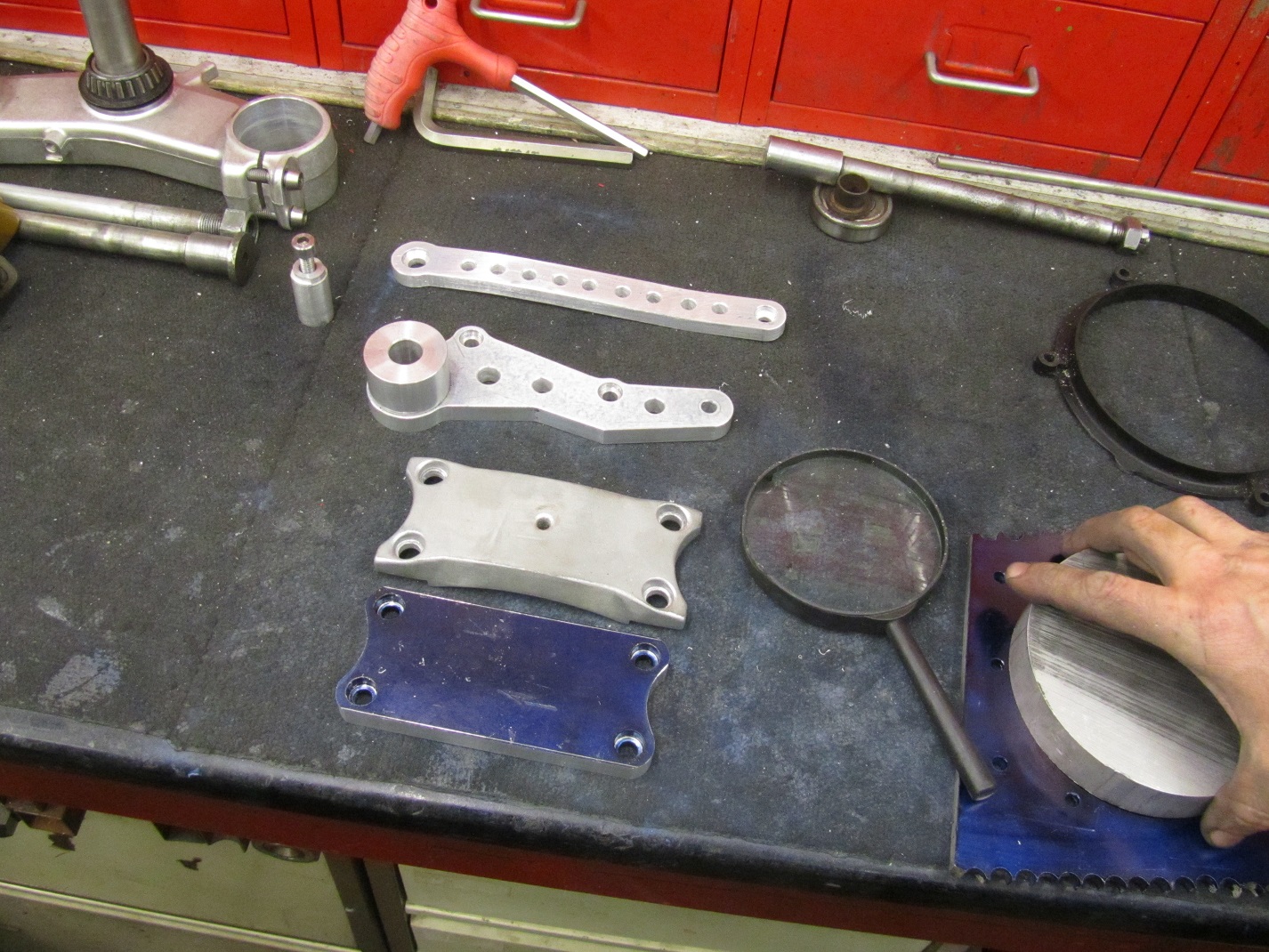

Well, this week has been a good one for the Guzzi, its new billet fork brace has been machined and fits fine, though it still needs more work to make it look better. That all happened today, and I filmed the steps of the fork brace being made, which is now on youtube. Meanwhile my new billet alternator cover has been started too.

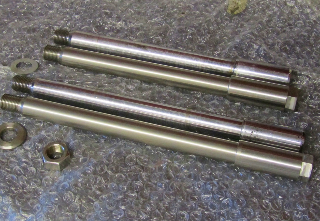

The new stainless spindles (for which I've been waiting months) have been machined on a CNC lathe, and now the machine shop have written the program, they could churn out hundreds a week... pity mine are not standard, I designed in a couple of extra features. By chance I happen to be passing by on the afternoon they were being made, so I got to see the first one being made, got a video of it too, though I wont post that until next week when I collect all those parts.

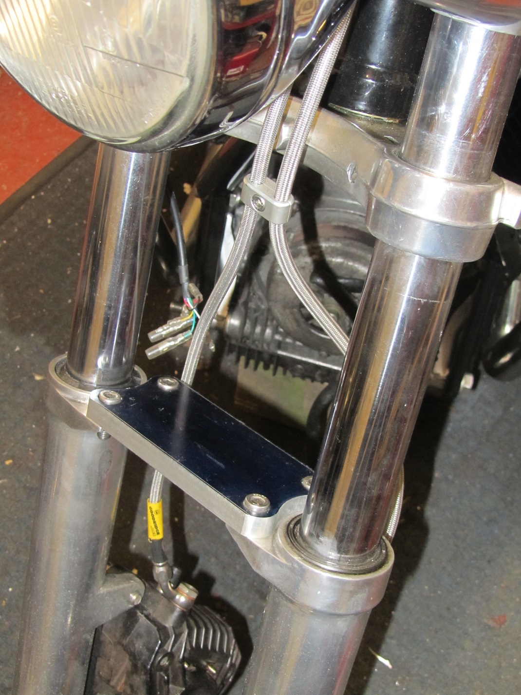

I took the new fork brace home for a test fitting, and thankfully it did fit ok, but it definitely needs more work to make it fit into the style of the front end, and particularly the yokes. As it is now, the brace is too angular and plain.
The next day I collected the new alternator cover, which has been machined from a solid piece of billet alloy. Its also not finished yet, but I took it home to check it fitted onto the engine, before anymore work was done on it. At first it didn't fit, as I' measured the diameter of the alternator outer case wrong, but with a bit of filing, the cover went on and its mounting holes aligned with those of the engine case, which was a relief. That cover will be going back to Jeff's workshop next week for more machining, this time on the outside to make it look better.
And there's a couple of videos of all this on Youtube too, an one of my new wheel spindles being machined on a CNC lathe.. :)
