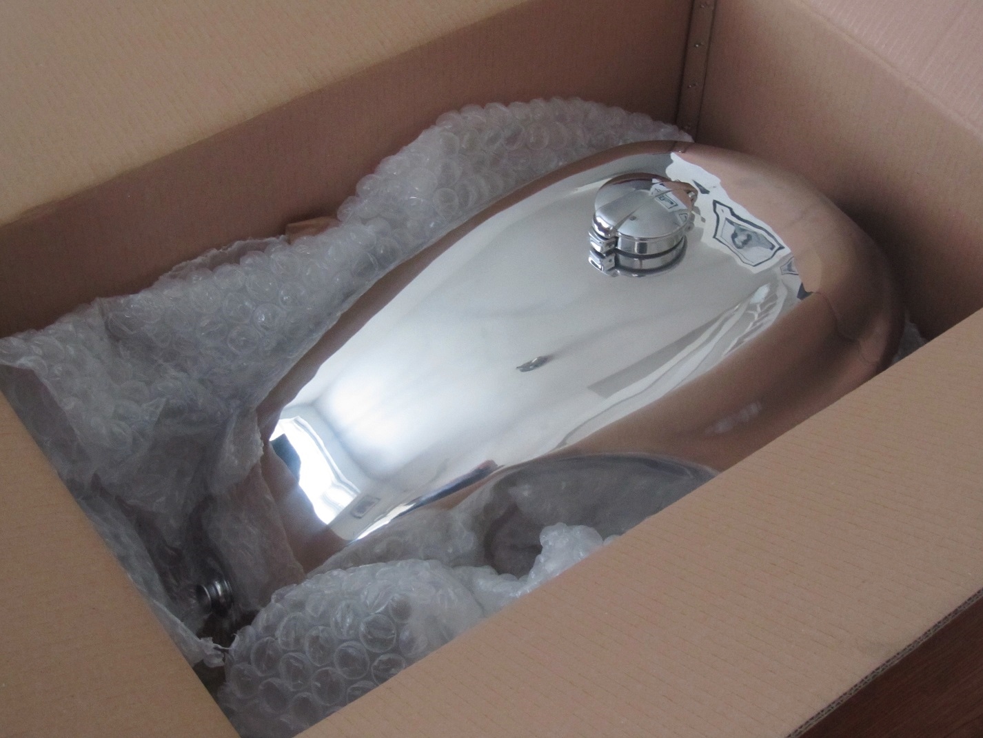

Back to the Guzzi... a big day today, a parcel arrived.... like a kid on Christmas morning, it didn't take long to open it and see its contents :)
My Endurance racing alloy tank had arrived from TABII in Wales..

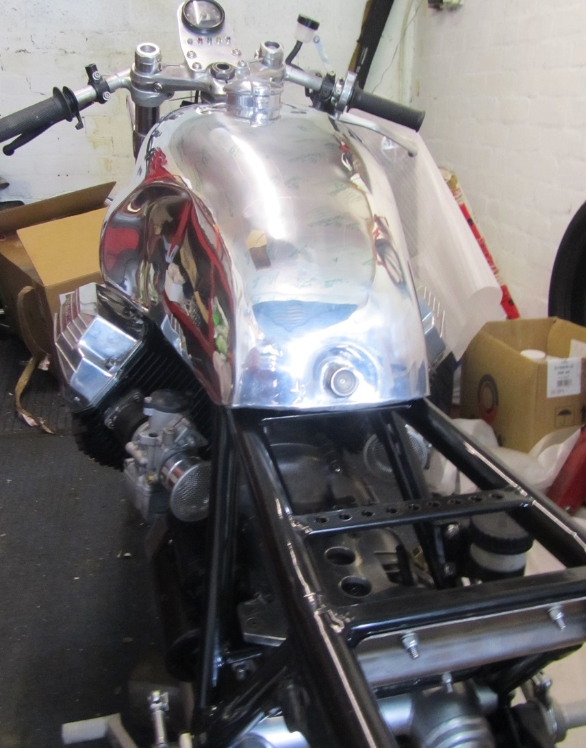

Fitted the frame no problem, just need to sort out a rubber strap for the rear mount.. very pleased with it..
Shall I paint it, or leave it polished? decisions, decisions...

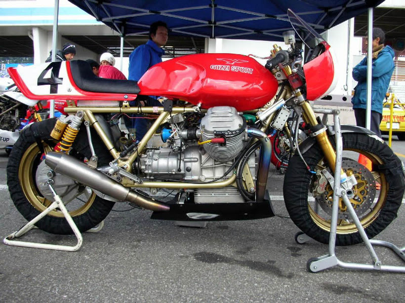

Also have to decide on what style of seat to go for, its a tricky decision as there are half a dozen options I'm considering. One complication is that the seat rails of the Guzzi Tonti frame are very low, so any seat unit will have to sit an inch or more above the seat rails. It wont be easy to get right, without it looking awkward, or resorting to a thick foam seat, which may be comfy, but not look the part ..
See how these race bikes all have their seat units mount way above the frame..

Folks will vehemently disagree, but polished aluminum has been done over and over... For Jebus Sake Pain it!! :o
I agree. Paint it. Maybe incorporate some polish into the paint - like knee indents or a stripe.
Its probably going to get painted, polished alloy looks good when its new, but its so delicate, soon gets scratched and marked and takes a lot of tlc to keep it looking good. As suggested I may keep the knee cut outs unpainted. As for the colour..it'll have to the colour of speed... red, very red..
Paint it but leave some polish. Give it a good top coat to save it from the elements. You've got a great base to do polished pinstripes or a racing stripe.
I'm not sure how well clear lacquer will stick to polished alloy... I've had conflicting opinions, though some of those ma be out of date concerning modern paints?
Personally, I would leave the tank unpainted.
It will dim and get scratched, yes... but that's only scars of a well-used motorcycle and shows it has been ridden.
On the other hand a big alloy tank is very dominating to a relative small bike like the Guzzi
If you can't live with it why not paint the knee dents only - black maybe? They may be the most exposed parts for scratches and will give some nice contrast.
Just my 2 cents...it's a beauty anyhow if you decide for paint or not
