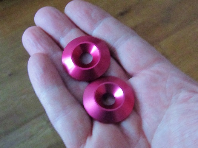

On a smaller scale...I was given a few panel washers recently, they're cheap now on ebay, these were anodised an awful pinky red colour.. yuk. I wanted them bare and polished, but rather than faffing about with fine wet and dry, I went the chemical route. 60p got me a 1kg bag of caustic soda, mix a tablespoon in some warm water, pop the washers in, and wait a few minutes. The result being the anodising has been magically removed, just need a quick polish and they're ready to go on the bike..

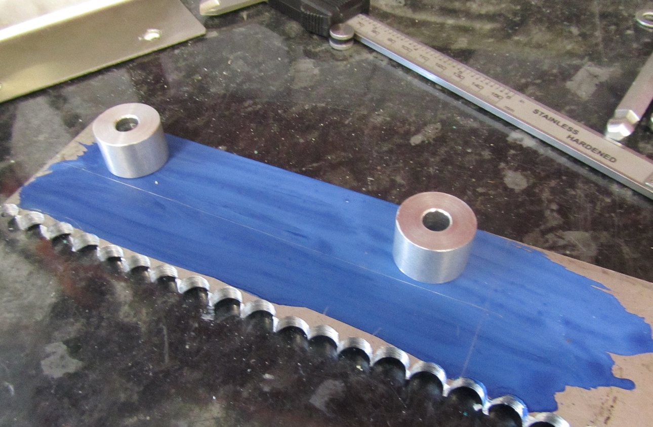

While the middle mount, is just a support, it doesn't need to be fixed to the seat, which makes life much easier. I haven't finished it yet, it consists of two simple alloy spacers and an alloy plate on top which will be bolted down to the middle frame bracket with a couple of countersunk bolts. I just need to add a washer or two to raise the support plate as needed.. well that's the plan, oh and I'll stick some neoprene to the alloy plate to cushion the fibreglass base too.
