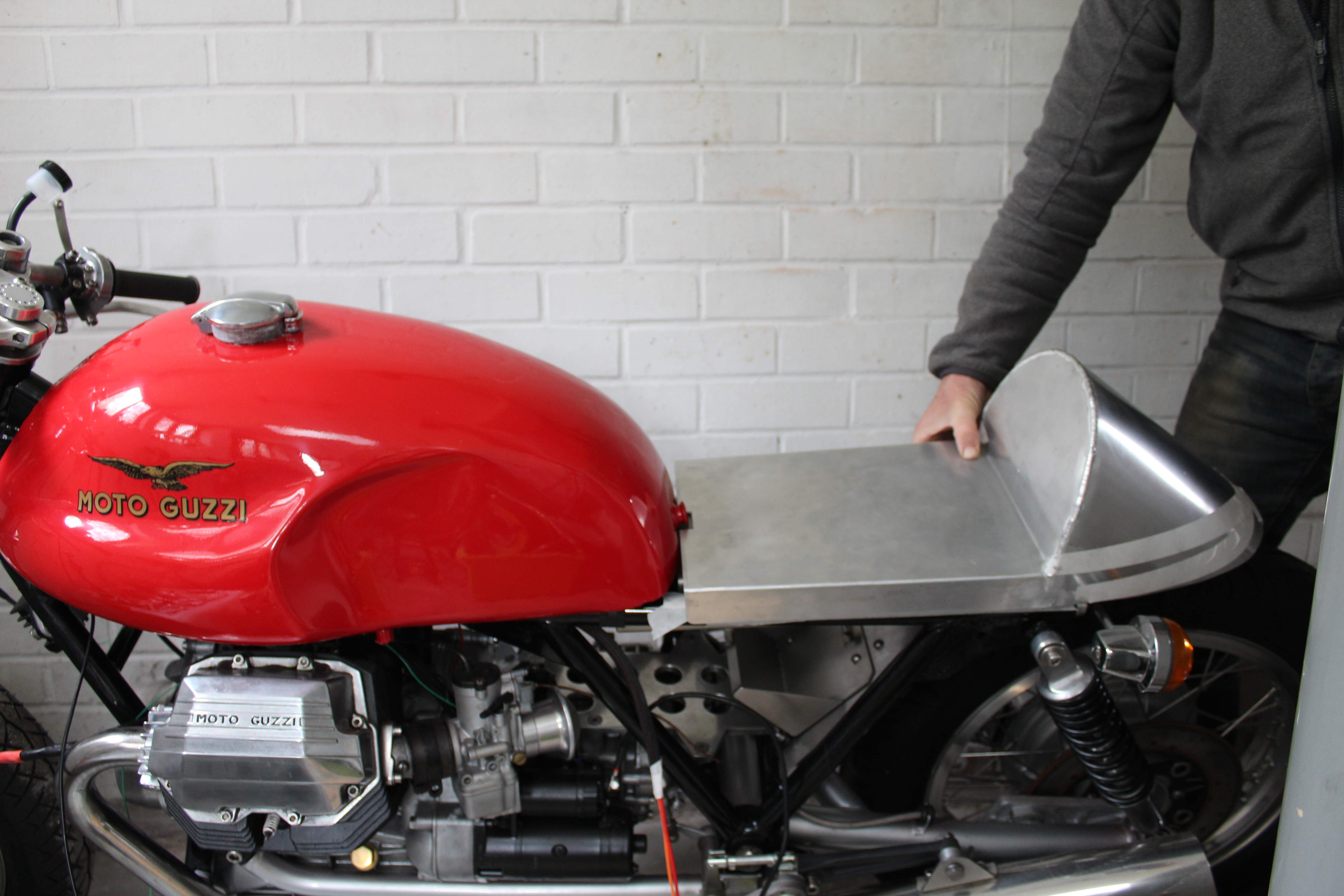

I prefer to work in metal than fibreglass, much less messy, and in this case it took less than an hour to make the seat. Also I've always found fibreglass by its nature needs a lot of filling and sanding to get a smooth finish. Much less so when working with steel or ally.
Here's how it looks on the bike when I was measuring what height the mounting brackets needed to be, though still haven't shaped the lower edge of the rear of the seat yet.
