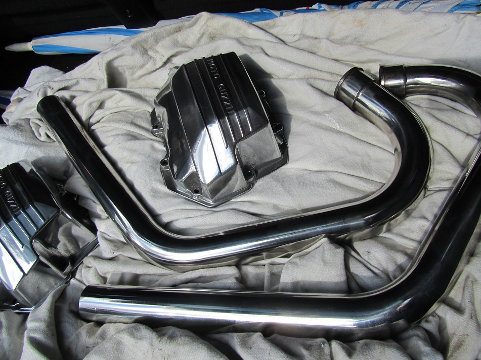

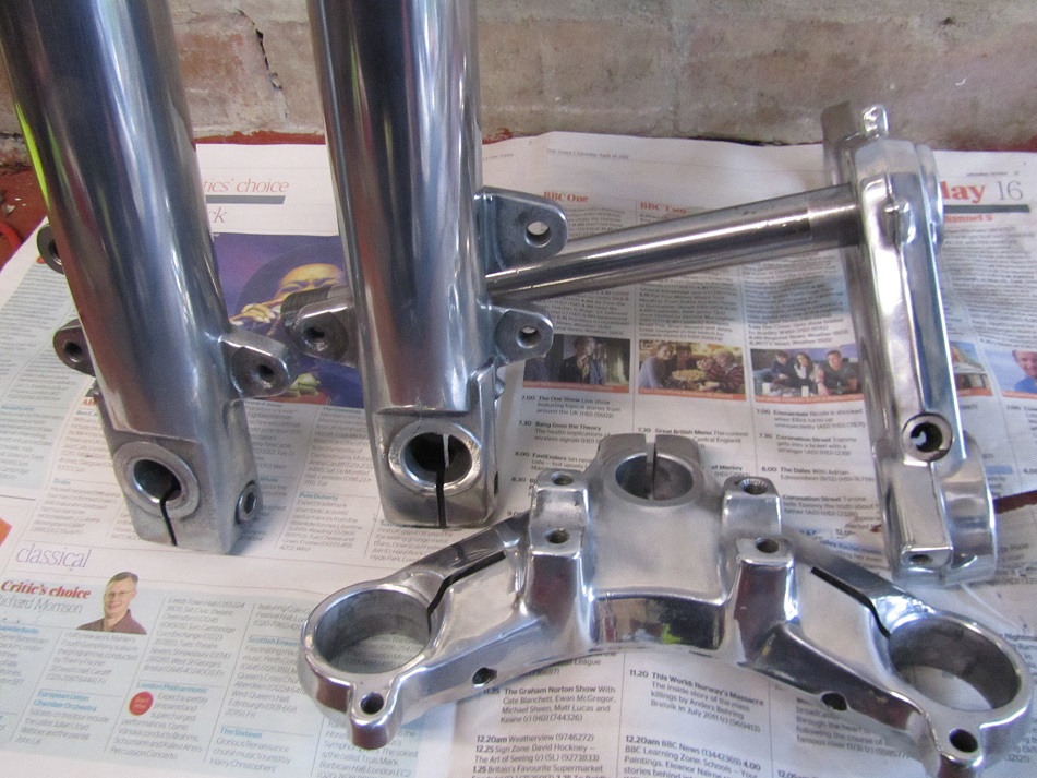

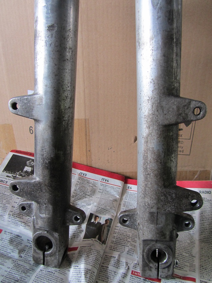

Now its back to yet more polishing... the yolks (Triple trees)and stanchions needed a days work.. I was going to polish out the casting seams too, but decided to get a life instead..
And the rocker covers, stainless downpipes, headlight brackets.. on and on, lol

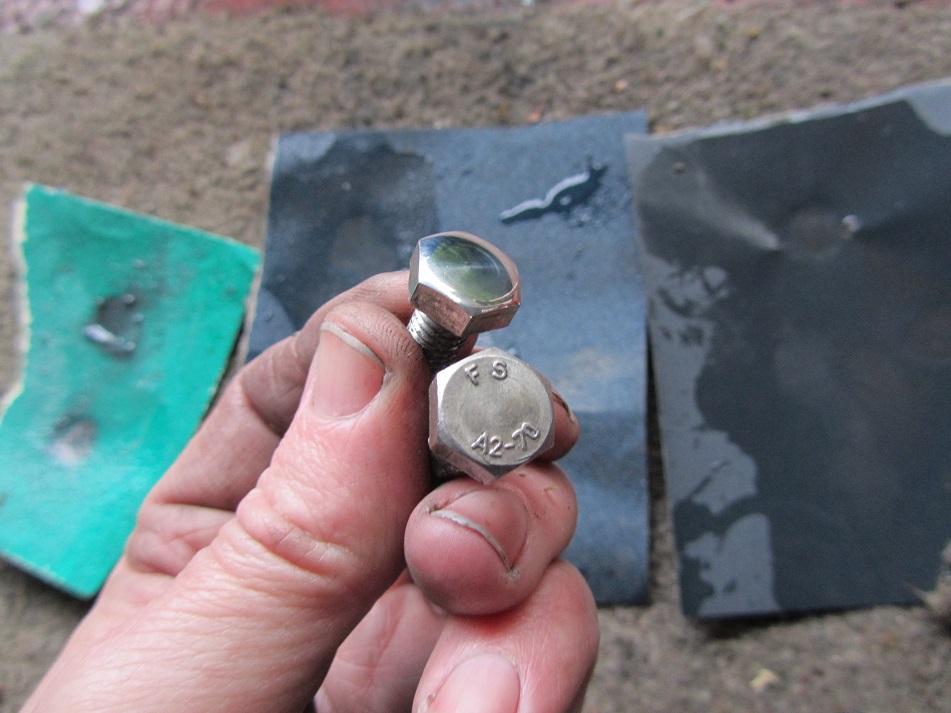

And even more polishing.. used my drill and wet and dry sand paper to clean up the heads of stainless bolts.. simple but it works..

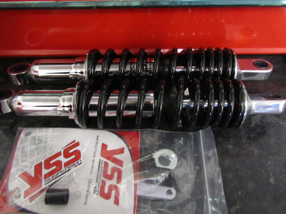

With the forks polished, I went to my mates bike shop and picked up a bottle of 15 weight fork oil and asked him to give me a price on a pair of Hagon shocks. I'd looked at various options for rear shocks, from cheap and cheerful Hagons through Ikons to Maxtons (£550 for a custom made pair), right up to Ohlins which are now over a grand for their basic set ! I did have a mint set of original Konis which were the right length, but the lower mounts were completely different, so couldn't use them.
At the bikeshop, I was asked if I'd considered a set by YSS ... who?? I was handed the catalogue to browse, and they didn't look bad at all, erm, but were they just some cheapo chinese copy?? Apparently not, they make components for some of the big name brands and are now being assembled in the UK to your spec. They'd sold a few already at the shop and had been impressed with the quality, the clincher was the price, less than the basic Hagons... so I ordered a pair, be here next week. Here's a link to the company.. http://www.yss.co.th/
They arrived soon enough, and despite the low price they looked to be good quality.. wasn't long before the Cali was back on its wheels at last..

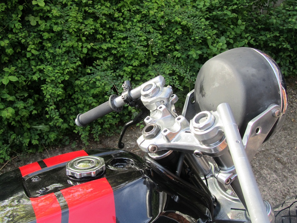

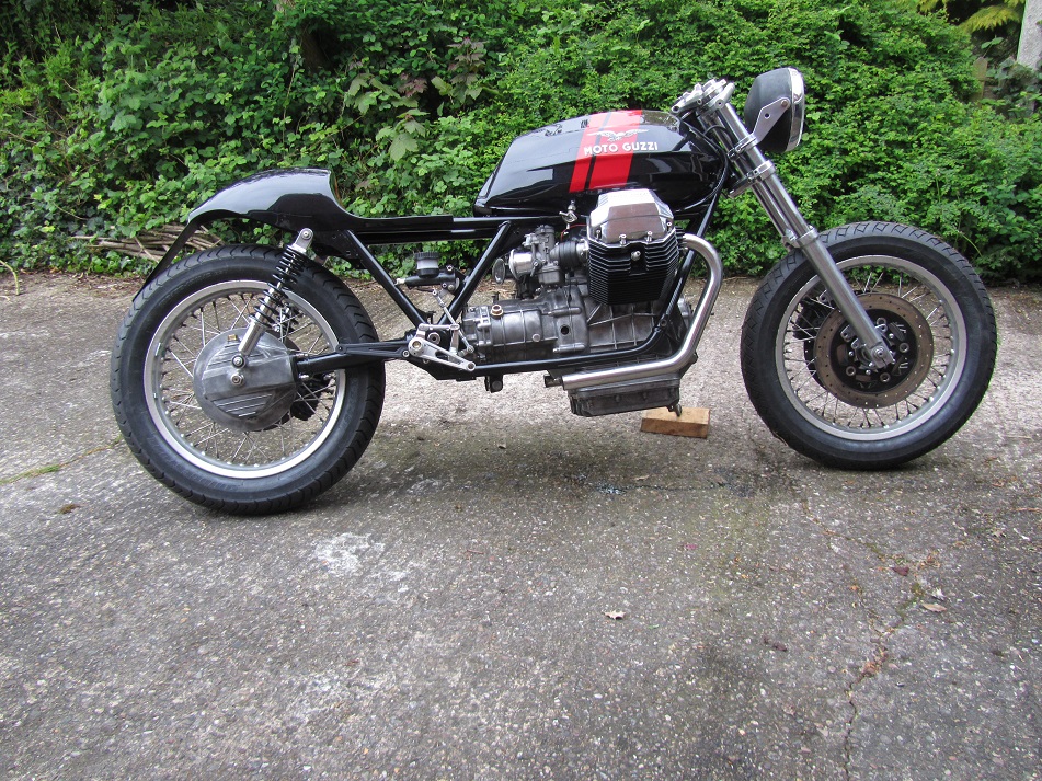

That seat will have to go.. Notice how the forks look too long, not sure why, but it gave me the chance to drop them and fit the clip ons above the top yoke. My damaged shoulder will thank me ..
So far this thread has been about tidying up an old bike, soon things get a bit more interesting.. time for a tea break :)

I love this build. You're doing exactly what I am and getting everything clean/polished "enough". I'm not going for perfect but if it is then great. I'd rather ride than show and it won't stay perfect for long. Thanks for the drill idea for bolts.

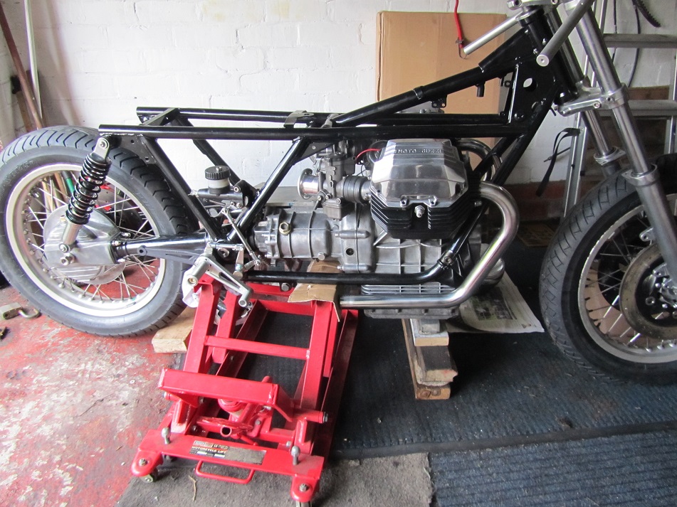

As for Guzzi, the To DO list seemed endless, but at least the bike was on its wheels now, and I could see clear progress..
New oil lines for the engine..
Checking the cam chain tensioner, I bought an aftermarket tensioner, but didn't need it..
Cleaning up the calipers.. stainless pins would've nice, but I may upgrade the calipers for more modern 4 pot Brembos, not sure yet,so I just rebuild these for now.

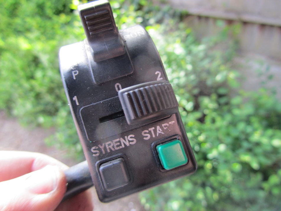

I tried to rescue the throttle, as its integrated with the switch gear housing.. a weird design, but it is Italian ;) In the end I couldn't save it, oh, and I'd like 'Syrens' too

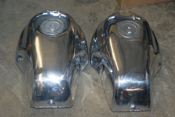

I haven't stopped, just paused while I work on the Ironhead/Norton. I don't have the space or money to work on both at the same time. However, I can still think about the Guzzi. I'm going to get a V7 endurance style tank for it. Need to choose between fibreglass or the more expensive alloy tank? The alloy is about a third more expensive, it'll be painted, so not sure if its worth the extra cost?
Glassfibre, with the period correct clear strip for checking fuel level..or Alloy

I'd go with the alloy tank any day. Particularly so if the price difference is 30% up or so (provided your pocket can handle it...)
By the way, the color scheme you rejected (red frame, lime green bodywork) is very Guzzi (and very very V7)... just saying, since you're going to build a V7 replica. What color scheme do you have in mind?
