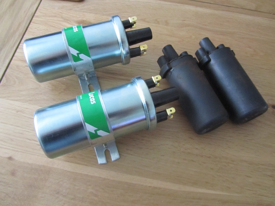

With my Norley project nearing completion (famous last words :) ), I've started on the Guzzi again. I'd cut off the original coil mounts on the frame, they lived behind the lhs side panel. I designed a complex bracket to be made in alloy, only to find that one of the coils got damaged somehow since last year, and now had a cracked casing. Not a good start
A few minutes research showed that a Lucas coil (used in many old Brit Cars) would work on the Guzzi, while being very cheap and easily available, so I bought two. They are a little bigger than the originals, but not by much, not sure where I'm going to mount them, but probably under the stainless electrics tray, in front of the rectifier, that would keep the wiring neat and out of sight
