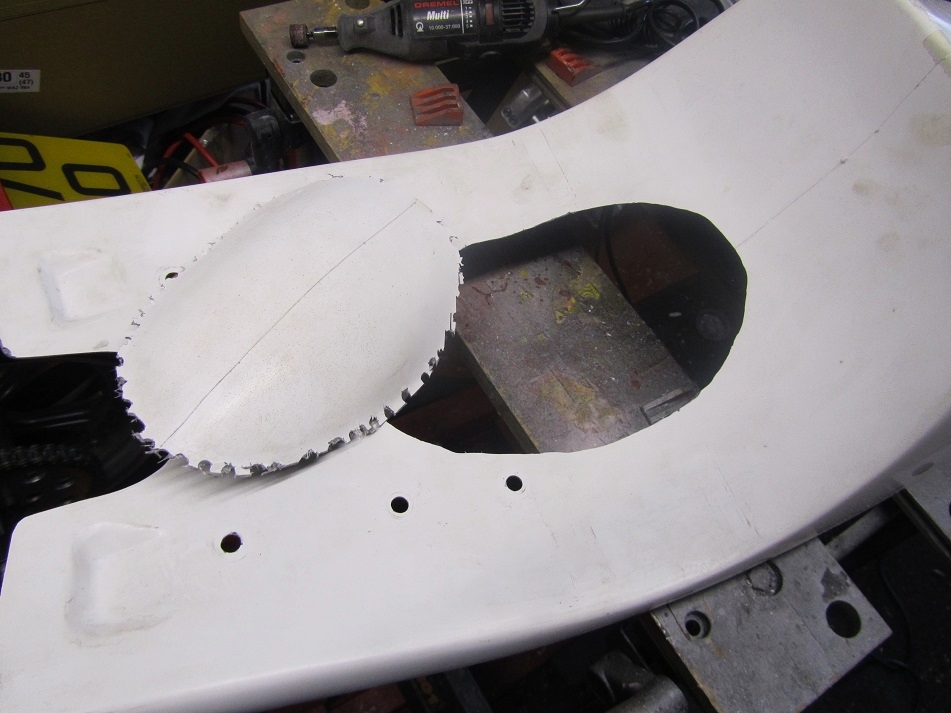

But first the lump moulded into the Rickman seat unit had to go, it didn't take long to cut it out, I'll fibreglass over the resulting hole later. To lift the seat a bit without welding brackets on the frame, I cut up an old foam floor tile and sandwiched and inch or so of the foam between the underside of the seat unit and the stainless plate I'd made ages ago to strengthen the seat. This lifted the seat unit just enough..

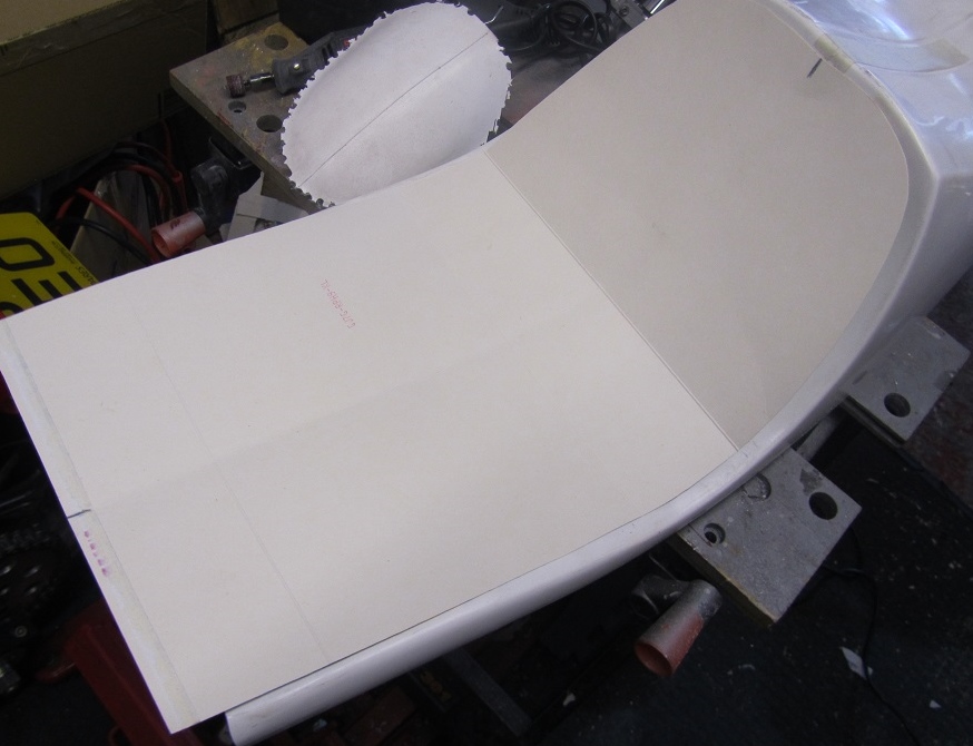

Then on to the seat itself, as usual I made a template in card and had it replicated in steel by Geoff the welder for £25, after which I decided to add an extra piece to run up the back of the box like tank, similar to an early Lemans. I'd like to use an alloy endurance tank, but that will have to wait..

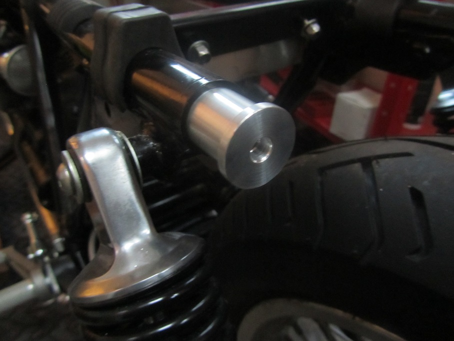

I want to use a lithium battery on the Guzzi, hiding inside the seat hump which would need to be mounted to the frame somehow. While the seat unit itself would need supporting too, all without welding any extra brackets to the frame... :P
soooo I had an idea ...make two threaded bungs, slightly tapered for a very tight interference fit into the back of the frame rails (which had been cut and shortened when I had hacked up the frame back when I first started this project many years ago..)
They don't quite fit as is, but they're in the freezer overnight and hopefully with a big hammer they'll fit securely into the frame rails tomorrow. If that works then the battery mount can be made to bolt to these two threaded bungs..

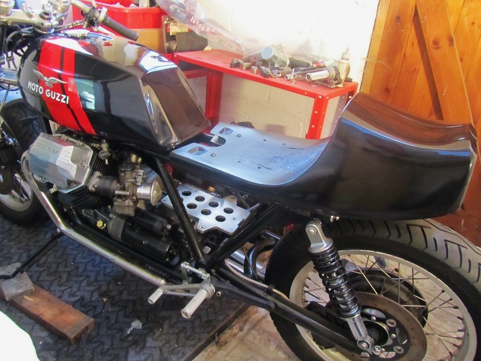

Anyway, back to the Guzzi... I collected the seat today, still need to bolt everything down to the frame, but it looks ok and feels comfy enough at first sitting, cost £60 which is good value I think. I could've opted for coloured stitching or fancy panelling, but decided to keep it simple.

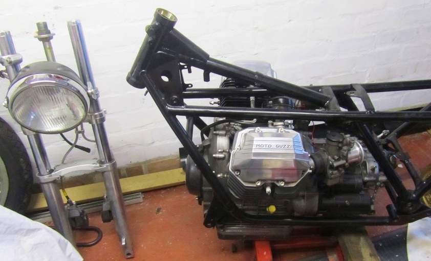

I made a start today stripping the bike down, got most of the work done, just need some help to lift the frame away from the engine. Its not heavy, but the engine / gearbox isn't too stable on the lift, so better safe than sorry.

That's a cool bike. I'd like to see a 90 degrees side profile picture. Those angle pics make the rear cowl look huge.

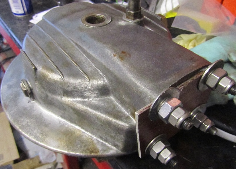

That done, and after a well earned tea break, I made a start on one of the improvements I wanted to make. The first step was to make a simple plate to protect the bevel box when its bead blasted to clean its surface. I'll need to go and buy a nice cake as a bribe/payment when I go to the local machine shop where they'll hopefully let me use their blasting cabinet.

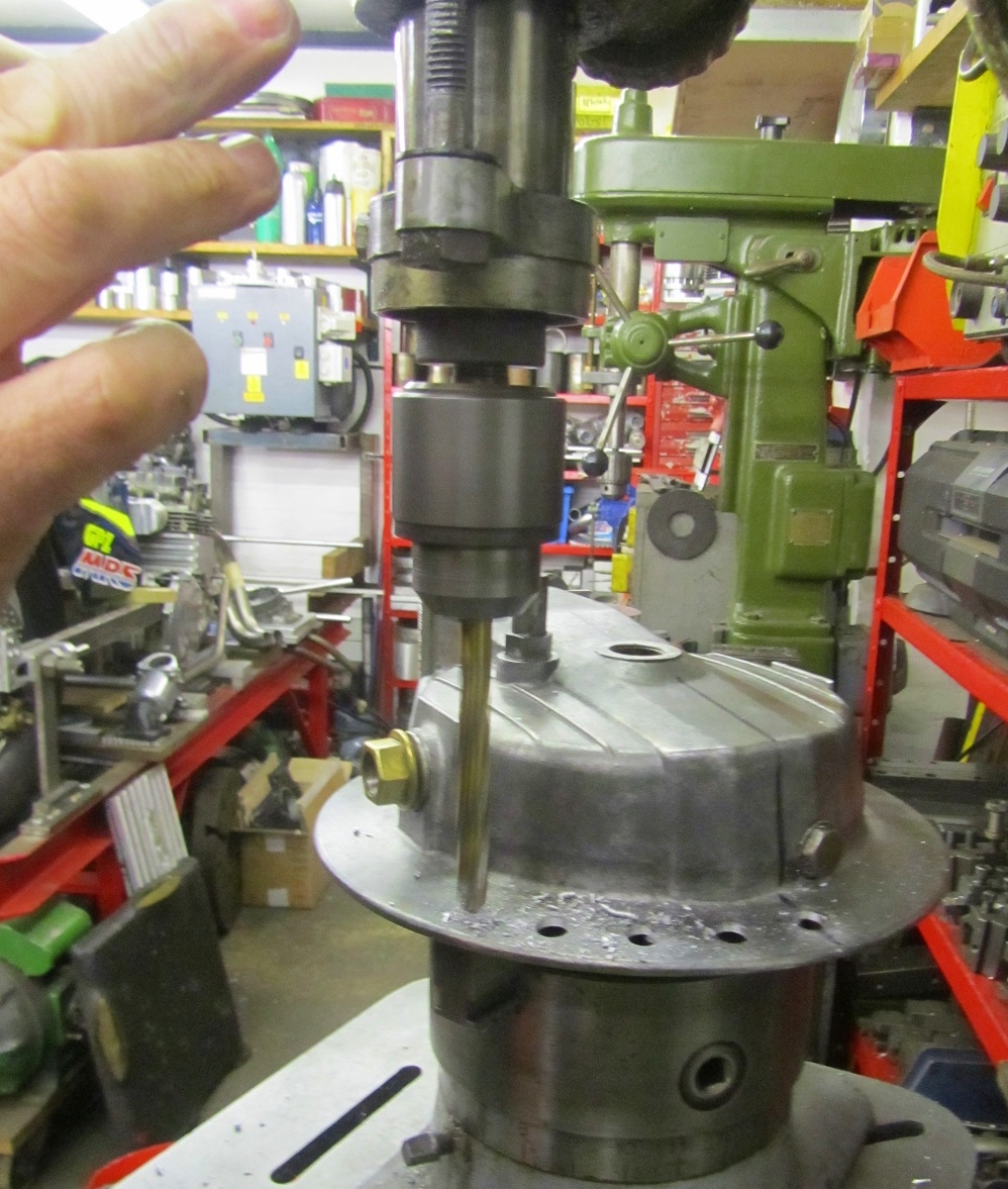

I took the bevel box over to my mate Jeff's workshop, where we just managed to secure its underside to a small rotary table (very useful bit of kit) then we got artistic with the pillar drill...
Like this.. though the current tank and seat may not make the rebuild..

I find the look a bit plain and boring to be honest, the Mark 5 Lemans tank wasn't one of Guzzis finest efforts. I'd be happy with an earlier MK1 or 2 tank, but they're rare and expensive now, so I'll probably end up having an Endurance racing alloy tank made, which in turn will mean a different seat, new paint and much expense..

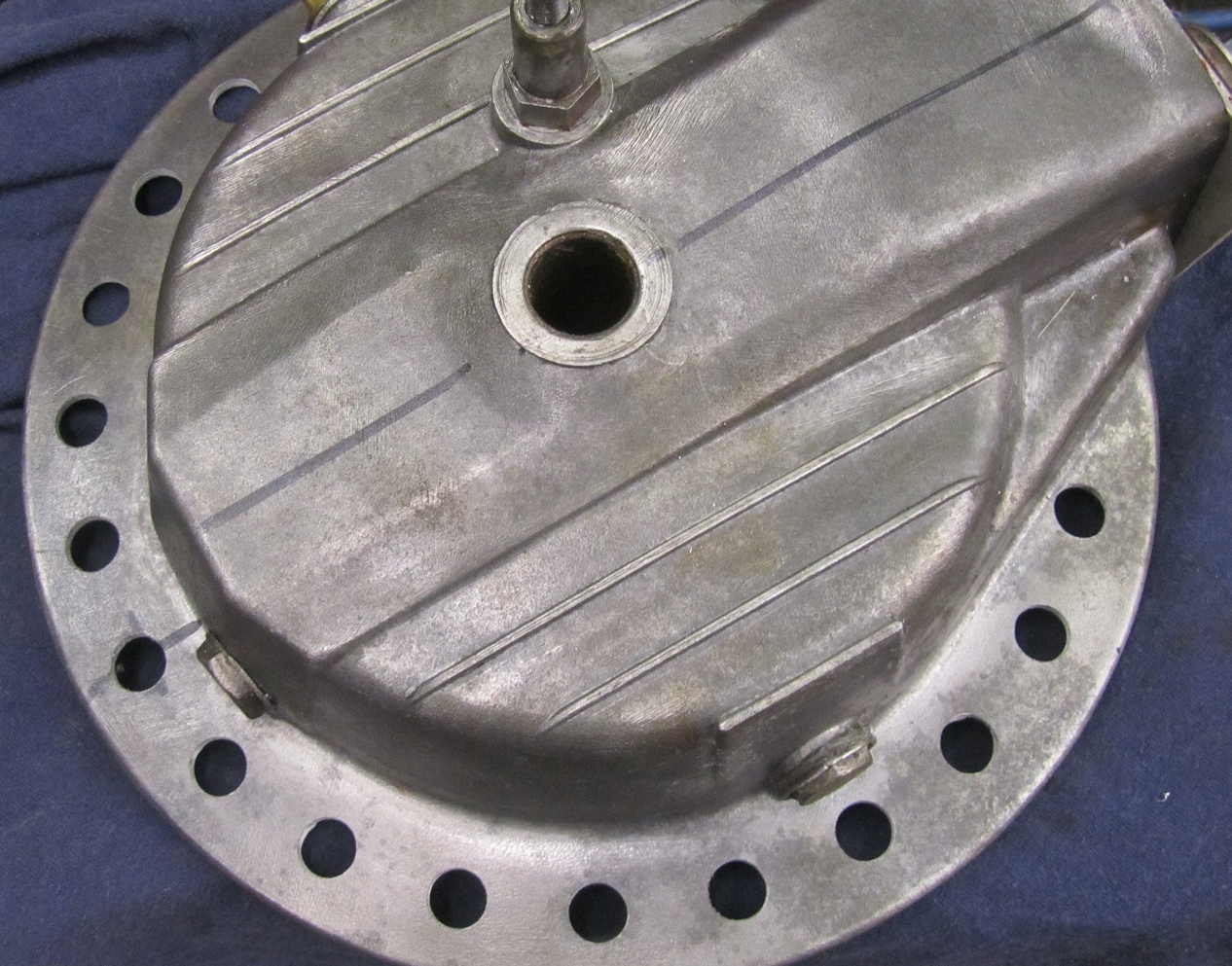

In the meantime, I bead blasted the bevel box and caliper mount at a local machine shop, they look much better but they'll need to be painted to stop corrosion, so the next task is to buy some suitable paint.. etch primer, primer and silver alloy paint. Don't know what brand to go for, need to do some research before ordering..
