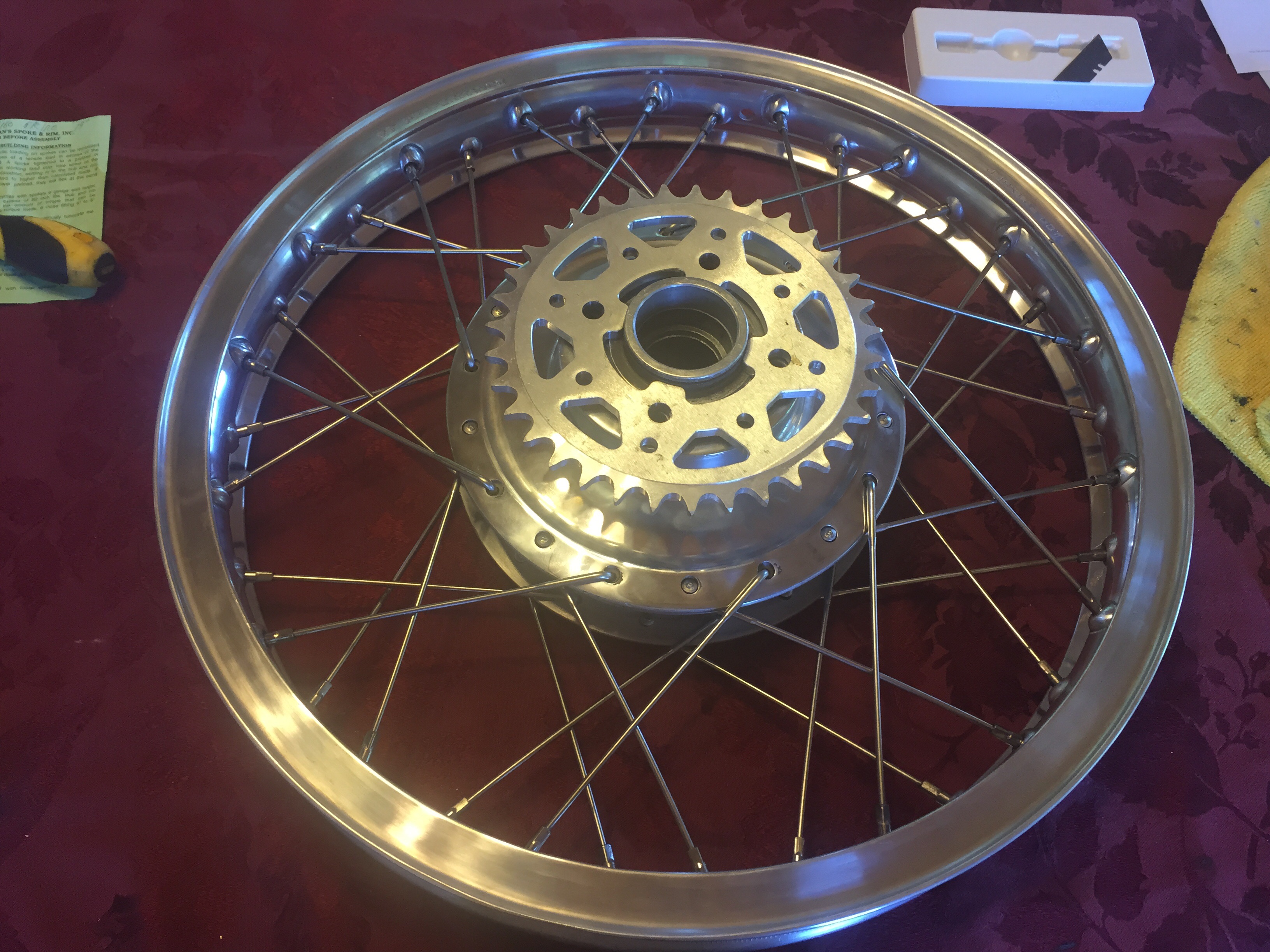

Cb160 hub to a Mike's XS 1.85X19" Buchanan Stainless Spokes. Zeke and Mom laced.

Forgot to give a shout out to PMPsprockets for the aluminum rear sprocket!
