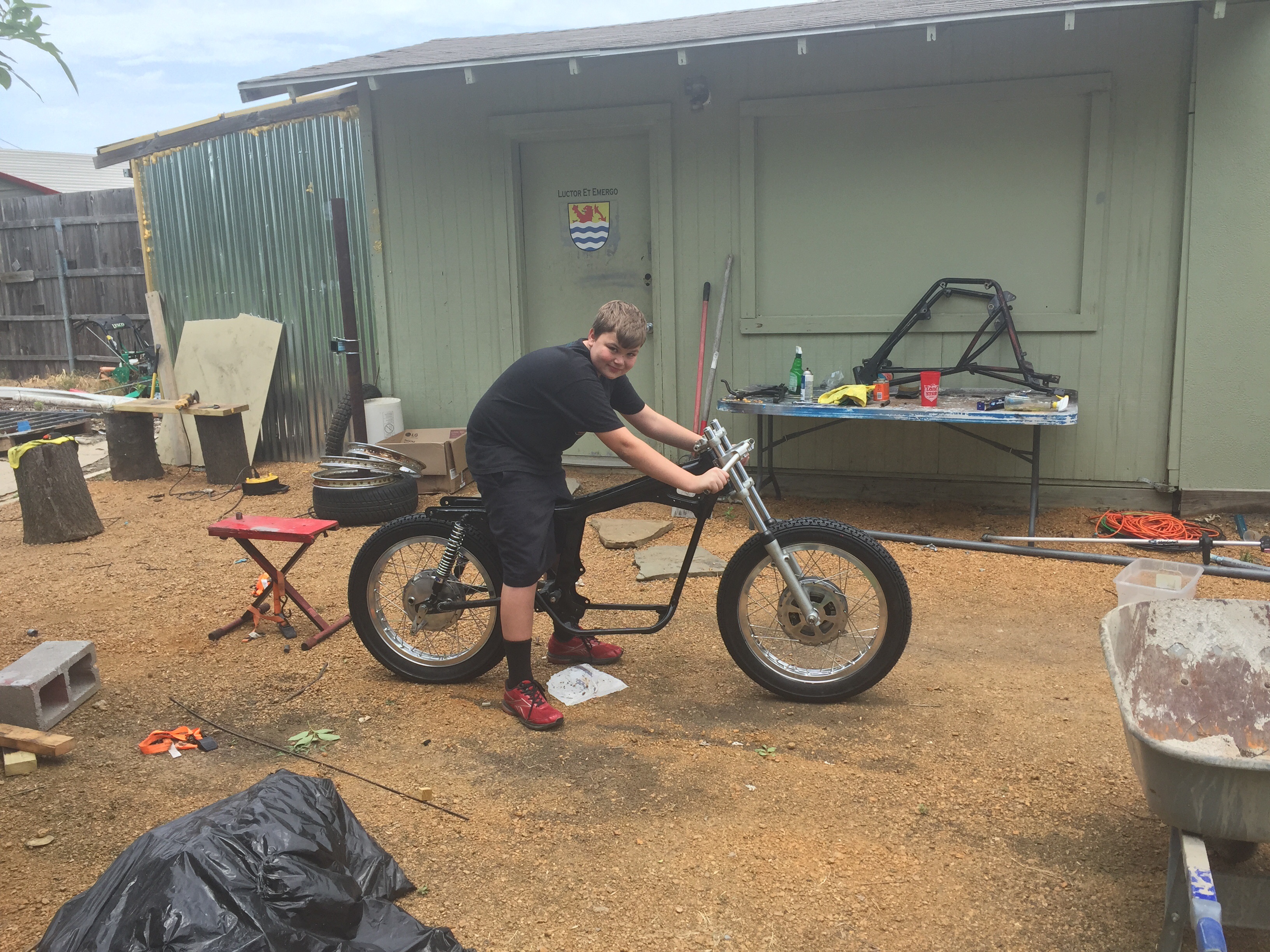

Re: Third Times a Charm CB175
Lowered the front end since this is going to be a cruiser we replaced the springs with pvc until we can get to a place to cut the fork tubes down

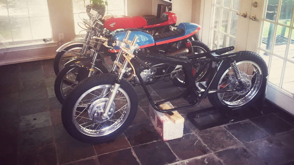

Family photo
Cb175 Victoria
Cb200 Lucky
Cb175 ?
