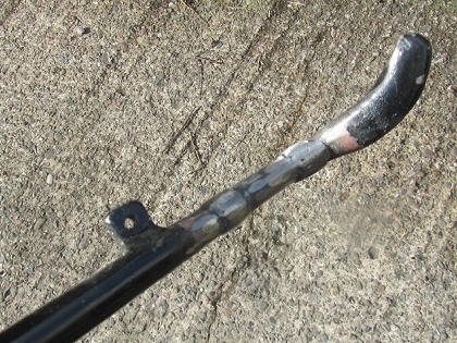

More work done on the frame, first extend the side stand by a couple of inches, as it was way too short before. Guzzis have a few different side stand lengths, I suspect mine must have been the wrong one for the bike.
Next a stainless splash plate was made from 1.5mm plate, which is thicker than I'd normally use, but I may end up bolting stuff to it, so wanted the extra strength.
Finally some of the flat spots I'd put into the frame tubes when grinding off the old brackets have been tidied up, they don't look quite so ugly now.

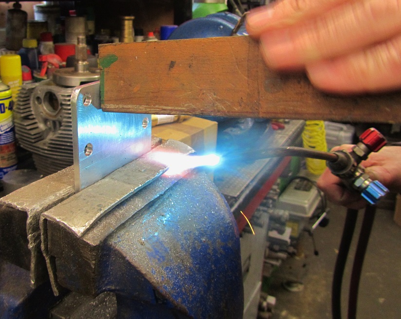

The speedo mount is being made from a scrap piece of 3mm alloy plate, fortunately its going to be shaped by Jeff on his miller when he has time, which will save me a lot of effort with a hacksaw and file. I've also opened my wallet for once and ordered some new shiny bits.. stainless engine mount bolts and stainless pins for the Brembo P8 calipers. Not strictly necessary, but the old rusty ones were annoying me.

While the frame is away, got a couple more jobs done. First (almost) finished the speedo bracket which will bolt to the top yoke, it needed a lot of heat to put a bend in it, cant just use force, as alloy tends to crack if your not careful. I'm also getting a billet cover machined for the speedo body, which should be ready next week.

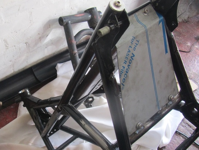

I'm just back from collecting the frame, looks so much better than the first attempt elsewhere. Unfortunately a big pallet arrived last week which is sitting in my garage taking up the last bit of room, so I cant do much assembly work on the Guzzi for now. That's ok, there's plenty of other jobs to do in the meantime.

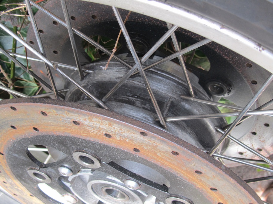

In the meantime, I decided the wheels weren't good enough, the anodised Akront rims were scuffed and scratched, while the hubs had been painted badly along with the rest of the bike by a previous owner. When I got the bike, I tried to remove as much paint as possible, the stainless spokes turned out ok, but it was impossible to clean up the hubs with the spokes in the way.
I'm not sure yet whether the original rims can be restored to a good enough finish to be re-used, if not I'll get new Morad rims. Expensive but worth it. While ideally I wanted to also reuse the stainless spokes, as they looked to be in good condition.

Early this morning I took the wheels to my LBS, who removed the tyres for me, then it was off to my mates workshop to dismantle the wheels, shouldn't take long, just need to unscrew 80 spoke nipples. How wrong could I be ! The first few spokes snapped inside the nipple as I tried to unscrew them. Not good, and a surprise given that the spokes were stainless.
There was nothing more that could be done, but to cut the spokes, as they were beyond saving anyway. At least that didn't take long, five minutes with the bolt cutters and the hubs were free. But my wheel troubles weren't over yet. The spokes were seized solid into the hubs, they didn't want to come out, even applying a blowtorch didn't make any difference. Instead I spend 4 hours
hammering each spoke out of the hubs. What a pita, if I hit the spoke hard enough to move it, it would bend the spoke like a cheap nail. Don't hit it hard enough and its going nowhere.
Eventually, they were all out, and with the old wheel bearings removed, the hubs, rims and disc carriers are ready for the blasting cabinet next week.
