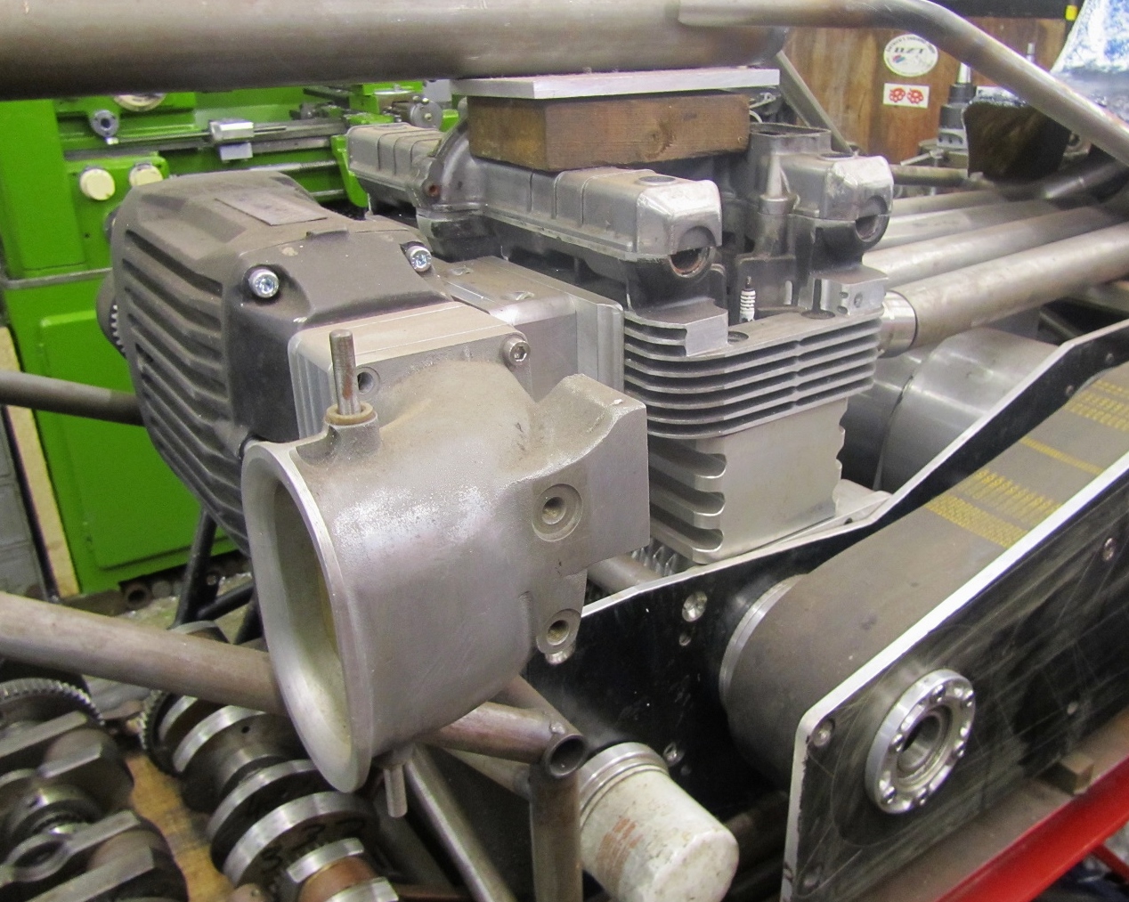

That one will be run on Methanol, should make about 250 ish BHP, so it wont be that quick, but should be fun. The main project bike is a lot more involved, it will be run on Nitro and will make 800 to 1000 bhp depending on how much nitro is used before the engine grenades.. that's if it ever gets finished..
