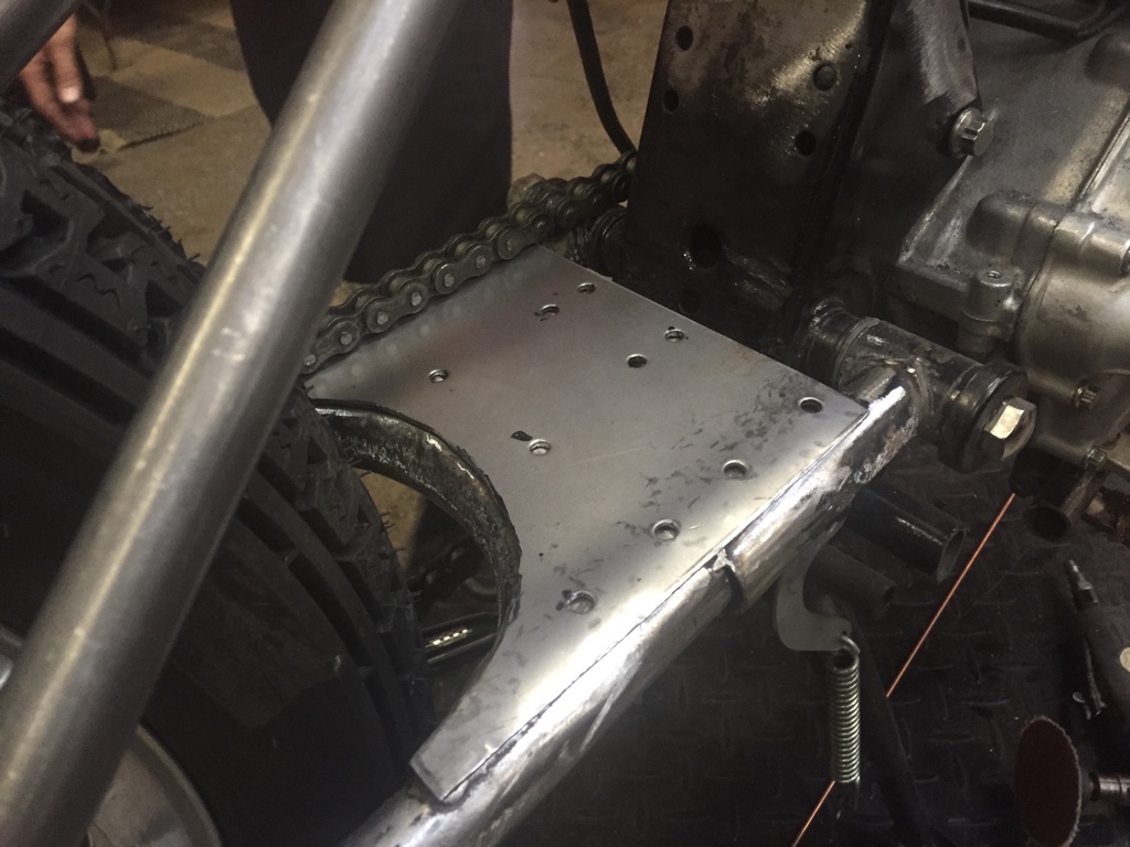

Zeke started shearing pieces so we could box the frame and I was assigned grinding
Re: Third Times a Charm CB175
Tuesday 6 pm Bryan and Zeke finished bending and tacking the rear swing arm meanwhile I was making a gusset plates for the top and bottom of the swing arm and reinforcing the rear of the center frame
